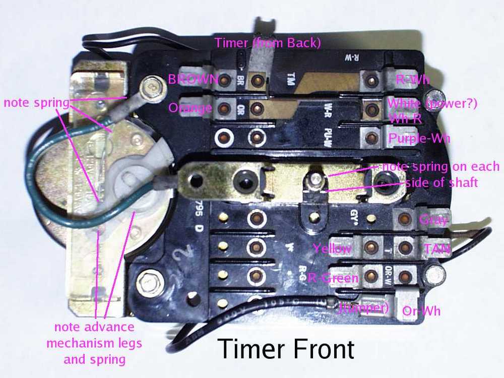

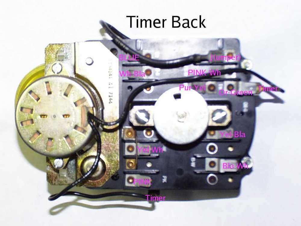

Post# 220971 , Reply# 1   7/5/2007 at 21:22 (6,111 days old) by goprog ()   |   | |

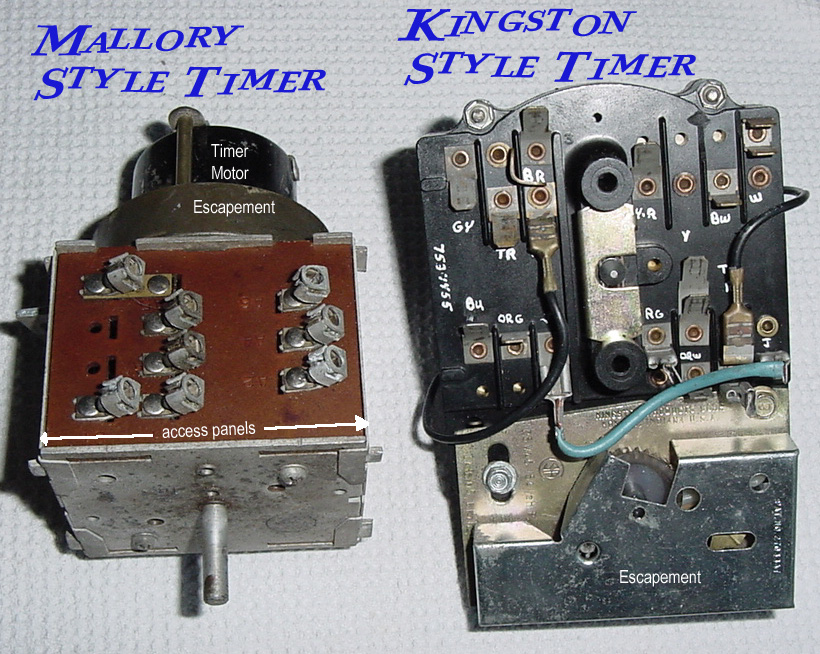

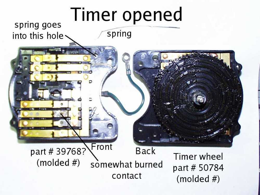

Picture turned out to be out-of-focus which I did not realize until reassembled so labeled the terminals (and then labeled them on the Front picture too to be consistent) 2 - Back |

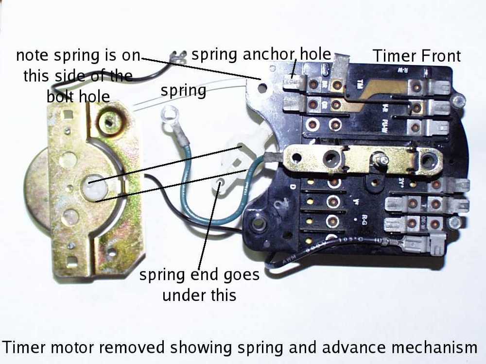

Post# 220972 , Reply# 2   7/5/2007 at 21:24 (6,111 days old) by goprog ()   |   | |
3 - Timer motor removed from timer control |

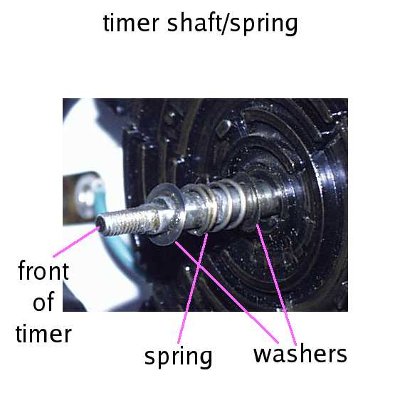

Post# 220976 , Reply# 5   7/5/2007 at 21:37 (6,111 days old) by goprog ()   |   | |
Picture showing the 2 (two) washers and spring location on the timer shaft, just in case someone should wonder. 6 - Timer Shaft washers and spring |

Hey Goprog, thank you for the very cool and detailed information. We love that kind of stuff around here. Over the past few years I’ve begun restoring all of my own timers, before that I would just send them out to Midwest Timer Service, but their work has become very “spotty” as of late and over 50% of the timers I’ve received back from them have an issue of sorts. I believe there is a someone down in Florida who does timer work and seems to do a good job. But these old timers are becoming more rare and charging $$$ for simple timer work so it is VERY important for us to learn how to work on our own timers now. The two major two types of mechanical timers used in vintage automatic washers are made by Mallory and Kingston. GE also produced all of the own timers, and they are very simple to work on, as they were made to be repaired in the field. The nice thing about Mallory timers is if the contact just needs to be sanded, they have two access panels that come off so you can reach most of the contacts without having to take them apart. By the way I see you are in MN, YAY another member in the Minnesotan contingent. Are you here in the metro? |

To do this requires removing/drilling out the old contact rod and riveting in the new one? |
