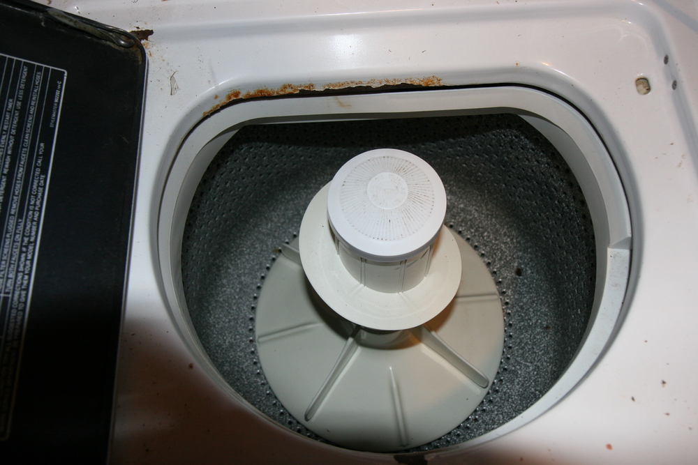

I just love it when you share your vast and expansive Kenmore knowldege. It's fascinating. As far as the standard cap DA's are concerned, I got one!!! |

I'm blushing Jed, but THANKS! You not only have a standard capacity DA there, but I'm guessing it's in a 24-inch machine, am I right? Those tubs are a tad smaller than a standard tub, so the DA must be a monster in it. The easiest way to discern a standard DA from a big-tub version is to look at the top of the auger. It tapers out from the top on the standard tub, whereas in the more common big-tub, it protrudes out immediately. With the agitator shaft so high out of the basket in a standard machine, I'm wondering how much of the auger is actually underwater in a full tub, since I've never seen one of these in action. Is that the machine you posted about earlier in the late spring or so? I have wondered what became of it and the Hotpoint/GE after you got into the cool heavy iron after that. G |
