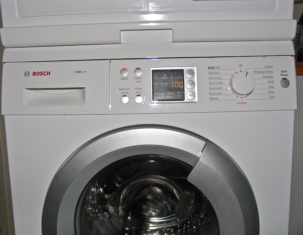

Well, I think this machine might have the AquaStop feature built into it. With that in mind, if you are seeing water on the floor, I would imagine that the AquaStop Sensor is aware of it as well and could be preventing the machine from starting. So, I would first investigate the source of the water. You reported that after shutting of the water at the faucet, it stopped on the floor. Perhaps you have a hose leak in the back of the machine. Of course a leak on the outside of the cabinet probably isn't gonna trip the AquaStop sensor.
In any case, solve your water leak problem and the other issue may clear up as well.
