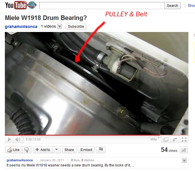

Post# 491655 , Reply# 1   1/26/2011 at 13:43 (4,809 days old) by grahamW ()   |   | |
I've uploaded a video that shows the issue with my washer. CLICK HERE TO GO TO grahamW's LINK |

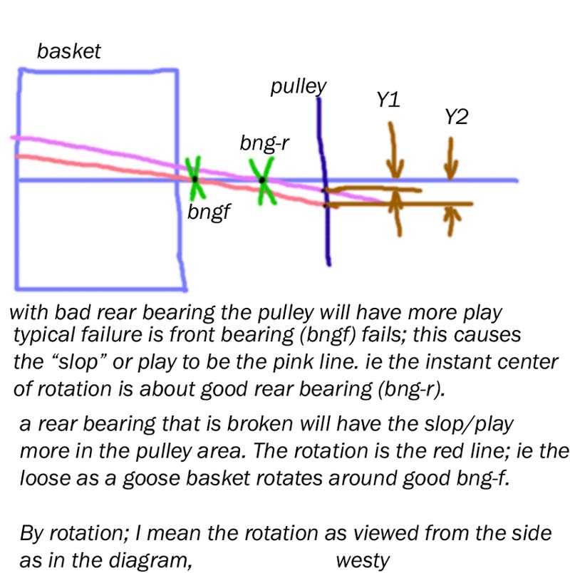

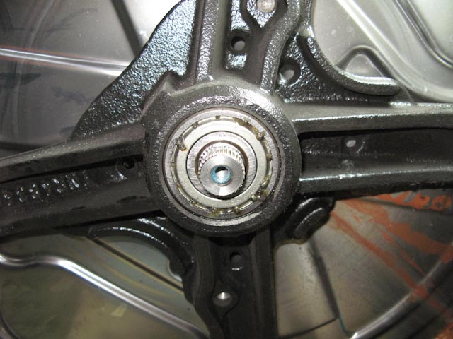

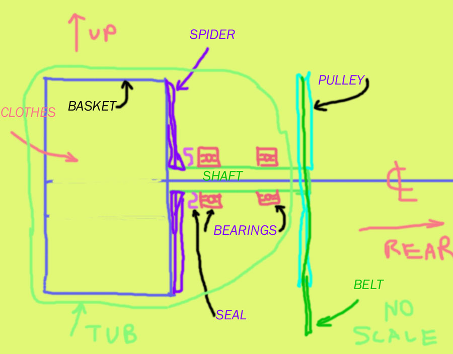

Post# 491884 , Reply# 10   1/27/2011 at 13:57 (4,808 days old) by 3beltwesty ()   |   | |
Hope this makes it clear |
Post# 491886 , Reply# 11   1/27/2011 at 14:00 (4,808 days old) by 3beltwesty ()   |   | |
If one grabs the basket and moves it up and down; the point it rotates in space is the good remaining bearing. |

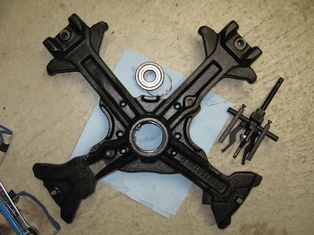

Post# 496083 , Reply# 25   2/12/2011 at 22:06 (4,792 days old) by grahamW ()   |   | |
My previous msg didn't make any sense... In retrospect, I think a gear puller on the cast spider with a little heat should get the spider+bearings free of the shaft. |

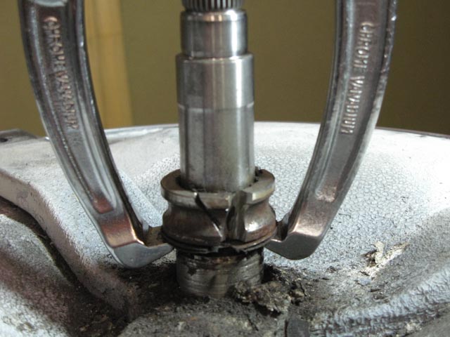

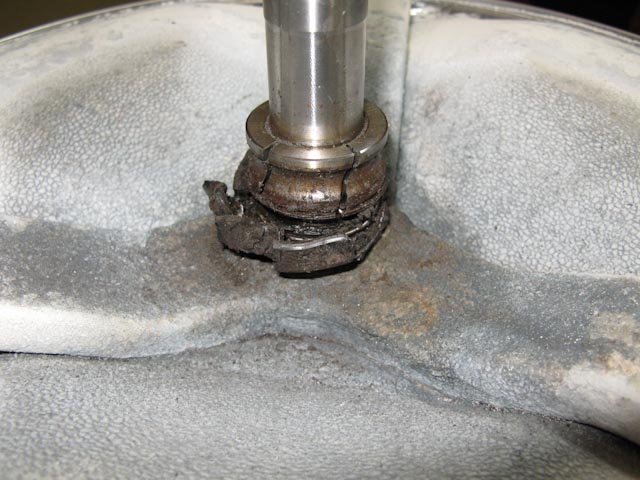

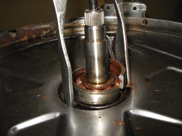

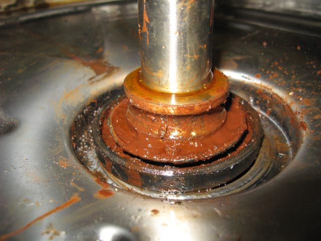

Post# 497256 , Reply# 32   2/17/2011 at 21:13 (4,787 days old) by grahamW ()   |   | |
The inner bearing, however, is proving more difficult. And, yes, that is a piece of the outer race... |

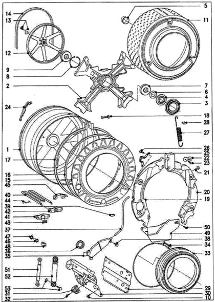

Post# 497267 , Reply# 34   2/17/2011 at 22:32 (4,787 days old) by Pingmeep ()   |   | |
After looking for similar problems with the W1918 I came across this thread on gardenweb. Sounds similar to your problem. CLICK HERE TO GO TO Pingmeep's LINK |

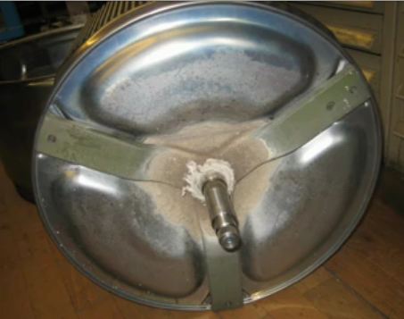

Post# 497416 , Reply# 39   2/18/2011 at 13:13 (4,786 days old) by 3beltwesty ()   |   | |

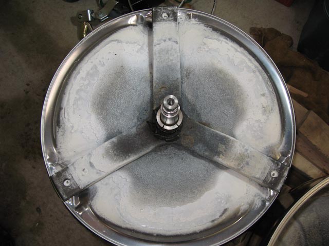

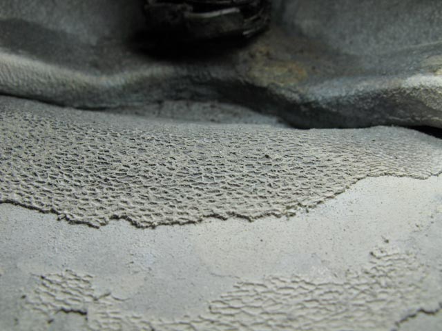

What is the white stuff that that is one the lower image's drum spider by the shaft? Can you post a higher res image of spider? I want to see if if is a casting or forging, or machined. |

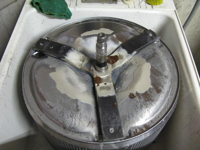

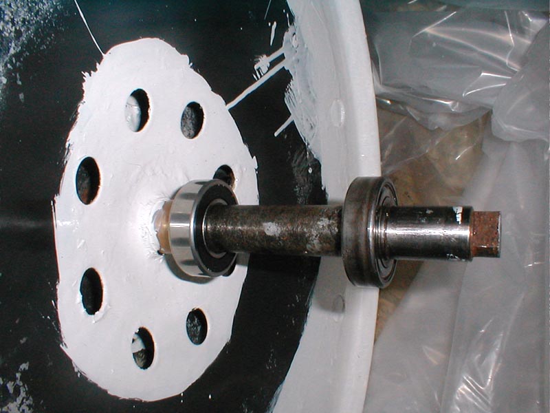

Post# 497759 , Reply# 47   2/19/2011 at 19:15 (4,785 days old) by grahamW ()   |   | |
Here's the bearing which shows the swiss-cheese groove I needed to make. A few light hammer taps with a punch and it was free. |
Post# 497760 , Reply# 48   2/19/2011 at 19:17 (4,785 days old) by grahamW ()   |   | |

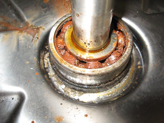

I'll clean up the inner drum and post a few better photos of the spider but here's what it looked like when I pulled it. |
Post# 497761 , Reply# 49   2/19/2011 at 19:18 (4,785 days old) by grahamW ()   |   | |
A close-up of the scaly, white residue: |

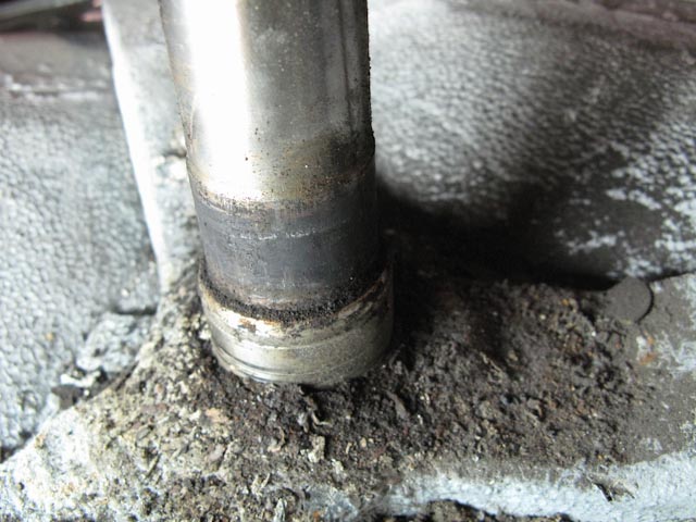

Post# 497763 , Reply# 50   2/19/2011 at 19:23 (4,785 days old) by grahamW ()   |   | |
Here's a final photo showing the shaft where the troubled, inner bearing was: |

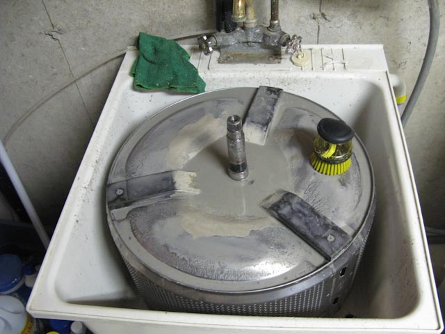

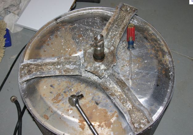

Post# 498050 , Reply# 60   2/20/2011 at 20:20 (4,784 days old) by grahamW ()   |   | |
A laundry tub, in a laundry tub... |

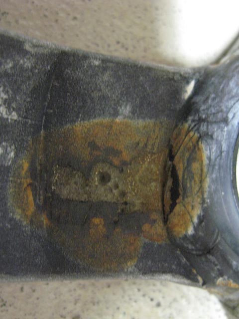

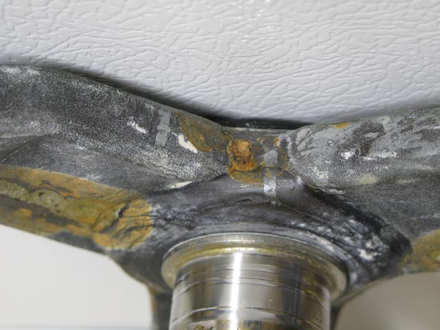

Post# 498051 , Reply# 61   2/20/2011 at 20:22 (4,784 days old) by grahamW ()   |   | |
After the first pass... the rust appears. |

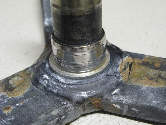

Post# 498052 , Reply# 62   2/20/2011 at 20:23 (4,784 days old) by grahamW ()   |   | |

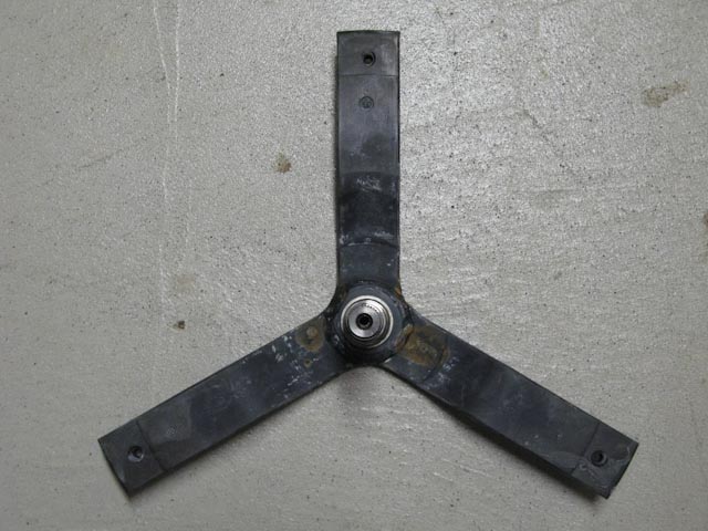

I decided at this point, to remove the spider (3 bolts running the length of the drum, inside the paddles). After some more scrubbing: |

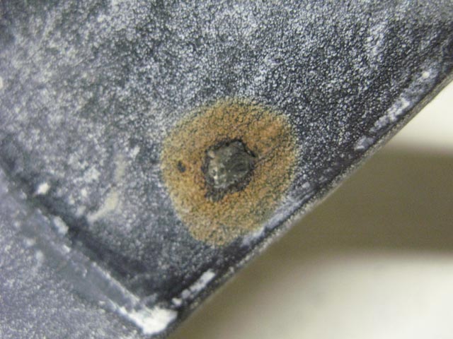

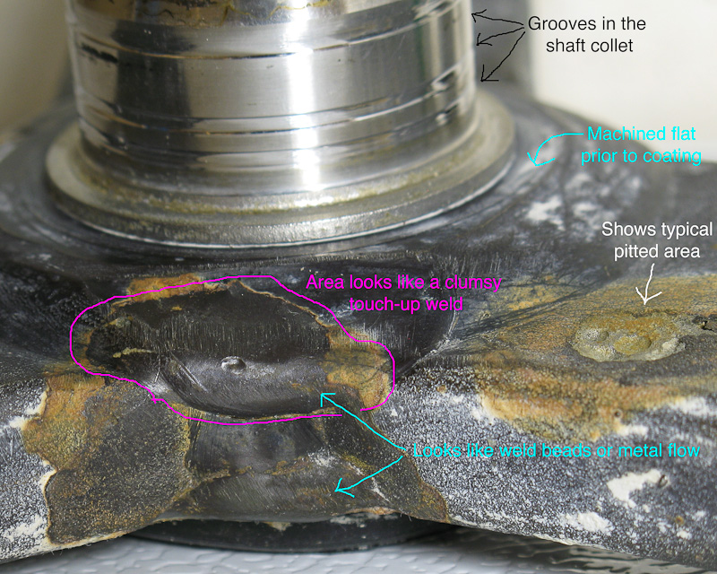

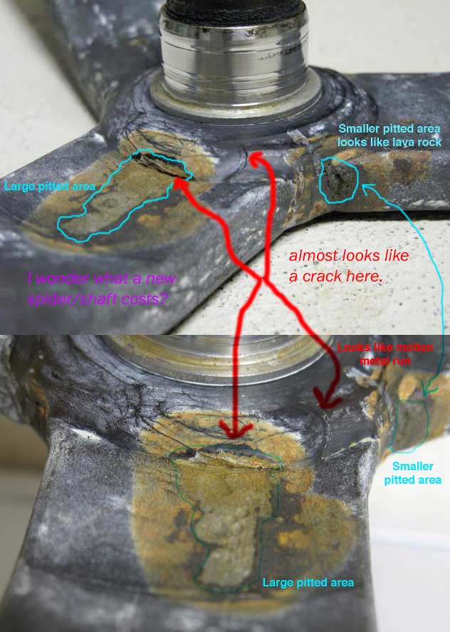

Post# 498054 , Reply# 63   2/20/2011 at 20:26 (4,784 days old) by grahamW ()   |   | |
A few close-ups of the rust spots: This photo also shows the bottom of the shaft where the seal would sit. At the top of the photo, you can see a bit of corrosion where the inner drum bearing was. |
Post# 498056 , Reply# 64   2/20/2011 at 20:27 (4,784 days old) by grahamW ()   |   | |
Top view of the large rust spot, shown on the left above: |
Post# 498059 , Reply# 66   2/20/2011 at 20:33 (4,784 days old) by grahamW ()   |   | |
The back-side of the spider has only a little rust. |

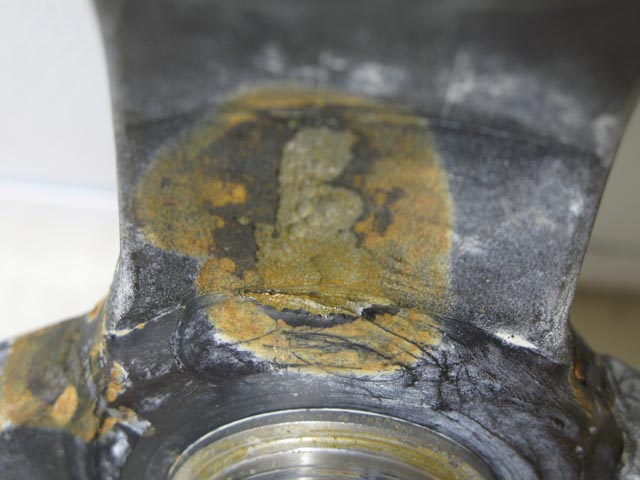

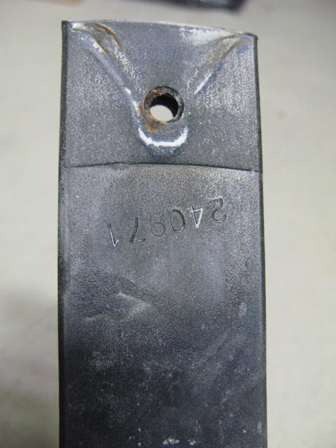

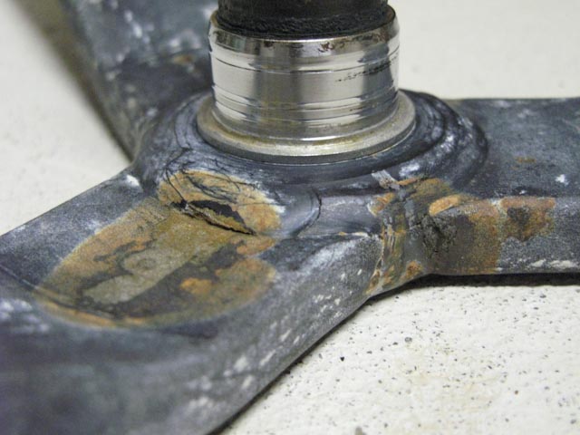

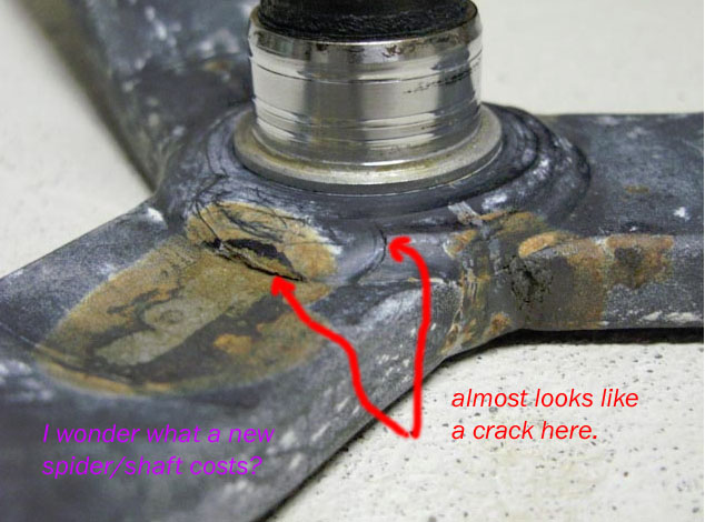

Post# 498094 , Reply# 73   2/20/2011 at 21:38 (4,784 days old) by grahamW ()   |   | |
3beltwesty, here's another photo of that area. It doesn't look like a crack in person. In person, it looks like an imperfect weld bead going all around the top/bottom edge of the spider. |
Post# 498097 , Reply# 74   2/20/2011 at 21:39 (4,784 days old) by grahamW ()   |   | |
Another of the spider. |
Post# 498106 , Reply# 75   2/20/2011 at 22:06 (4,784 days old) by cfz2882 (Belle Fourche,SD)   |   | |
nice spider!-no corrosion problems there,almost looks like forged steel the way the shaft is welded on.Could be "cast"steel also.Looks like the seal sleeve is replacable too,real quality. |

Post# 498363 , Reply# 84   2/21/2011 at 18:59 (4,783 days old) by cfz2882 (Belle Fourche,SD)   |   | |
spider looks to be in very good condition from what i can see-i'd replace the seal sleeve and run it-looks like a real quality machine well worth the repair effort. |

Post# 498672 , Reply# 93   2/23/2011 at 01:34 (4,782 days old) by sudsmaster (SF Bay Area, California)   |   | |
That scale is most likely limestone - the product of washing soda (sodium carbonate) combining with calcium and/or magnesium in the tap water AND in the dirt in the soil on the laundry and forming an insoluble precipitate.
One way to help prevent this sort of thing is to use a good non-precipitating water softener, such as STPP, with every load. As for the spider - I'm wondering if it's cast magnetic stainless steel. That sort of alloy can be corroded, a bit, but nowhere near as quickly as a regular steel would get corroded. When my Neptune had its three year mark rebuild, I got to see the spider. It's aluminum and rather beefy, but it had turned jet black with all the hot water loads, perhaps also due to the phosphates in the mix. The original spider had cracked (probably a mfg defect). It's been running fine with phosphates on the replacement spider for the past seven years. As for pulling the bearing... I would suggest using a three-jaw puller next time (Pep Boys has a good one for about $50). Less chance of the bearing cocking and making the removal more difficult than it need be. And of course I'm sure you must have used a penetrant like PB Blast, which is great for freeing corroded fasteners etc. |

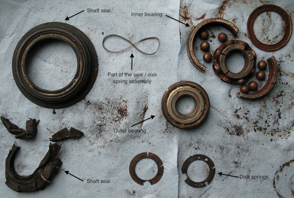

Post# 502983 , Reply# 115   3/10/2011 at 11:26 (4,766 days old) by combo52 (50 Year Repair Tech Beltsville,Md)   |   | |
2
This has been an interesting disassembly and tear down. This problem was caused by a failure to use enough detergent for water conditions which caused the heavy mineral buildup which caused fast seal ware and resulted in bearing failure when water got past the seals. I have seen this hundreds of times. The solution is not so much periodic washer cleaning as just doing laundry properly in the first place. If you pay attention to what is going on in your washer or dishwasher it should never be necessary to run cleaners through them. Doing laundry improperly and then trying to clean up the mess periodically would be like not changing your cars oil for 50,000 miles at a time and trying to flush out the mess afterwards, the damage is already done its largely too late. |

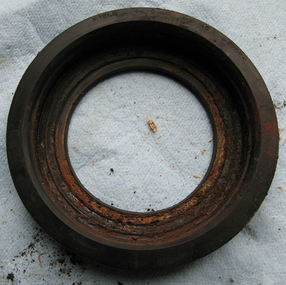

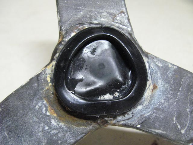

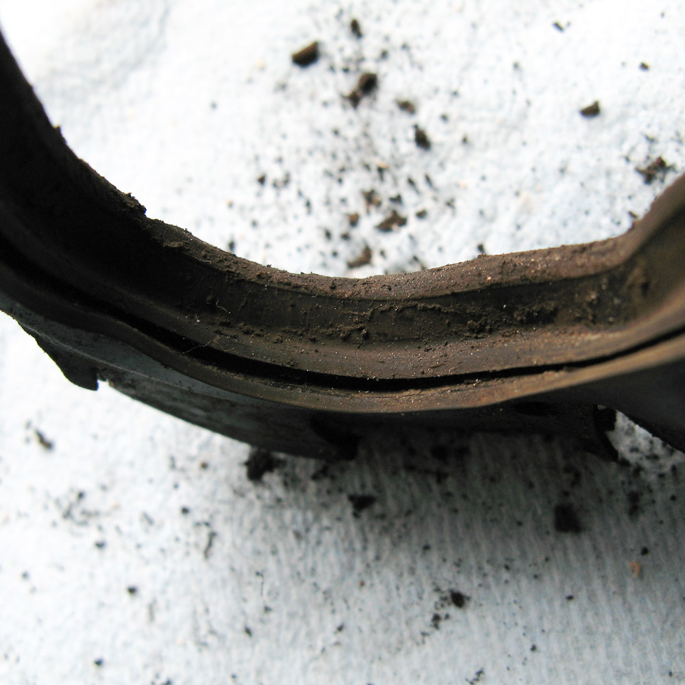

Post# 504512 , Reply# 120   3/16/2011 at 12:16 (4,760 days old) by grahamW ()   |   | |
As requested via e-mail, here are some better photos of the seals. |
Post# 504514 , Reply# 121   3/16/2011 at 12:18 (4,760 days old) by grahamW ()   |   | |
The inside of the large shaft seal which actually sits on the cast cradle. No metal in this one. |
Post# 504516 , Reply# 122   3/16/2011 at 12:21 (4,760 days old) by grahamW ()   |   | |
The shaft seal that I needed to cut away to get a better grip on the inner bearing. This one does have metal in it. You can see the two lips of the seal but there is also a ridge at the edge that doesn't photograph very well. |
