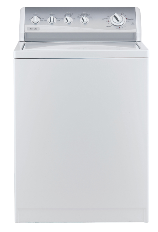

So far the only model of top loading, vertical axis machine I've seen sold in Europe is this Maytag washer. Whirlpool used to carry a laundry pair but don't anymore, instead they have a top loading horizontal axis machine now.
Searching around the net you can see the specs for it:
At 8,2 kg of capacity the machine is rated
"G" for energy use (it means more than 0,4kWh of energy per kg of laundry)
"D" for spinning efficiency (more than 70% of residual moisture)
"G" for washing ability
168 litres of water for a standard load.
Compared to any horizontal axis machine you can lower the water consumption of more than 100 litres for the same load and the energy/washing/spinning class would be A+/A/A.
Now I don't know if it is a HE version or traditional version of top-loading machine but given the price, the outrageous water and energy consumption and poor washing and spinning results, I'm sure they're going to discontinue it soon here in Europe as it costs twice than a standard front loader of the same capacity!
CLICK HERE TO GO TO dj-gabriele's LINK
