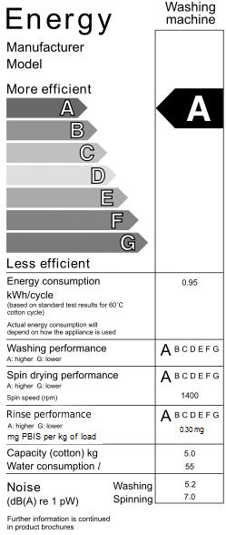

I wish someone would include rinse-ability into the tests. Items maybe clean but I really don't want to wear them if they are poorly rinsed. |
Post# 498169 , Reply# 7   2/21/2011 at 08:11 (4,784 days old) by dj-gabriele ()   |   | |
That's just the standard European energy label plus a rinsing efficiency indicator. That would be a nice idea! |

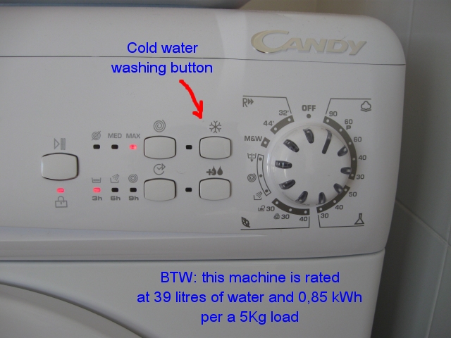

I did a factual cost analysis (again), I hope that's going to help not to open that "can of worms" ;) |

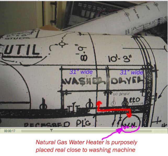

Dryers do not have DOE labels on them and I agree with you that electric water heaters should not be used if natural gas is available, but it is just as stupid if not more so to use an electric clothes dryer if gas is available. Gas dryers are 3-4 times more efficient in terms of how much fuel must be burned to produce the amount of electricity used by an electric dryer. If one must have an electric water heater one should look into a heat-pump model, I just purchased one for my partner this past Xmas. |
