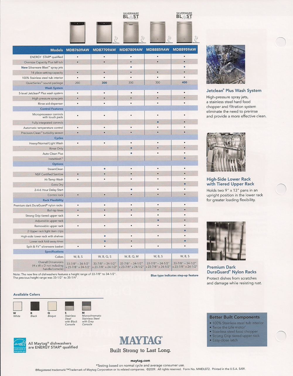

Post# 499372 , Reply# 1   2/26/2011 at 07:44 (4,807 days old) by cyclemonitor ()
next
