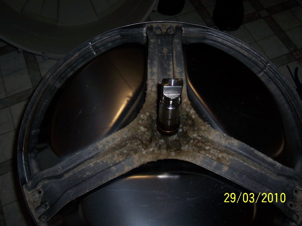

Post# 499969 , Reply# 21   2/27/2011 at 23:41 (4,804 days old) by Spankomatic (Ukiah,CA)   |   | |
Photos from Thread http://www.automaticwasher.org/cgi-bin/TD/TD-VIEWTHREAD.cgi?31662
Mold smell. The photos is what many are up against,we just can't see it. We only smell it. Keeping the door open,using bleach,vinagar,cleaning tablets in a wash cycle as you can see is pointless. To truely get rid of it the machine has to be taken apart and scrubbed.

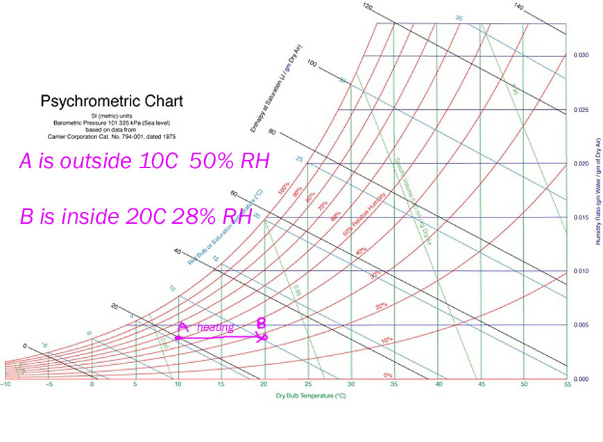

If you turn the heater so it is 25C then your RH drops to 20 percent |

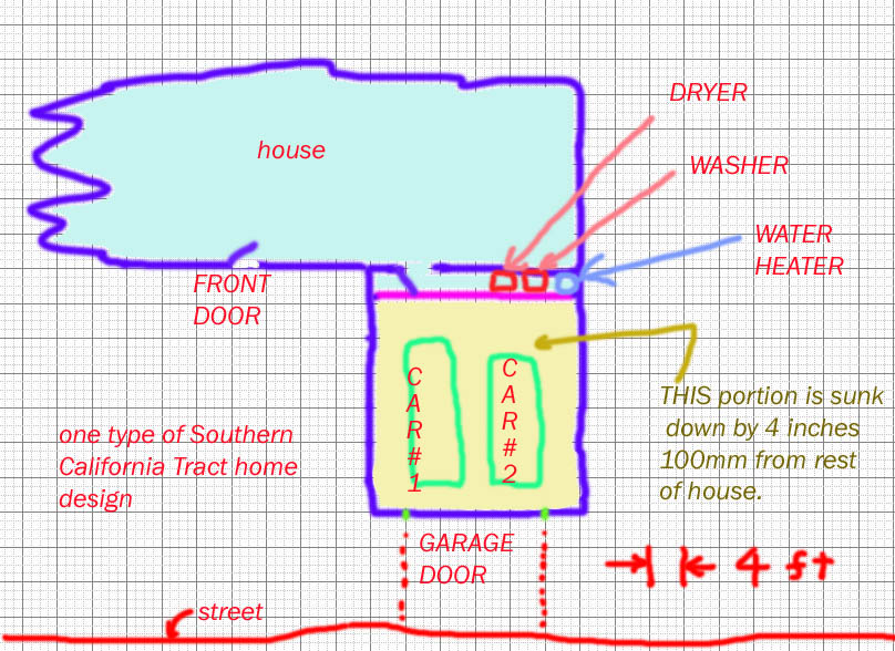

The set up you describe is very unusual here. If a house has a garage, most of the time there is a utility room as well. And a utility room would be heated. I can only speculate how they had things organised. I have never seen such tape overhere.
Have we established what kind of washer they had? Was it an H-axis twintub? They could have had an AEG Turnamat, very popular in the Netherlands. |
