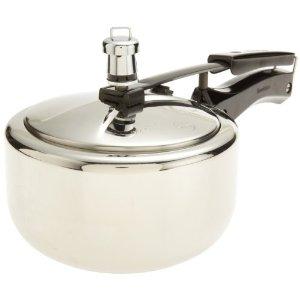

Post# 510210 , Reply# 12   4/8/2011 at 11:27 (4,760 days old) by whirlcool (Just North Of Houston, Texas)   |   | |
I really like Mirro pressure cookers, but they all tend to be made from aluminum. Presto makes them in stainless steel. But since we use these only a few times a year I wonder if it is even worth spending the money on a new one? The only thing we really make in the pressure cooker is spareribs and pot roast. |
Post# 510254 , Reply# 13   4/8/2011 at 14:39 (4,759 days old) by Launderess (Quiet Please, There´s a Lady on Stage)   |   | |
Before purchasing the Magefesa set did lots of research. IIRC the Presto SS models do not have a core sandwich base, rather simply the entire pot is made from SS. This has lead to some consumers complaining about things burning to the bottom.
The weight of my Magefesa pot and pan (set came with a stock type pot and a smaller "fry" pan, both use the same PC lid) has more heft than the aluminum "pressure fryer" I've got (aka "Chicken Bucket"). Check out Miss Vickie's website. The self proclaimed "Queen of Pressure Cooking" there lots of good information and comments there. Also Chow.com (or is it Chowhound.com?) is good as well. Once you get a really great PC you may find your range of dishes expanding. If you love corned beef brisket there simply is no better way to make one than in a PC. |
