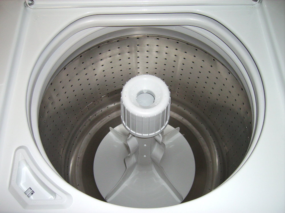

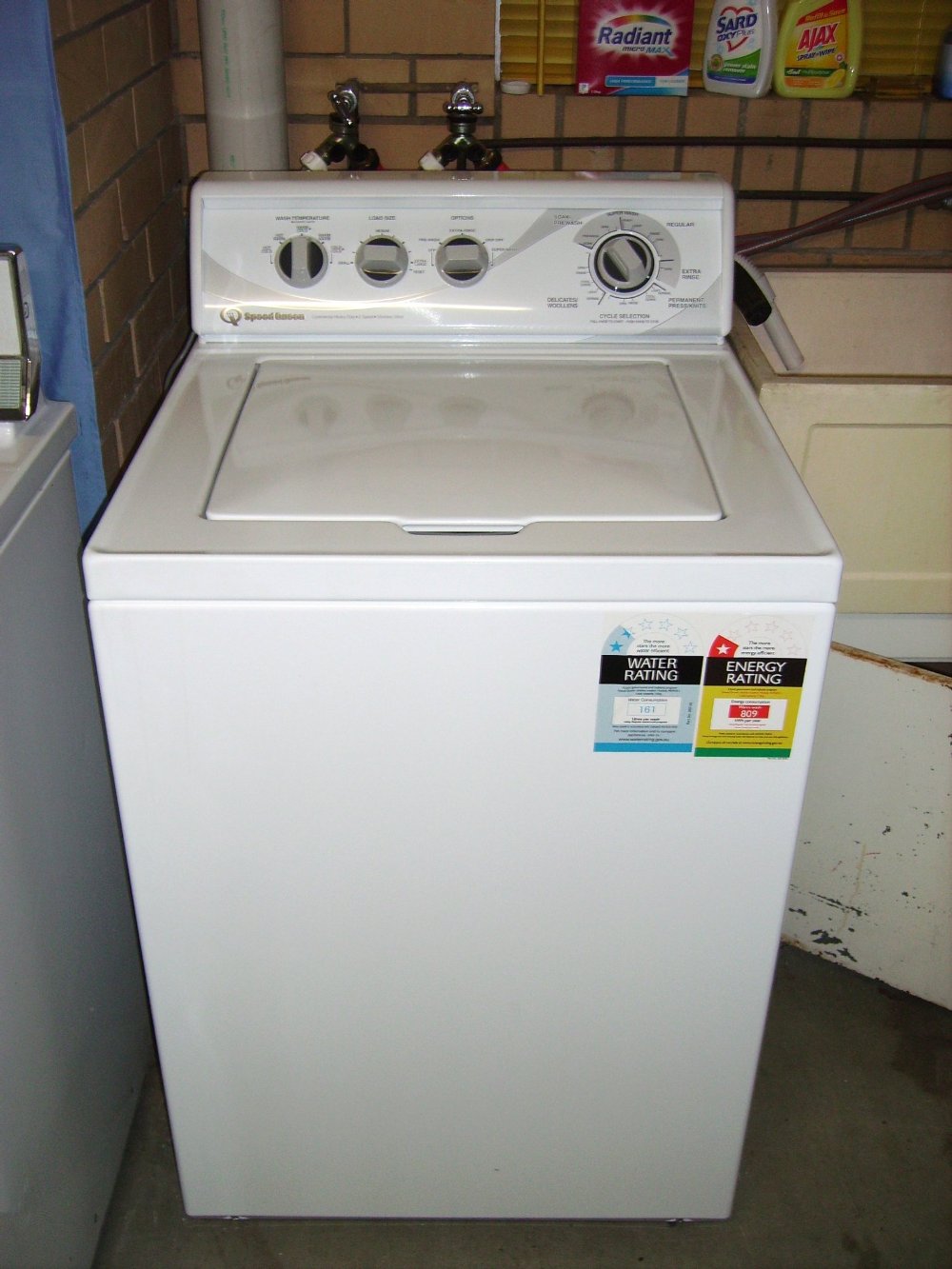

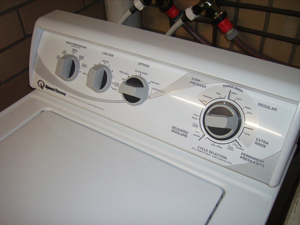

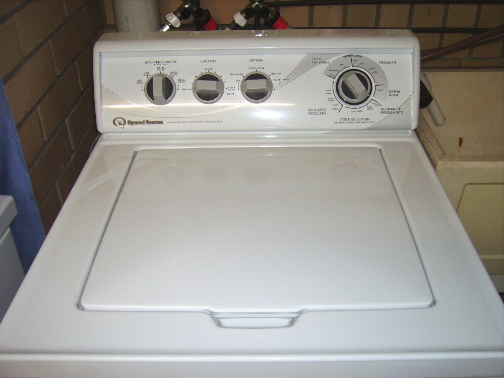

Hi guys,
Before anybody asks, Yes....I've named a machine! And why not? A 'majestic' name for a 'majestic' Speed QUEEN'! Lol I've been saving for this for the past few months: the Australian export version of the Speed Queen top loader: AWN552. You'll see a few differences in the video between the export version and the domestic version, but i'm not giving anything anyway. I'm VERY happy with the machine! The last machine on the Australian market with a metal gearbox and long stroke wash action, not that Maytag have disappeared from Oz. Some pics first... Cheers Leon |

Very Nice Machine. Great Video. Did you overload it on purpose to show what it could run with and not shut down? It seems terribly overloaded. Brent |

All I can say is WOW! I didnt expect to see a neutral drain and the spin picks up fast. Methinks that they did away with the idler on your machine since the spin cycle picks up so fast. Mine takes awhile to get up to speed. That spray rinse in the last spin gawd I wish I had in my machine. The first spray rinse in the first spin sprays way too early in my machine. That spray in the last spin you will appreciate. That will get rid of residue that I have issues with from time to time in mine.
But I will have to agree...your machine is overloaded. Unless you plan on raising the water level to the top of the vanes you really need to resist overloading the machine. Your clothes will thankyou. This washer will make alot of lint and if you hang your wash out it will be noticeable. Especially if its overloaded like that. If you use a dryer you will find the filter kinda fuller with lint. But I do love the fact that you have the option to use a warm rinse if you want. And your cycle selector...love that! Nice machine! Now I wish we had there here in the states...even though we build it here...they wont sell it I think here. |
