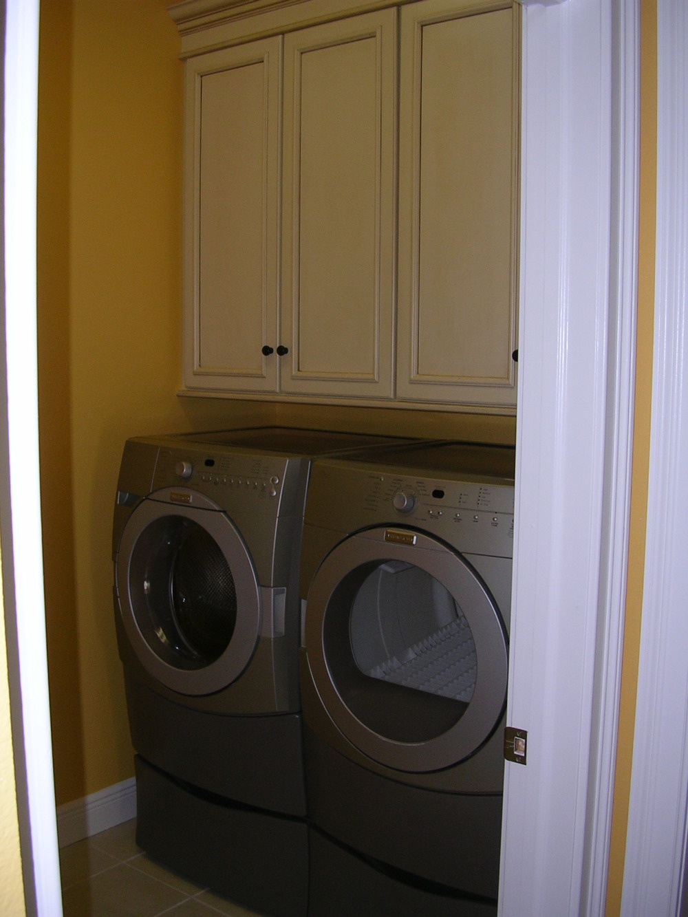

Would I need to do anything special to move these machines? A distance of about 20 miles in a open bed pick up. Thanks for your input! |

Well, just put back the transit bolts, otherwise just lay the machines on the side and you're done! Avoid any bumps on the street ;) |

Post# 512784 , Reply# 3   4/21/2011 at 07:22 (4,751 days old) by combo52 (50 Year Repair Tech Beltsville,Md)   |   | |
If you have them reinstall the shipping bolts otherwise keep the washer upright. I have said that it is OK to lay TL washers on thier sides but a FLer should never be laid on its side unless all the factory shipping braces are installed. When driving with the FL washer upright in the truck with no shipping bolts it is a good not to go flying over speed bumps but normal little bumps won't hurt a thing. Do strap the washer down as they like to tip. The dryer doesn't need any special cautions, just treat it as if it was a good piece of furniture, laying it on its side is fine if you want. |

I've transported a number of Miele washers in the back of my pickup with no operational issues afterward. Never have seen a shipping bolt for one.
I ease them up a ramp into the truck, and then position them upright against the far side of the bed (against the cab). The ride will be gentlest there, as opposed to hanging off the tailgate. Of course I avoid bumps and drive as gently as possible.
I've heard about the blanket trick and I think extra bed pillows (if you got them) would also work.
These machines are sturdier than one might thing. But of course if you hear clanging you're doing something wrong. |

Putting blankets or pillows in the tub will do no good what so ever and may even make it more lilkly that damage will occour if you end up adding any weight to the tub. How if you take the top off the machine and the lower front panel and pack stuff on the outside of the tub this could help.
