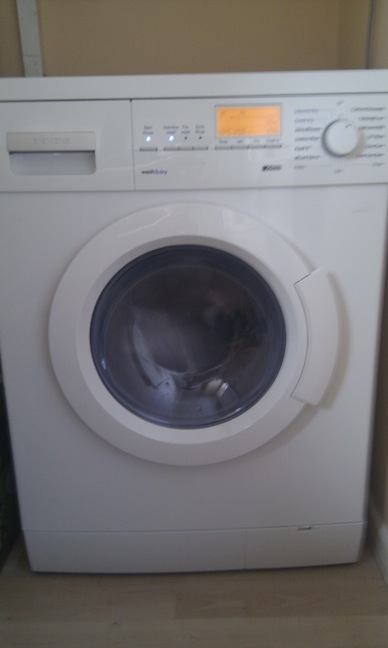

Hello,
I've finially got around to taking a few pics of our Siemens Washer Dryer that replaced the Hoover:

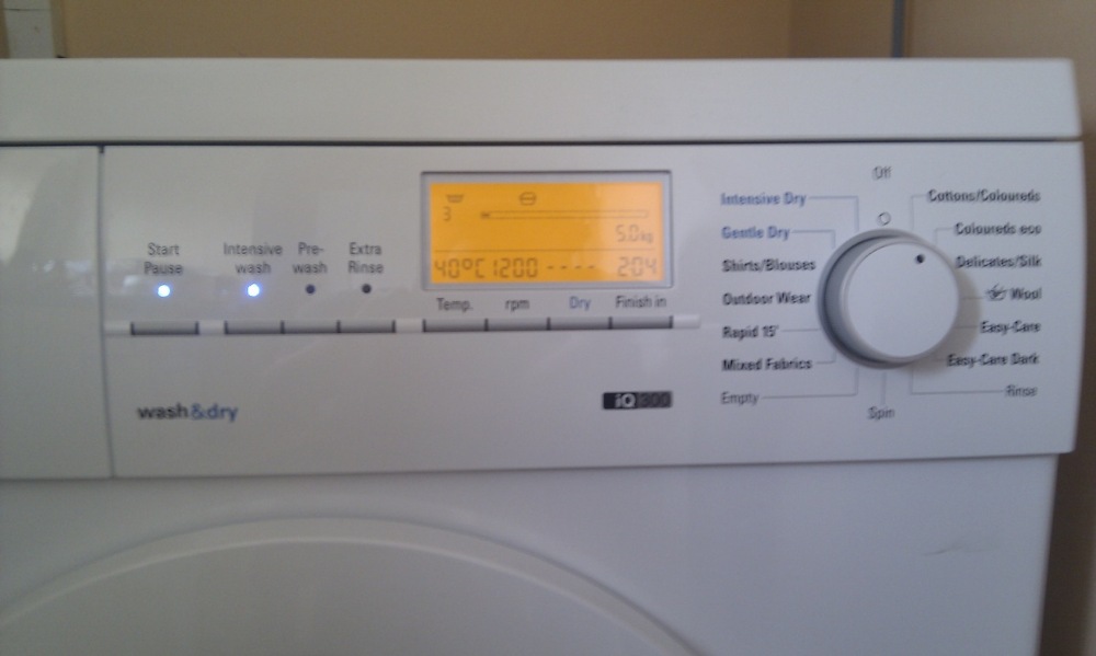

Post# 518044 , Reply# 1   5/15/2011 at 16:42 (4,719 days old) by solsburian (SE Northumberland)
Here is a pic of the facia, I was washing some Bathmats on the standard cotton programme with Intensive Wash selected. The display shows the number of rinses at the top left of the display, progress bar in the middle, with the wash symbol displayed above, and the recommended load size displayed to the right.

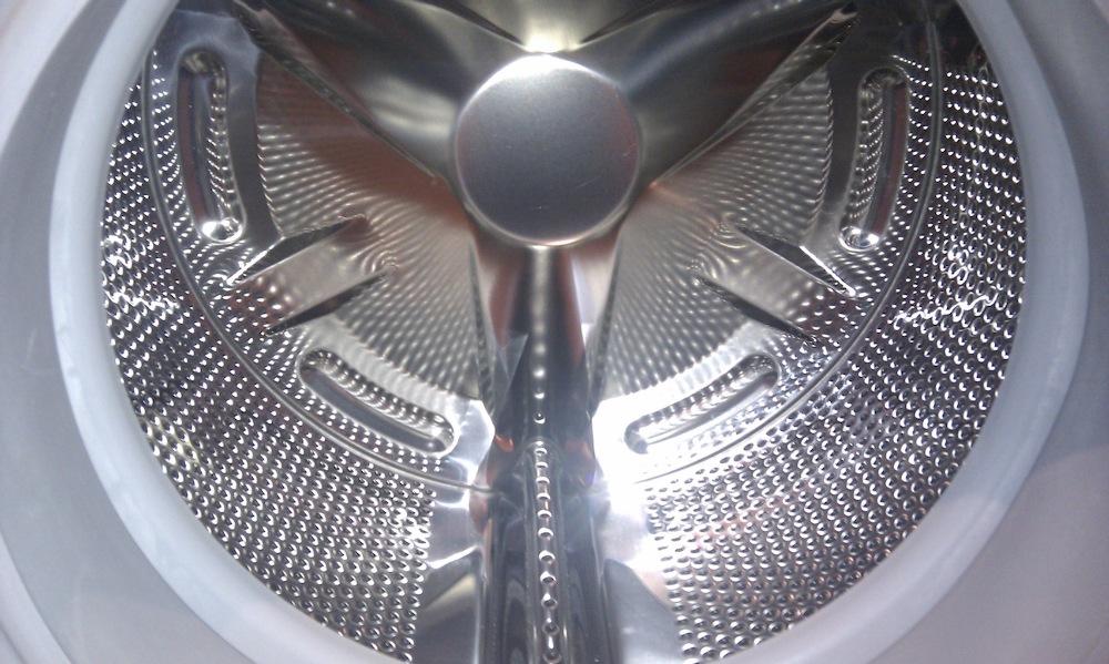

Post# 518045 , Reply# 2   5/15/2011 at 16:45 (4,719 days old) by solsburian (SE Northumberland)
Last pic of the drum, with metal paddles. The outer drum is also stainless steel.
Post# 518050 , Reply# 3   5/15/2011 at 17:05 (4,719 days old) by aegokocarat (United Kingdom)
the drum looks like the type beko used in thyer erler modles. i like how it looks, it dosent looks plasticy or commen like the old un-faithful hoover.
are the buttons touch sensitive?
Tom =)

Post# 518059 , Reply# 5   5/15/2011 at 17:18 (4,719 days old) by solsburian (SE Northumberland)
Hi Tom,
I should of added the touch buttons to the bad list.
The ones under the display can have a mid of their own, and not register a touch or cycle through the options as if you have pressed them multiple times! The touch controls were a bad point made by Which was well. Apparently other Siemens machines do this as well. The other ones are ok.
Post# 518064 , Reply# 6   5/15/2011 at 17:35 (4,719 days old) by aegokocarat (United Kingdom)
ahhh, the touch buttons on bosch models of washers and dryers are like this too, they apparently freeze if touched one time to many! cant wait untill i get my siemens dryer in august! is your washer dryer made in spain?
Tom =p
Post# 518169 , Reply# 7   5/16/2011 at 01:20 (4,719 days old) by dj-gabriele ()
Oh, I really like the fact that it has metal paddles, a rarity nowadays! Too bad for the water consumption while drying!

Post# 522049 , Reply# 10   6/2/2011 at 17:08 (4,701 days old) by ariston4life ((Dublin) Ireland)
ariston4life's profile picture
ive also seen that drum on Beko, electrolux, zanussi, tricity bendix and bosch machines... some indesit machines have a drum similar to it aswel
Post# 526274 , Reply# 11   6/22/2011 at 15:23 (4,681 days old) by aegokocarat (United Kingdom)
the drum used in indesit machines was an older style whirlpool drum, this one is beko esque
Post# 526287 , Reply# 12   6/22/2011 at 16:55 (4,681 days old) by ultimafan ()
The Siemens washer dryer is similar to washer dryers produced by Bosch, Neff, Smeg and Whirlpool, they have all had the same drum, and the newer models also share a redesigned drum too.
Apart from Miele, this seems to be the only washer dryer I believe would last for a while...
Post# 526306 , Reply# 13   6/22/2011 at 18:03 (4,681 days old) by solsburian (SE Northumberland)
ultimafan...
I hope so! Mind you it's had to have a new worktop to replace the original loose/rattling one.
Apart from that it seems to be well built.
The drum also looks very similar to supremewhirlpol's Ariston washer dryer.
Post# 767277 , Reply# 14   7/1/2014 at 15:24 (3,576 days old) by BEHZAD (Home Appliances Lab)
the interior of drum is as same as FAGOR,i guess.
i heard about the BOSCH-SIEMENS top loade washers which made by FAGOR,but not about front loaders yet.
look at the two metal sausage-shape marks on each corners of back circle(3*2=6).you can find it at FAGORs too
but I still don't know it's a FAGOR made washing machine or just drum designs are similar together?
