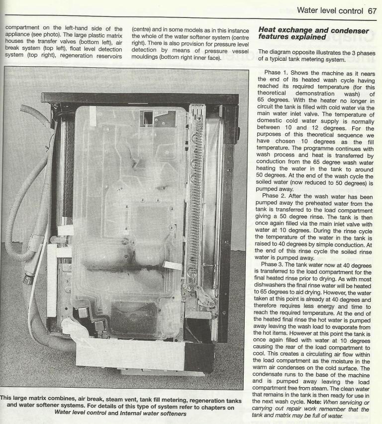

i think it channels water into the different sections of the dishwasher. the dishwashers in my school are beko's from 2006-8 i likw them! Tom =P |
Post# 519445 , Reply# 2   5/21/2011 at 01:54 (4,722 days old) by Docker (Cape Town, South Africa)   |   | |
The matrix combines airbreak, heat exchanger, steam condensor, fill metering, regeneration & water softening. |
Post# 519446 , Reply# 3   5/21/2011 at 01:56 (4,722 days old) by Docker (Cape Town, South Africa)   |   | |
Another page |
