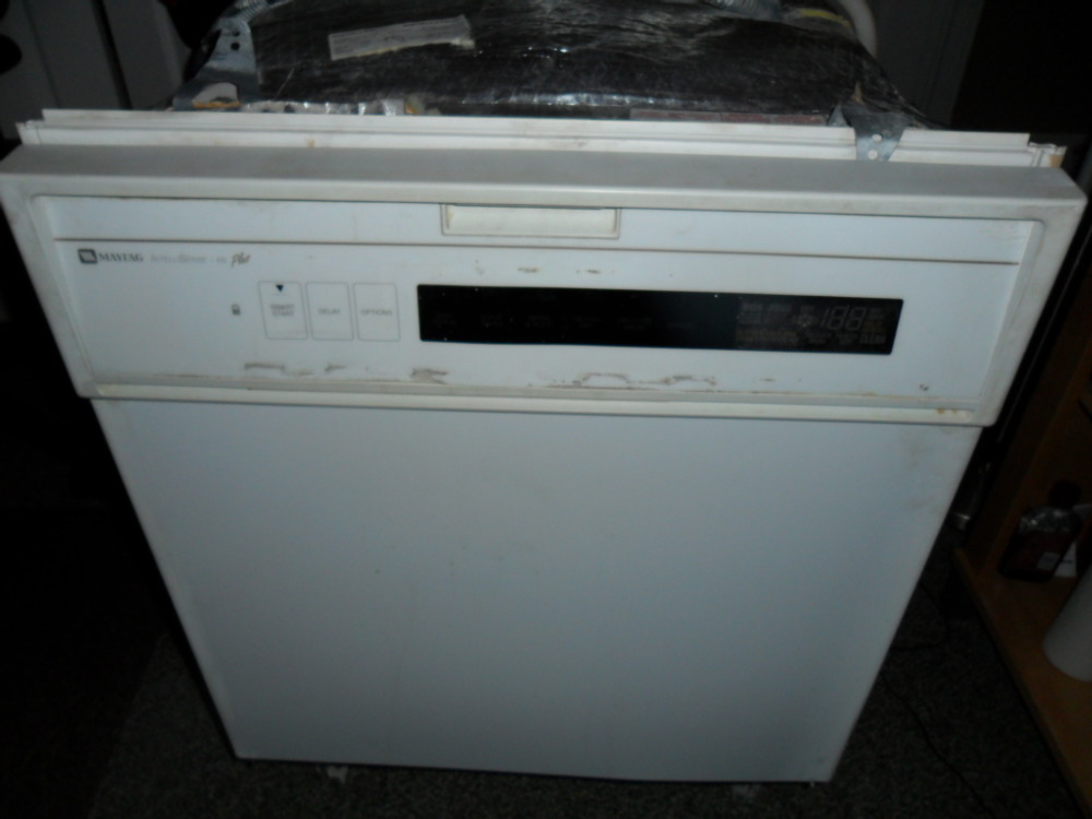

Maytag IntelliSense rides again! |

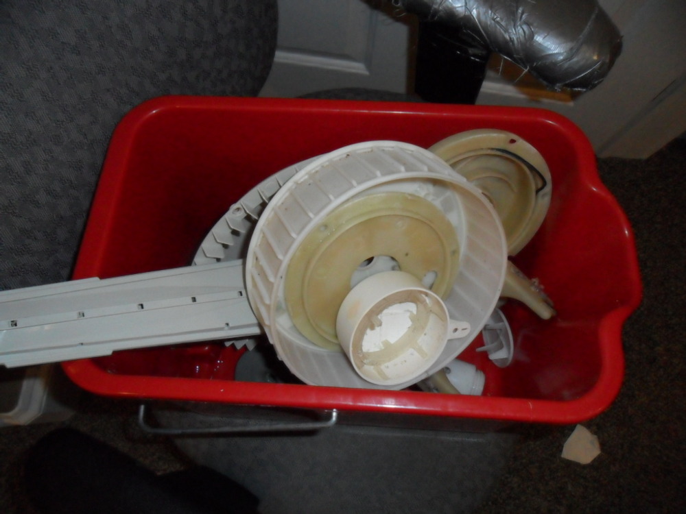

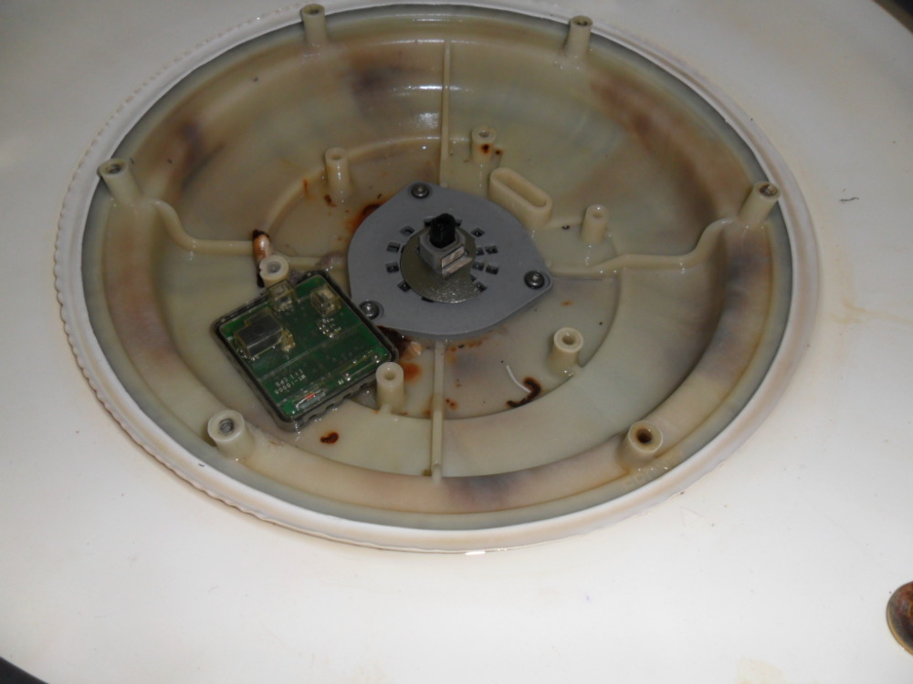

Here is all the pump components, plus the blower components, in a bucket going to the sink for a bath in steaming hot water! |

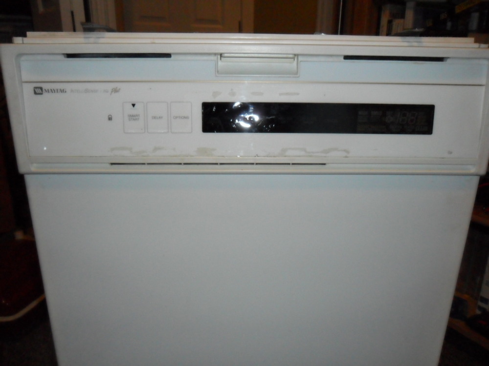

Thanks Kelly! Worst case scenario, I will just get a new touch pad made at a graphics/sign place here in the city. |
Post# 521566 , Reply# 12   5/31/2011 at 01:24 (4,685 days old) by redcarpetdrew (Fairfield, CA)   |   | |

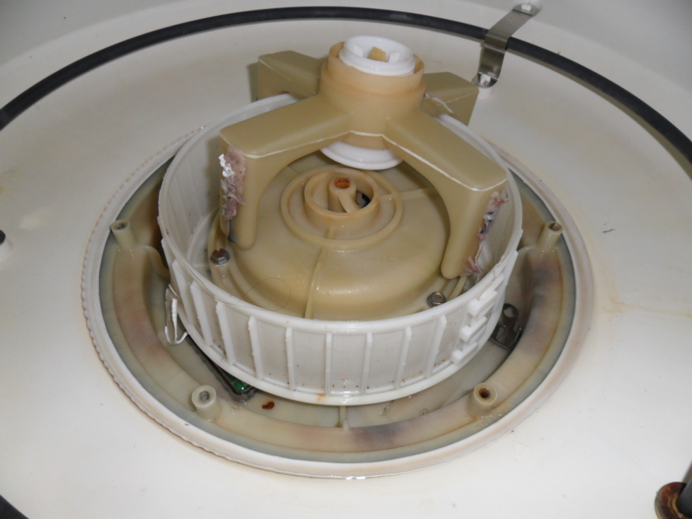

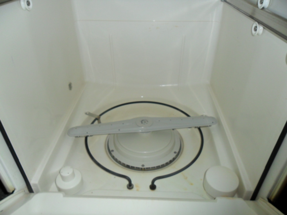

Happy day! I'm so jazzed she survived! You have a wonderful dishwasher there. Now I'm going to have to look deep in my garage because if memory serves me, I *might* have a few parts for this one left over from when I had mine and wanted extra parts... I don't know if I still have them but at one time I had extra control boards, motor/pump assys and maybe a spare console... I'll look here in the next few days...
Aren't those diagnostic routines a blast? Did you know that the blocked washarm sensing works by reading a magnet that's hidden in one arm of that four armed filter backwash piece that had the blocked slits? It actually reads the rpm of the washarm and screams if it's not in range. RCD |
