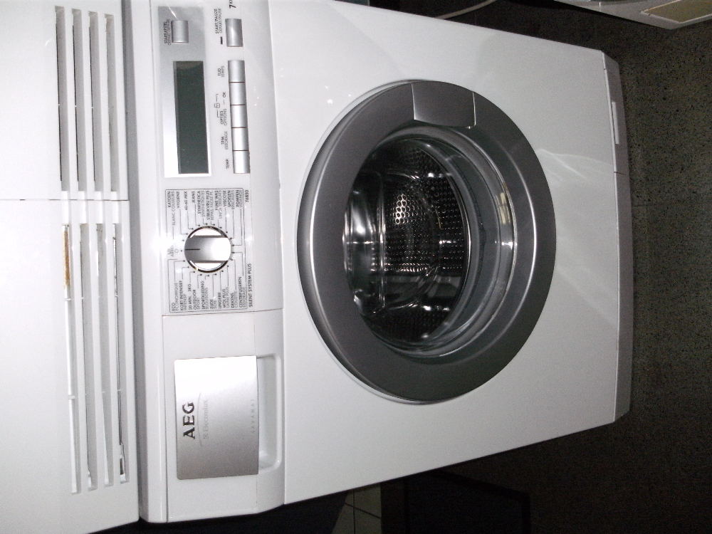

Post# 522492 , Reply# 5   6/4/2011 at 17:51 (4,709 days old) by targus ()
Well my almost 3 years old aeg (L76850) also makes that same strange sound.
Mine however only makes this noise at the start of a program and only at the start of each tumble. After some minutes it disappears.
I have always wondered what could cause this noise but because the machine works flawless I never thought that it was something serious but now I am starting to doubt.
I am going to see if it gets worse and then call an aeg engineer because I still have 2 years of warranty.
