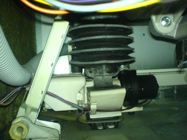

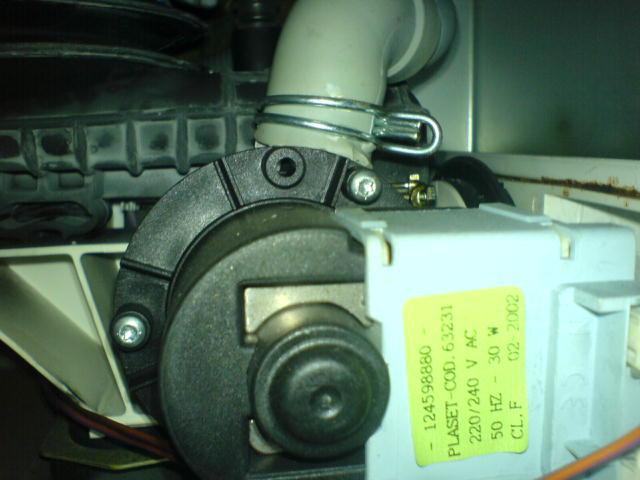

Post# 527610 , Reply# 5   6/29/2011 at 13:27 (4,655 days old) by aeg03 (London, UK)   |   | |
Pump area pic 1 |
Post# 527611 , Reply# 6   6/29/2011 at 13:28 (4,655 days old) by aeg03 (London, UK)   |   | |
Pump area pic2. The black piping I have squeezed it to see if I can dislodge anything but its not helped :-( |

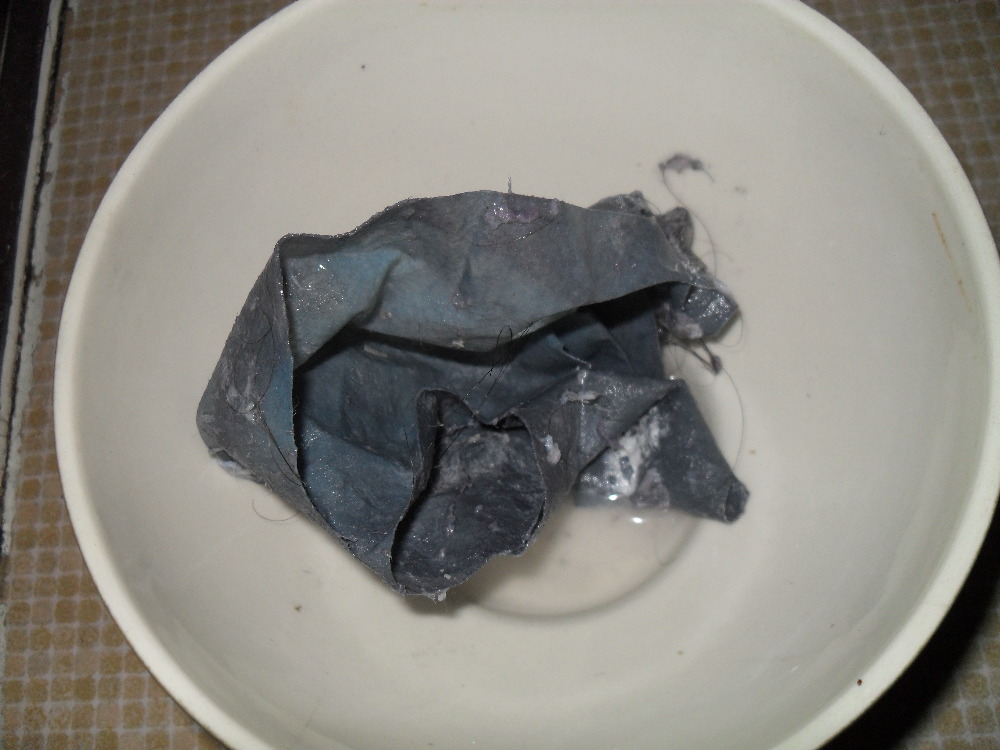

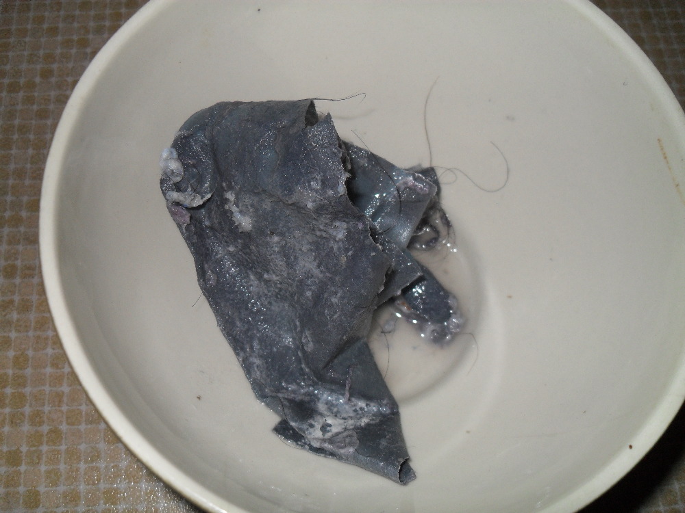

Post# 528067 , Reply# 11   7/1/2011 at 14:27 (4,653 days old) by aeg03 (London, UK)   |   | |
2nd pic |

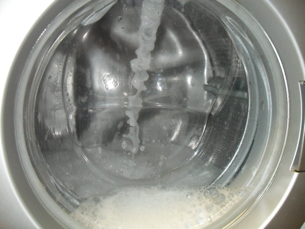

Post# 528068 , Reply# 12   7/1/2011 at 14:28 (4,653 days old) by aeg03 (London, UK)   |   | |
Jet has a strong stream again. |
