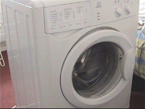

Hi everyone, a recent event made me realise how consumeristic our society has become: I just rescued an Indesit WIB101 washing machine from the tip which had been discarded because of worn carbon brushes. The machine is only a few years of age and beside the new pair of carbon brushes required, it's in perfect working order, clean and well kept (see picture below).
The motor was sparking, making frying noises and not spinning fast enough, I took the brushes out and noticed that they're were barely touching the rotor... aren't they supposed to have a few sprung loaded inches of length after removing them from the armature? Oddly enough, the machine worked fine after I put them back in, it even went through a cycle with flying colours... but I guess, my best bet is to buy a new set of brushes. Thank you in advance to anyone of you who could give me a rough idea of how long the carbon brushes should be. Thanks again :-) |

Before you buy new ones as I seriously doubt they would have worn down that much in a couple of years, Take them off the motor and if you can get the holder apart do so and then rub fine sandpaper over each side of the carbons then when you reassemble them make sure they spring back out when pressed in if they do then put them back in the motor and I am sure it will go for a few more years.
To see if they are too short when pushed into the holder against the spring they should protrude from it by half a inch maybe less but should not go all the way inside hope this helps? Austin |

Special thanks to ozzie908 and optima for addressing my question direct... I seem to have spotted the numbers '08' in the serial code so it's probably 3 years old. The carbon brushes and the holder are one piece and they come out together (I haven't tried to take them apart, maybe that would be my next move), they stick out of the holder just by half an inch which is enough to barely reach the rotating bit in the motor... I was expecting it to stick out much more once it was taken out of the motor. I will take them out again and make a video so you can see what I mean. Thanx again guys... speak you later. |
