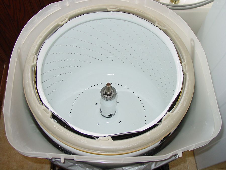

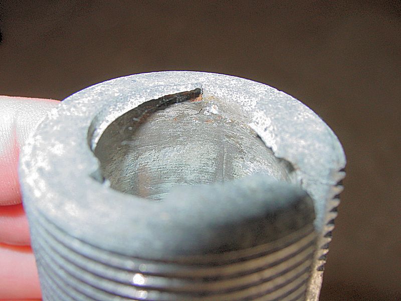

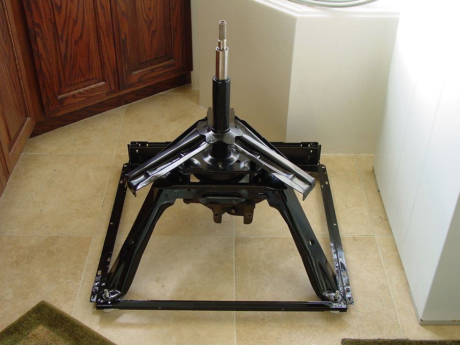

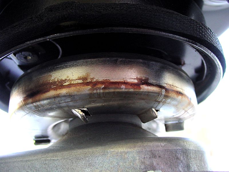

Post# 531738 , Reply# 7   7/20/2011 at 07:02 (4,635 days old) by surgilator_68 (Maryland)   |   | |

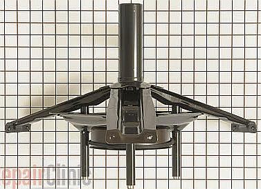

I would replace the basket drive. Those ears are too worn to sustain spinning for any length of time. You'll also need a new drive block. You'll also have to sand down the pitting on the agi shaft to pull the trans out of the basket drive. If you pull it all apart you can check the clutch lining for wear. If it's down to the rivets then it needs a new clutch. That one is the 6 pad. Make sure you add some turbine oil to the main bearings when you reassemble it. |
Post# 531763 , Reply# 8   7/20/2011 at 10:09 (4,635 days old) by DADoES (TX, U.S. of A.)   |   | |
Thanks, Jason! Upon closer exam of the drive block, the notches are worn more than I'd noticed. I'm sure the basket had been slipping and there are also a couple mild scrapes where it had rubbed on bottom of the tub. This project has turned much more expensive than I anticipated, but I suppose either do it properly or not at all.

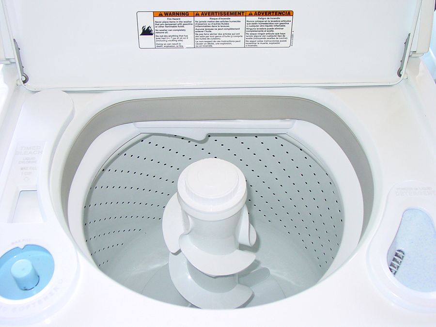

Post# 535952 , Reply# 30   8/9/2011 at 15:45 (4,615 days old) by DADoES (TX, U.S. of A.)   |   | |

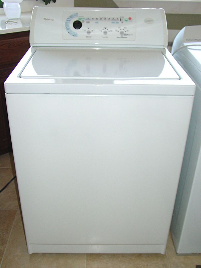

Investment is approx $425. $25 for the machine ($50 pair, dryer refurb is pending). Approx $400 in parts & materials -- new top, lid, basket, pump, a few other items, bunch of hose clamps, a few screws, paint supplies. Yes, I am insane, LOL.
I shot a video early this afternoon, had technical difficulties. Doing another now, smaller load. Hopefully it'll be OK. |

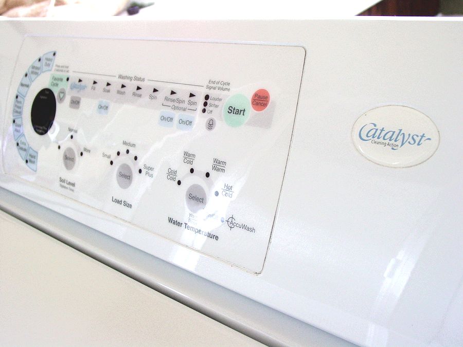

Part 1 of 3 -- catalyst treatment and wash period. Four pairs jeans. Normal cycle with Catalyst option. Less soil (8 mins agitation). Medium water level (medium agitation). Agitation speed (hi, med, low) varies per cycle and choice of 5 water levels. Normal cycle at Super and Med-High levels runs a high -> med shift on both wash and rinse. Hand Wash runs intermittent low agitation. |

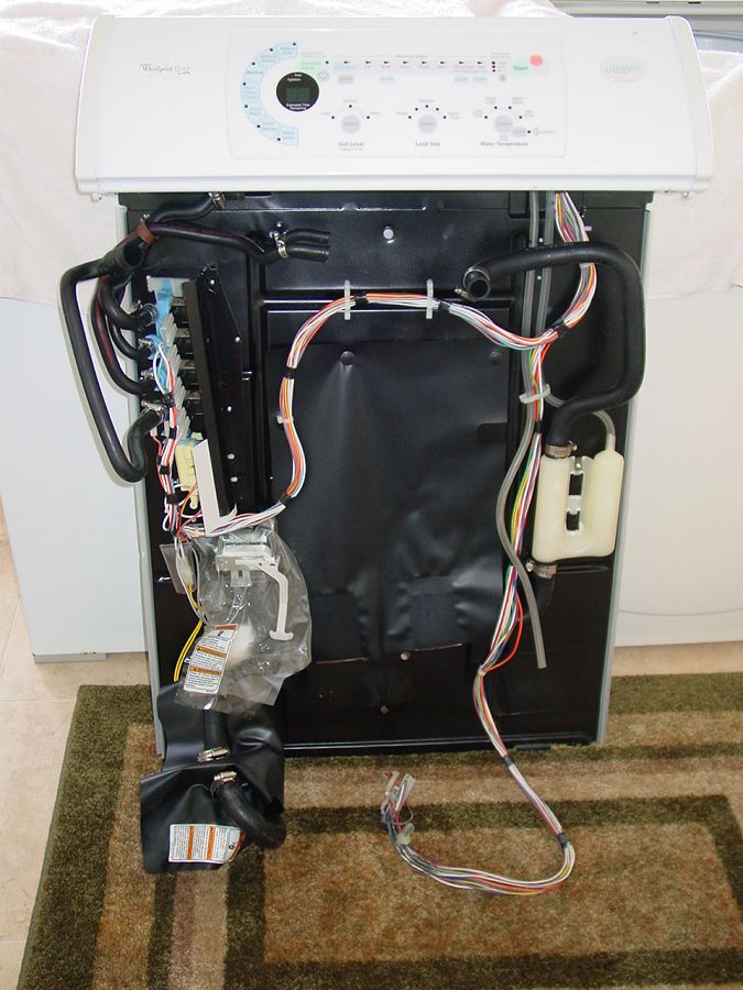

Post# 536183 , Reply# 36   8/10/2011 at 13:18 (4,614 days old) by DADoES (TX, U.S. of A.)   |   | |

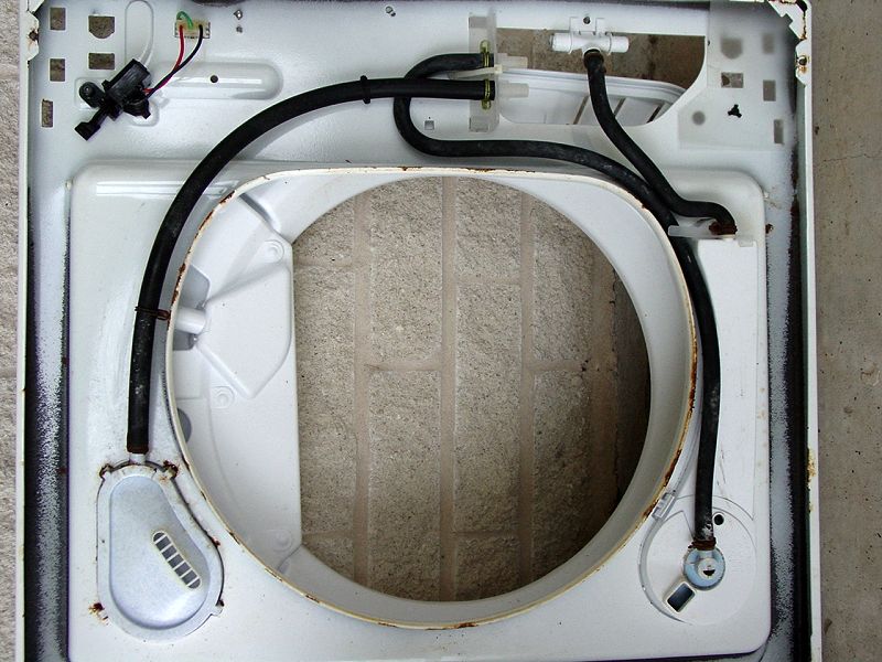

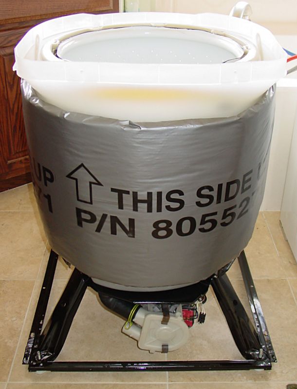

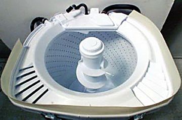

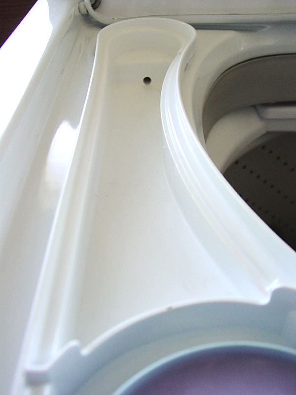

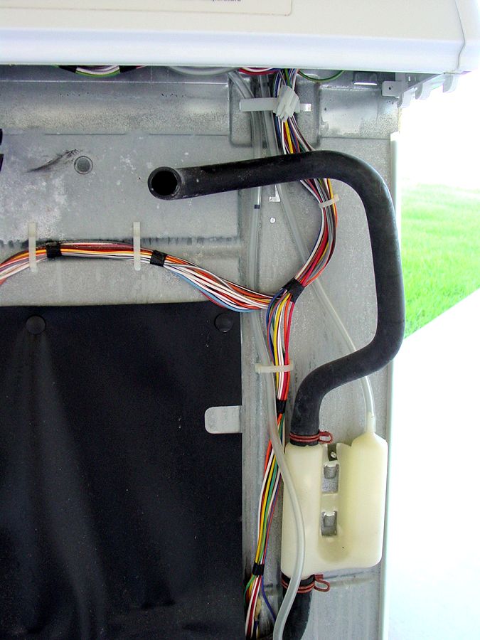

Unfortunately I didn't take pictures of *everything* and removing the cabinet is a tad difficult with four dispenser hoses to disconnect so I'd rather not. The seal around the top opening is a splash guard. There's also a similar guard that snaps around front and sides at the outer edge of the tub ring to ward-off splashing from the softener & detergent dispensers release areas. Pic of the tub ring below is captured from the service supplement. In addition to the tub wrap, there are thick insulation pads glued to the left & right sides of the cabinet at motor/tranny level, along with the usual three small thin cabinet pads. The parts list indicates another layer of sound padding in the base under the motor/tranny, which for some reason is missing from this specimen. The base pad shows to be available but it's expensive for what it is (LOL) so I didn't get one. My KA toploader has a base pad (which must be of a different design as it's NLA). Another interesting observation -- parts listing shows an under-basket comb filter, which this unit did not have. Instructions for the replacement basket advise to order a set of the "new-style" filter discs, which I did, but the basket that was sent does NOT have mounting holes for them ... so there's no lint filter on the machine. The basket balance ring is dual-chambered. The upper section contains the usual water ballast. The lower chamber contains 320cc of (mineral?) oil and 18? ball bearings. |

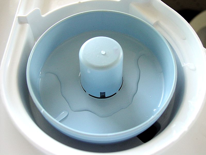

The softener cup does not spin. :-) It holds the softener dose until release, at which point water flows up into the cup through the slots in the centerpost, overflowing the dose through openings in the dispenser base beneath the cup, down through the tub ring and into the tub. When the water flow stops, majority of the remaining water siphons out through the centerpost slots. The cup is flushed twice in succession. |

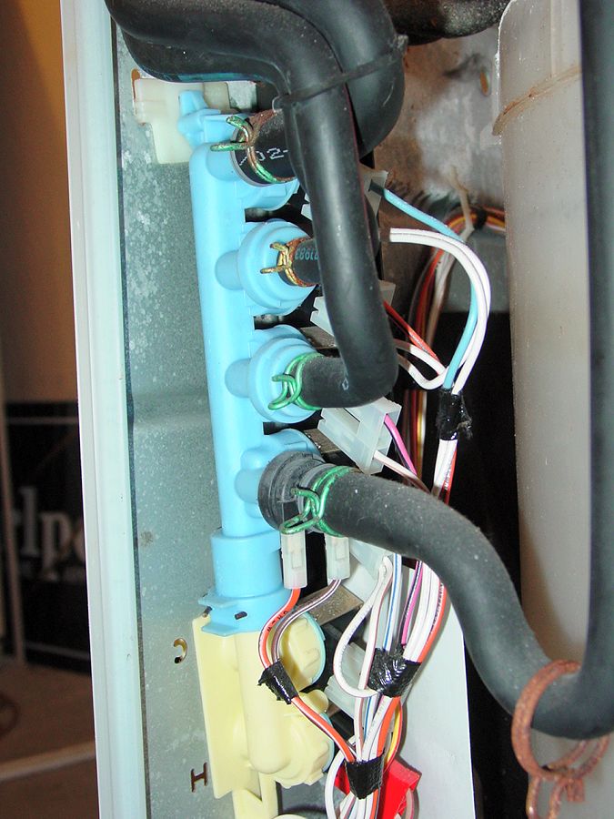

The bleach tray holds 1 cup of liquid. Reference the pic above, the bleach dispenser hose leads to a T-union (bleach venturi). The bleach water valve inlet hose attaches to the right side of the venturi (left side when the machine's top is flipped right-side up), another hose leads from the venturi to a connector atop the tub ring. A short burst of water through the venturi creates a vacuum/siphon effect on the dispenser hose, which pulls the bleach from the tray. The bleach dispenser is "siphoned" three times in succession during the last few mins of the wash period. The Calypso's bleach dispenser has some water pushed into it via the venturi as part of the siphon effect (flushed several times), I suppose for purpose of rinsing the tray and hose to avoid bleach spotting on a successive load. I have not observed that happen on the Catalyst, the bleach simply drains out. |

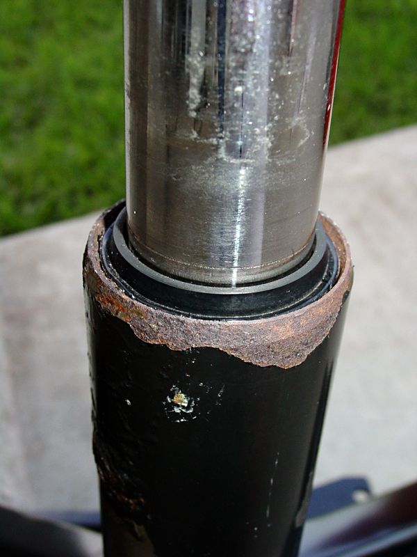

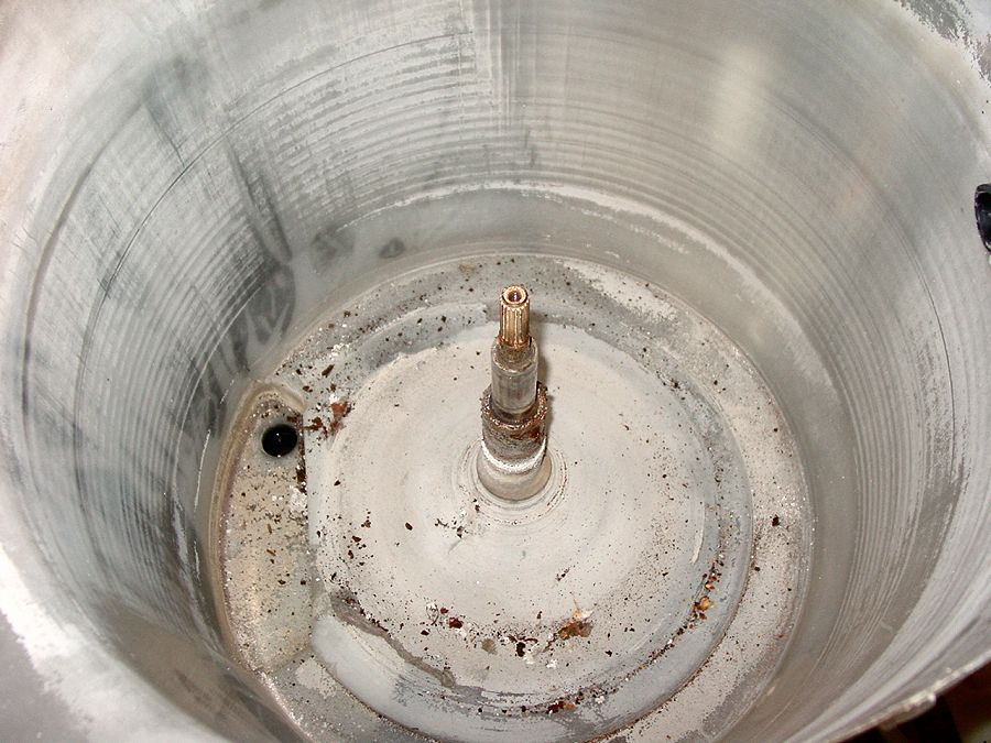

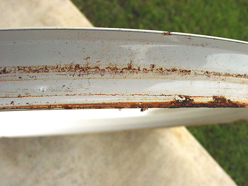

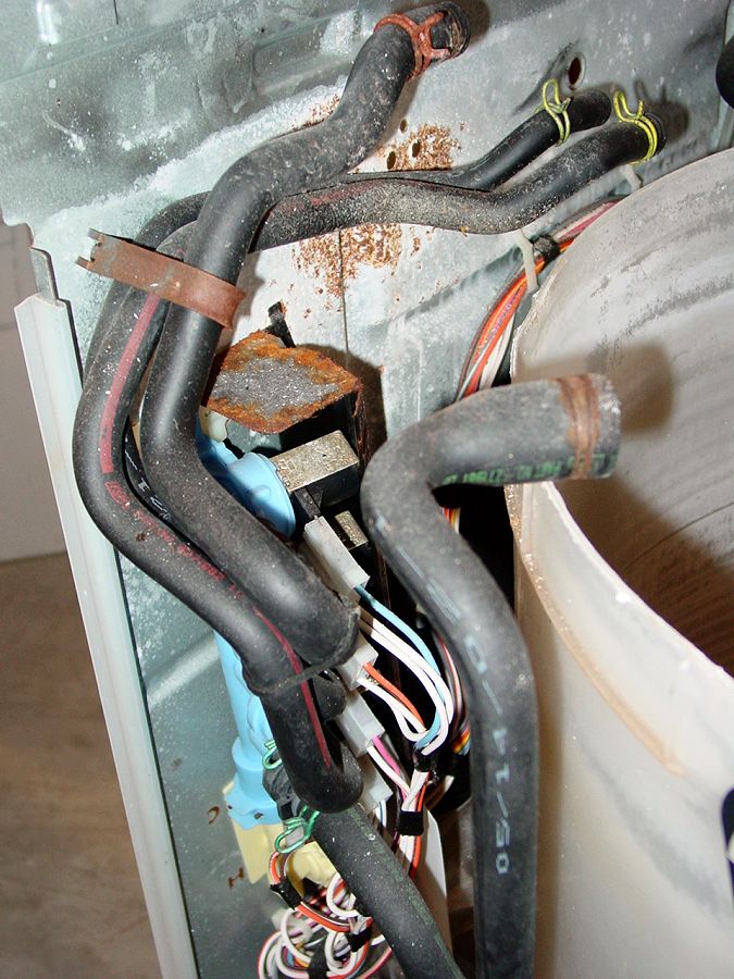

Noises vary from load-to-load depending on oscillation intensity. Regards to the rusting ... the machine came from a bay-side area within miles of the coast, Gulf of Mexico ... so both moisture and salt-air exposure. All hose clamps are replaced. A few had permeated into the rubber. The old top doesn't look so bad, but I wanted the machine to look nice. The edges of the lid had rusted and the lid gasket was gone ... so the top had some rust staining from contact with the lid. Can't say about the catalyst treatment, as I've not subjected it to extensive stain/soil testing. It should have some effect based on observation. There's not much water involved, so the detergent solution should be very concentrated. I did notice in a couple instances that the detergent didn't dissolve very well, lot of powder on the items ... which of course it did dissolve during agitation. Perhaps liquid detergent by nature would work better. Since so little water is used, it's unlikely to be at warm or hot temperature unless the water heater is very close. Catalyst is quite similar to F&P's EcoActive process, which uses more water and rotates the basket at 25 RPM instead of a full-out 420 RPM spin. Calypso does the same sort of process as a pretreatment while fill progresses, rotating at 60 RPM. Soak can be used as an add-on option to any cycle, or as a stand-alone cycle of 10, 20, or 30 mins soak time. When used as an option, soak time is not directly selectable, I assume it varies per the selected agitation time / soil level. The first washer I bought was a KitchenAid, with the massive SureScrub™ version of the dual-action agitator. I'd not otherwise had exposure to the smaller Whirly version. Interesting to note that the KA version does provide improved rollover. I ran a LARGE load of casuals/shirts in the Catalyst which had quite lethargic rollover at medium agitation speed (didn't seem to be much chance for shredding, LOL). I recall running similar loads in the KA to noticeably better rollover (also at medium speed, KA does not use high motor for agitation). I have not run a Heavy cycle / high agitation yet in the Catalyst, but I have done so in my Kenmore 90 ... it's brutal! |

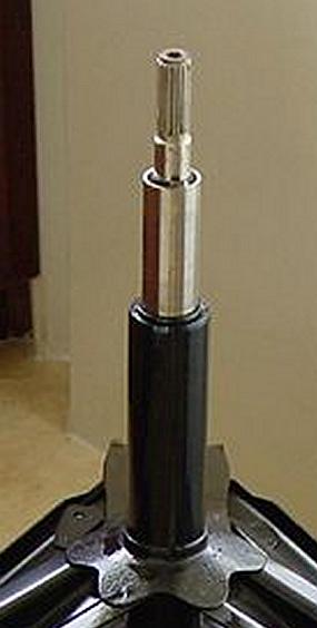

Post# 544449 , Reply# 57   9/19/2011 at 03:36 (4,574 days old) by foo123 ()   |   | |

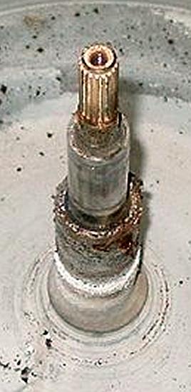

Center Post Before |
Post# 544450 , Reply# 58   9/19/2011 at 03:38 (4,574 days old) by foo123 ()   |   | |
After |
Post# 544576 , Reply# 60   9/19/2011 at 16:16 (4,574 days old) by DADoES (TX, U.S. of A.)   |   | |
I decided not to replace the spin tube, or the tub support, simply cleaned it all up. New drive block, of course, which fit VERY tightly on the spin tube. Wire-brushed the centerpost, then treated it with a coat of POR-15 all the way up/onto the seal, but not past the seal onto the spin tube, and a few areas of minor rusting on rest of the support and pedestal base. DD bearings seem to last longer than BD, and (as I understand) a replacement tub support includes bearings preinstalled so replacing the support (if it comes to that) is more reasonable than dealing with pulling/setting bearings. I did the same treatment to the Kenmore 90 about a year ago. Its centerpost had slightly more rusting than the Catalyst, and even some pitting. Did two coats of POR-15 on its centerpost and one coat on rest of the tub support and pedestal base. Some here have reported that POR-15 doesn't last as long as one may expect ... which it is considered a primer that should be top-coated. Be interesting to see what's the condition of the Catalyst when it gets done with the first set of tenants ... or the condition of the Kenmore 90 after some use. I have two more DDs to refurb (or three if my KA is included). One is a FreeCycle freebie Kenmore 400 circa 2006 that has a bad tranny. The other is a Roper RAX4232 circa 2002 that came from a deceased relative and was not used more than approx 1.5 years so should be in very good mechanical condition. |
