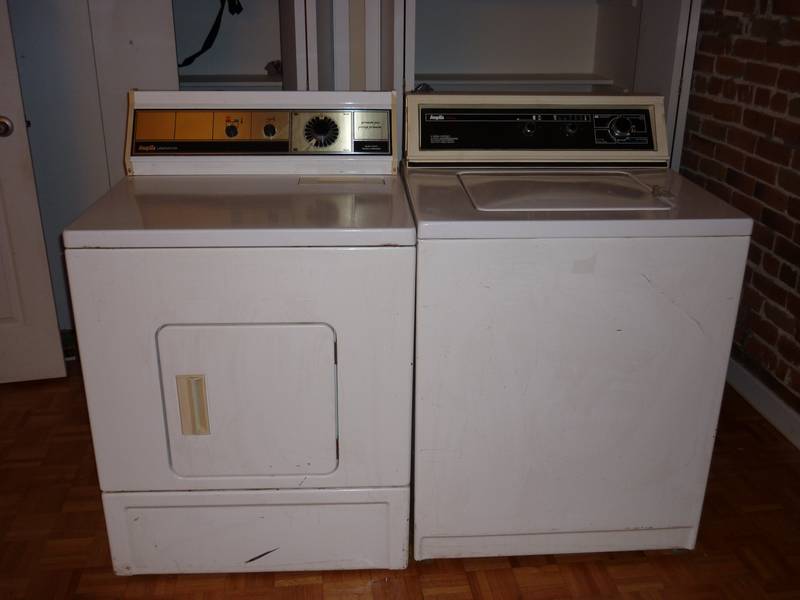

Post# 532046 , Reply# 6   7/21/2011 at 15:50 (4,660 days old) by pierreandreply4 (St-Bruno de montarville (province of quebec) canada)   |   | |
