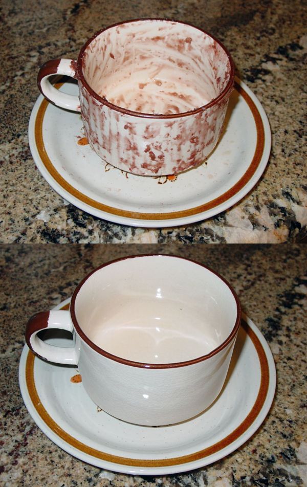

Modern dishwashers, and many "vintage" units, should not need any prerinsing or prewashing of items before loading.
My machine is routinely disparaged as being useless but can easily clean an item like this, so any 'real' dishwasher surely can do better!
