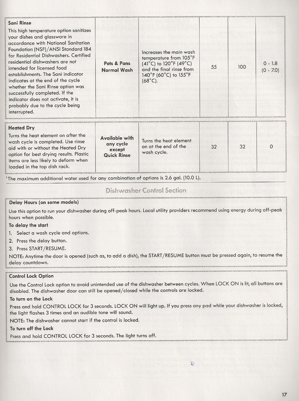

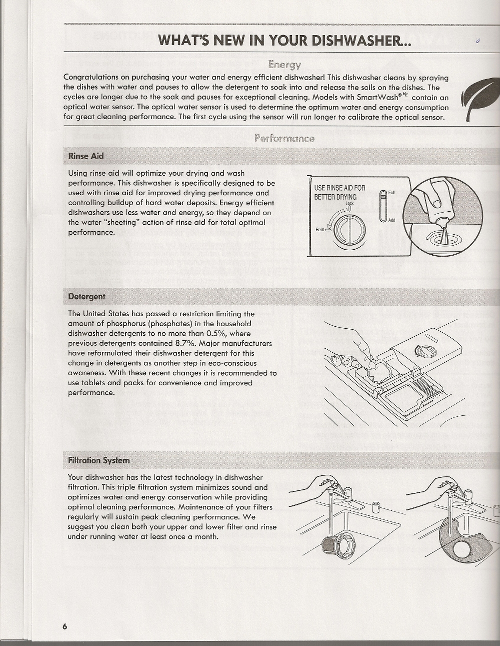

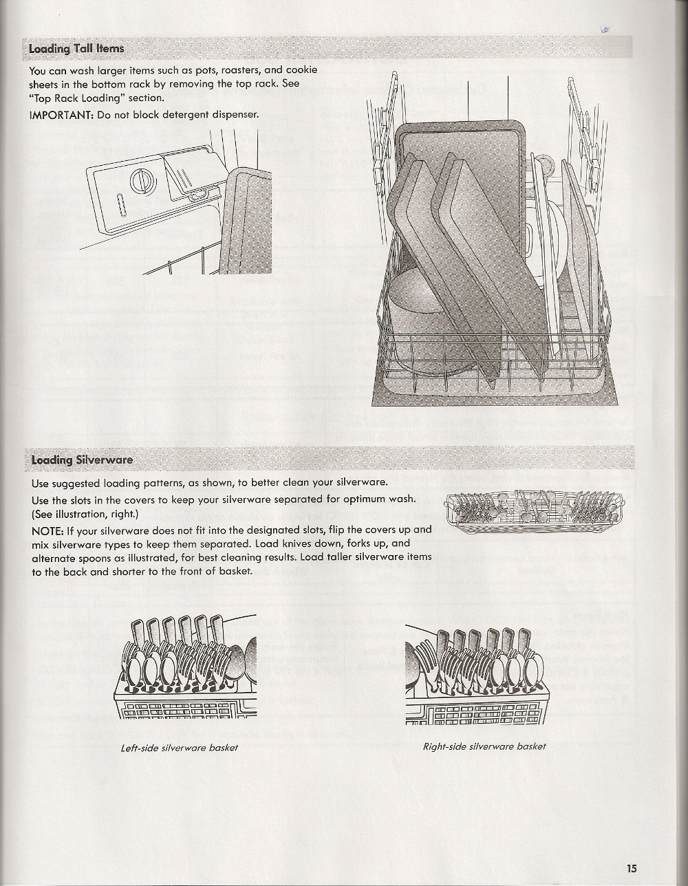

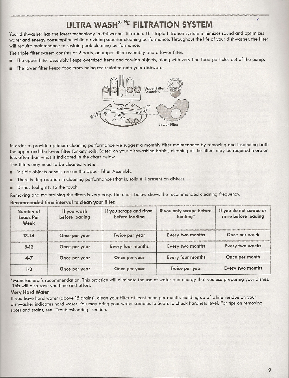

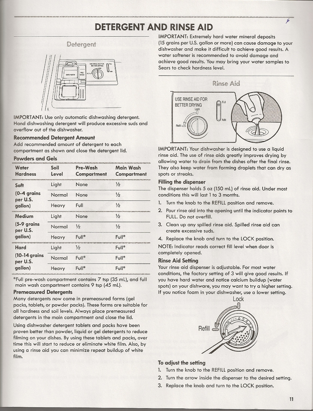

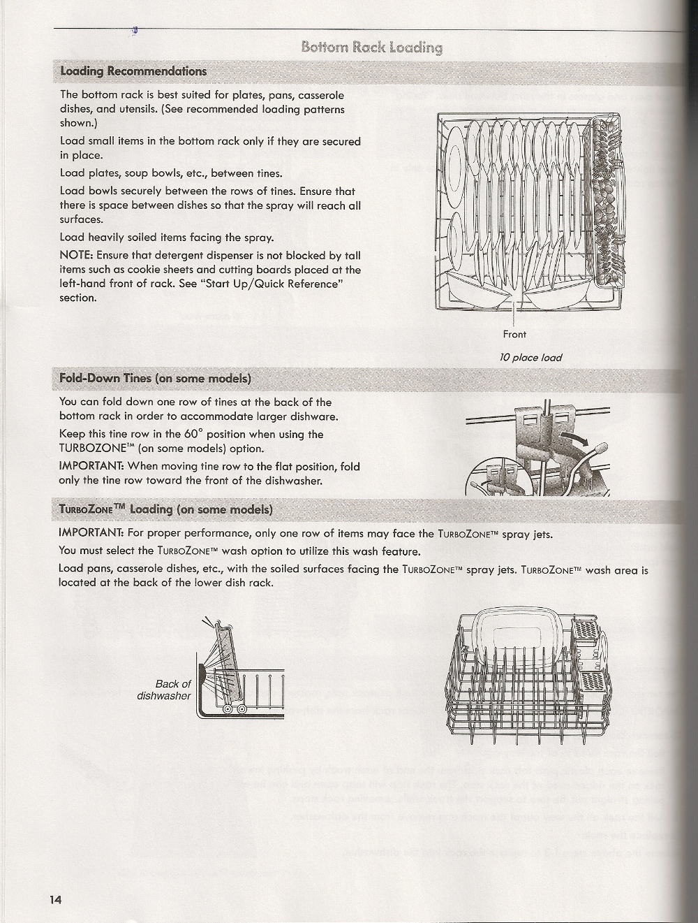

I did some investigation and got a instruction manual probably related to a few models. I will first post the new models and try to post the instruction book inserts. You guys be the judge!
CLICK HERE TO GO TO peteski50's LINK |

I was unable to obtain the manual for the older model just posted but on the above posted link you guys can see the manual and compare the specs between the new and old ultra wash.
I personally like the older models better - quicker washing time, higher washing temp, split silverware basket. So if you want a dishwasher get their quick before supplies run out! |

I don't object to the filters and in fact I do like the way these new ones look. The loading looks easy and their is something cool about them. I also don't mind that each wash arm operates seperatly. What I don't like is the extreamly long operating times and well as the lower temperatures. To me this is a big lack in flexability as well as going several steps backwards. If at least if the wash temperature was higher it would also contribute to a faster washing time. I dont understand what the reason is. And yes I did get a laugh at that overnight up to 7 hour cycle. (how crazy is that)!
Peter |

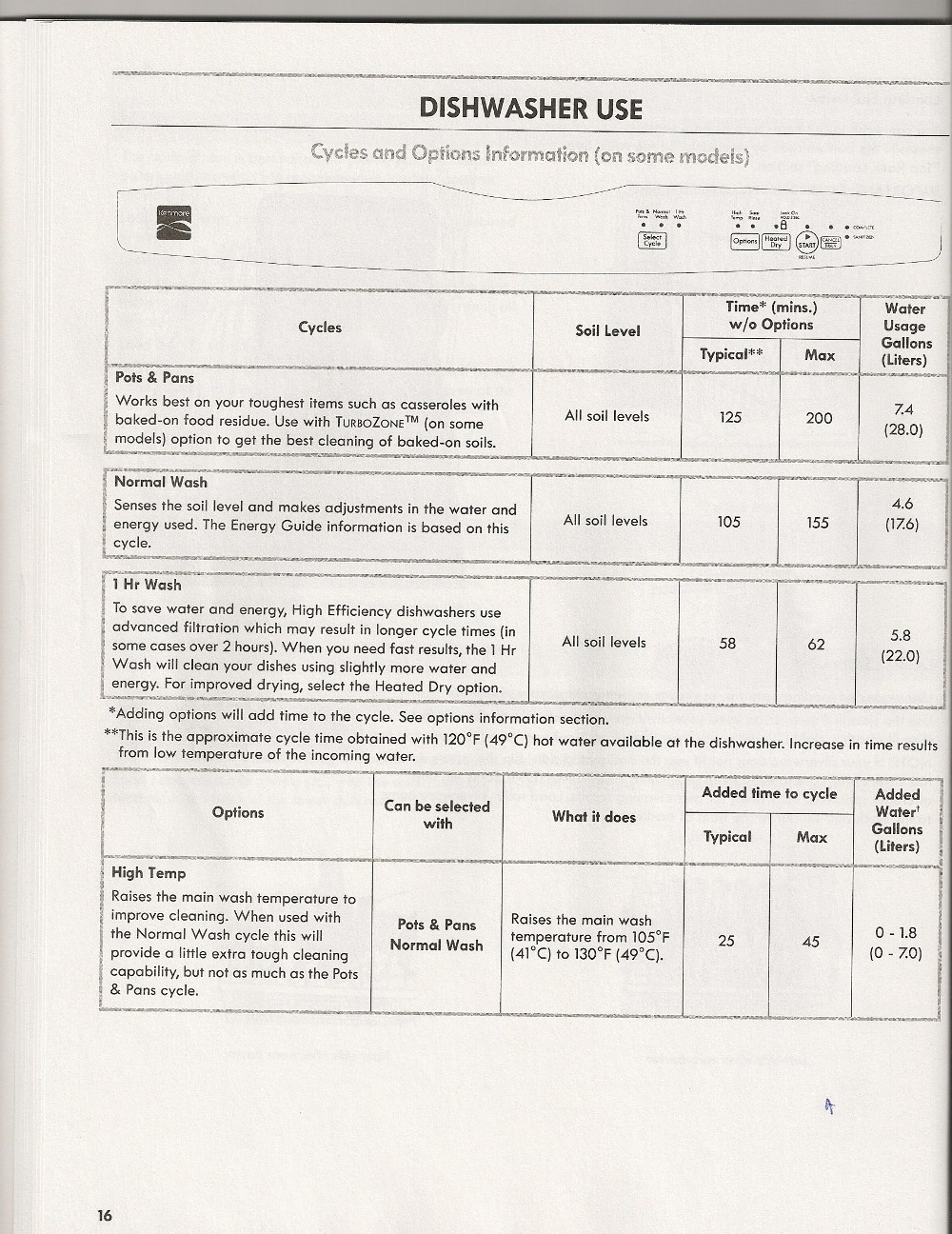

It is not even the cycle times themselves but the amount of time they use to heat water makes no sense - if anyone looks above it states it takes 25 to 45 minutes to heat water to 130 (what happened to heating to 140) I thought that was a more standard temperature. Also I personally want my dishes washed in hotter water. Also older models would go from 120 - 140 in about 15 minutes max! So I cant figure what this is all about. All this new stuff is so unnessary. Is the newer detergents designed to work in cooler water or what? Even with the cutback on water usage I cant figure out why it takes so long to heat it and why it is using lower temperatures to wash with. It should be the opposite taking less time to heat and utilizing higher temperatures.

Thanks for posting the manual; as always, it's an education to learn how the newest machines work. Interesting that temps are getting lower. Wonder which brand will move it down to 120-125 degrees? I would imagine that detergent manufacturers are trying to come up with formulas that will work in lower temps.
I, like others here, have wondered how cycles can be so long, yet energy use is reduced. The manual states that there are "soak" periods in which the motor/pump isn't running. Suppose that explains a few things. I don't know how they could possibly use smaller motors and pumps. I think manufacturers have pushed those downsizes to their practical limit. As for individual/alternating rack washing, I'm fine with it. My LG (and a Frigidaire I had before Smokey The Maytag) washes each rack alternately and results are spectacular. As long as the LG remains reliable (a big problem with LG dishwashers, according to Consumer Reports) I've never had a better dishwasher--and I've had a lot of 'em! |

Peter, lower wattage motors and lower wattage heating elemtns. Both translate to much less power draw over time. That was also a part of the intent of the design.
I suspect for most households' applications, the 1-hour wash cycle is more than sufficient. And the "enhancement" to that cycle over the generation of machine I have is that the dry cycle is an option for this cycle, where as, my quick wash 30 minute cycle doesn't offer that capability. |

Glenn, there is an owners manual for the Kenmore Elite Pro online. It said the main wash temp was raised from 105 to 120 for both high-temp and sani-rinse options. The final rinse temp was raised from 140 to 155 when Sani--rinse option was used, so that leads one to believe the final rinse for no options is 140 degrees.
I just looked at the highest-end KitchenAid Superba and it said high-temp scrub raised main wash temp from 105to 120 degrees. The sani rinse option raised main wash temp from 105 to 130 and final rinse temp from 140 to 155. I particularly like to use sanirinse option when I've been cooking with beef or chicken and I have utensils in there that were used with the raw meat. |
