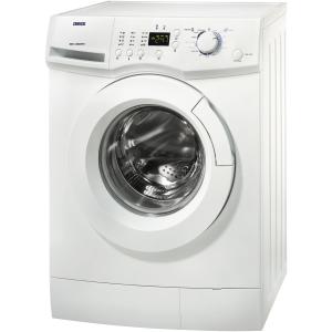

Post# 541040 , Reply# 3   9/1/2011 at 11:34 (4,620 days old) by ozzie908 (Lincoln UK)   |   | |
The firs thing I would try is the thermostat to me it sounds like its got stuck and is telling the PCB its up to temperature hence its just moving on and not stopping.
Worth a shot as its the cheapest part to replace. Test to see if there is continuity through it as it should not have any till it gets warm This is my opinion and I could be way off whack but what have you to lose? Austin |
