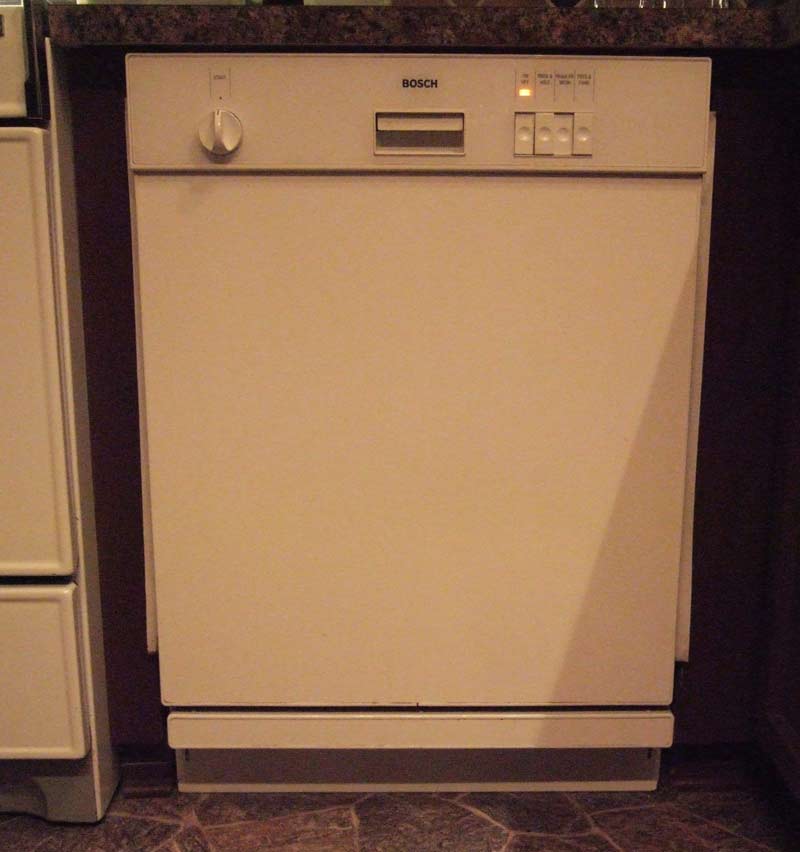

Post# 542861 , Reply# 10   9/10/2011 at 22:09 (4,583 days old) by PhilR (Quebec Canada)   |   | |
A friend gave me a late-nineties BOL Bosch SMU 2000 dishwasher that needed a few repairs (I replaced a wire that was cut at the door opening, the rollers for the upper rack and the pilot light for the on/off switch (with a pilot light from an old Flair range that I parted out). After that, I still didn't feel it had enough GM Frigidaire content to be worth keeping it so I gave it to my parents to replace their old WP-built Kenmore dishwasher (which worked fine but it had rusted racks). The Bosch is very silent and it has an exposed heating element which dries the dishes nicely but it seems to take forever to wash them. Since I'm not used to new (or should I say less than 30 years old!) appliances, are all newer dishwashers that slow or is this an Euro thing? |
