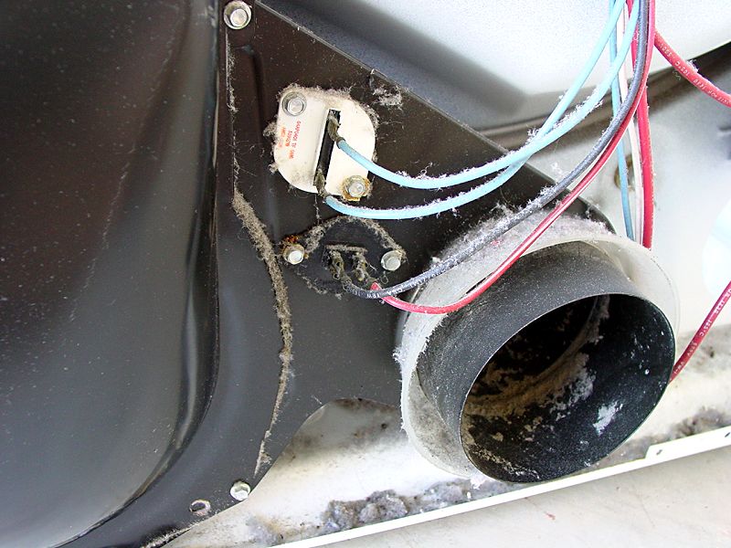

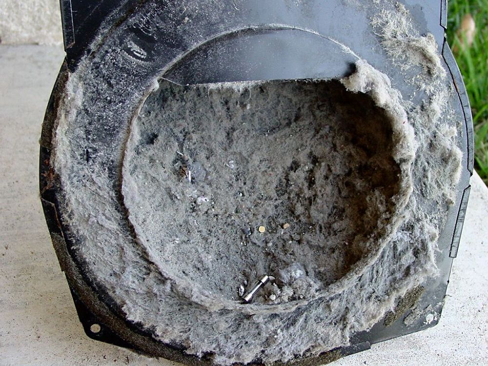

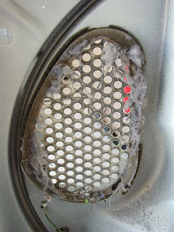

Back of the air intake on the bulkhead. The foam seal is deteriorated. This post was last edited 09/11/2011 at 21:50 |

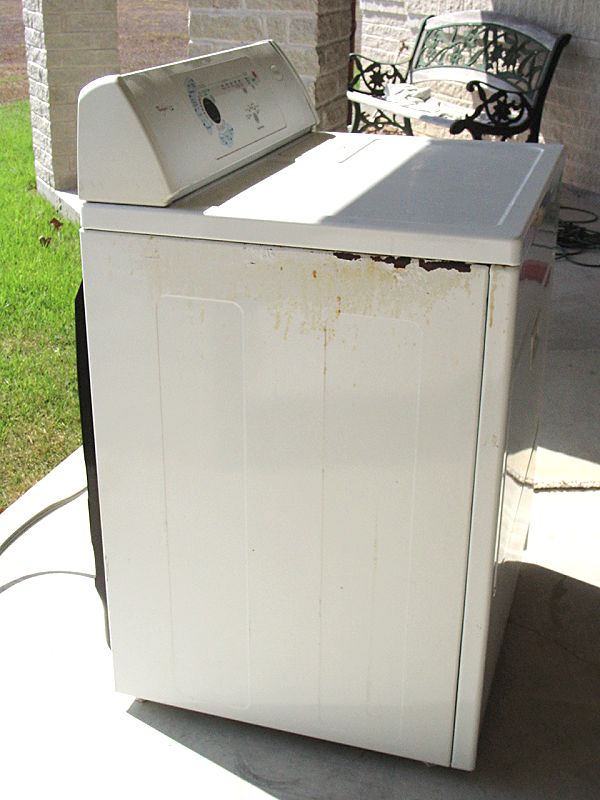

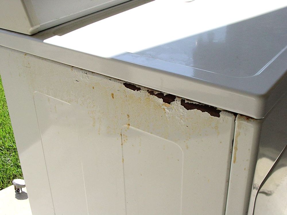

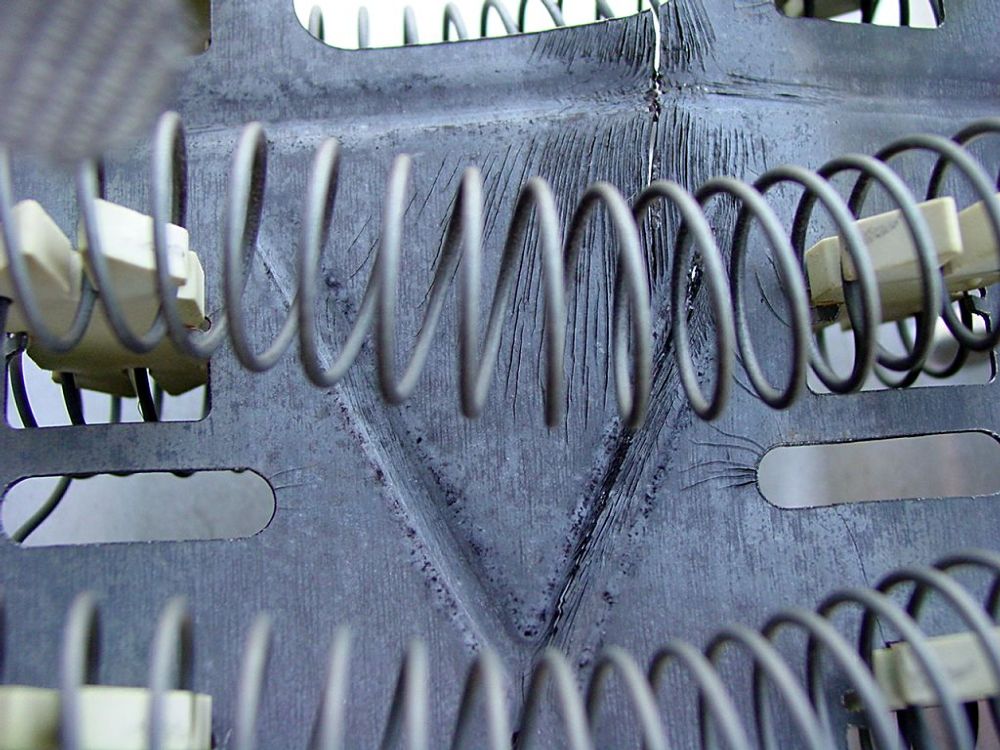

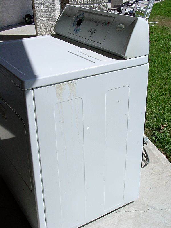

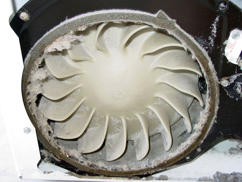

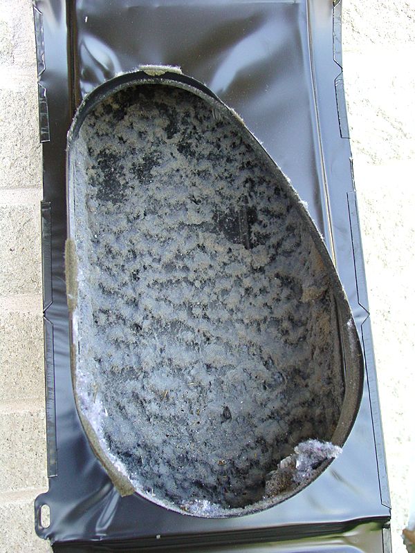

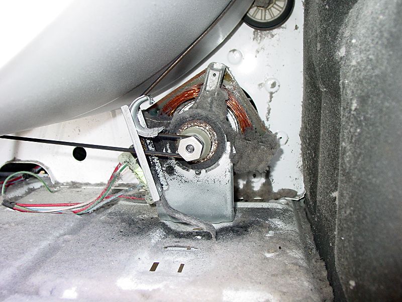

Post# 543121 , Reply# 24   9/11/2011 at 20:12 (4,609 days old) by combo52 (50 Year Repair Tech Beltsville,Md)   |   | |
Welcome to the world of appliance abuse. The heater is probably OK but this dryer was operated with less than a ideal exhaust system, but I an sure that will not happen under your care. Other wise it looks like you are doing a great job as usual and this dryer could last another 20-30 years if the main board cooperates. |

Post# 544378 , Reply# 32   9/18/2011 at 20:28 (4,602 days old) by AutowasherFreak ()   |   | |
I'm really surprised that it didn't go up in flames. What a yucky mess, but after seeing what you did to the matching washer, I sure you will have it looking as good as new. |

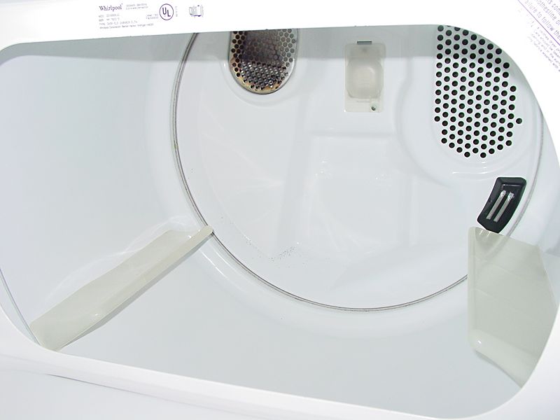

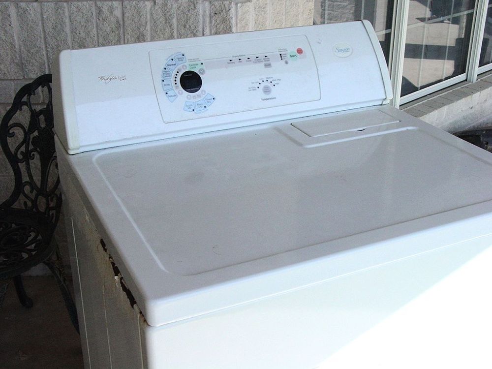

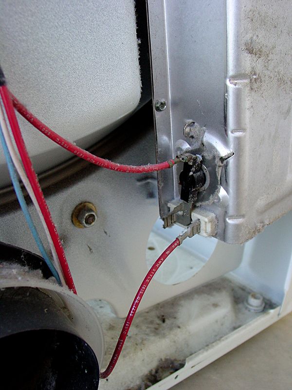

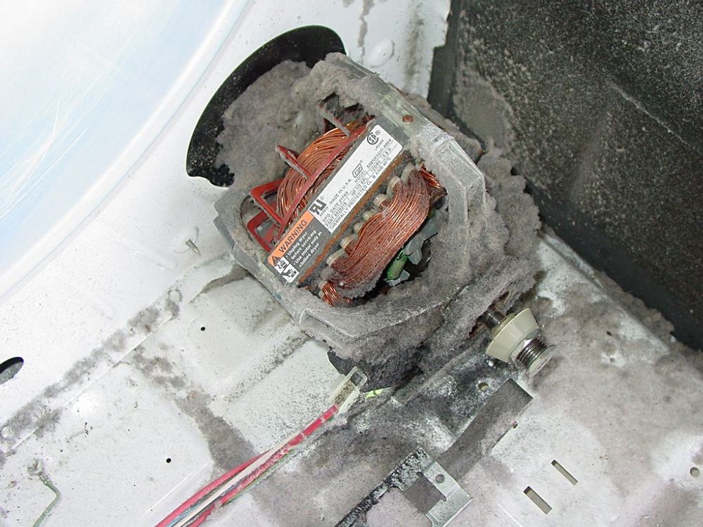

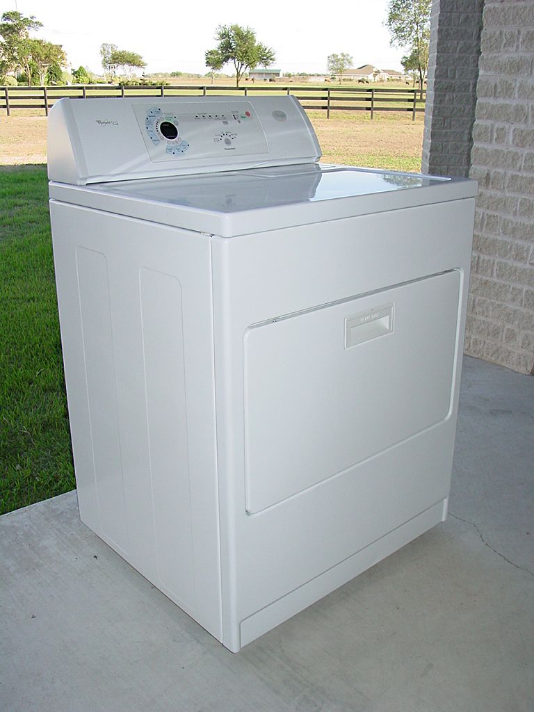

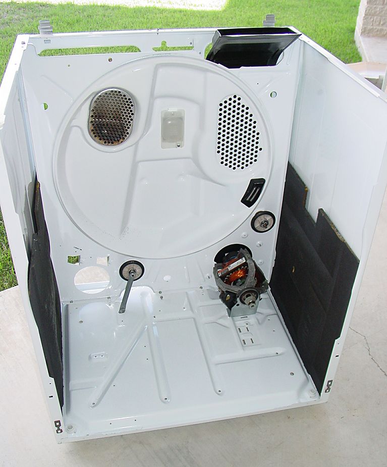

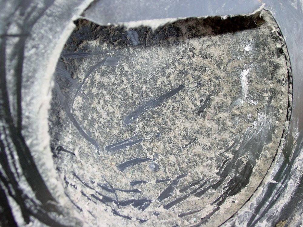

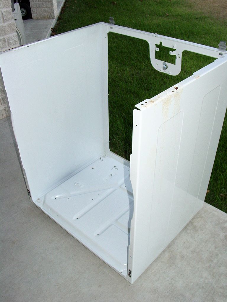

Post# 547660 , Reply# 33   10/5/2011 at 21:07 (4,585 days old) by DADoES (TX, U.S. of A.)   |   | |
I suppose I should finish this thread. Parts: heating element, high-limit thermostat, dryer refurb kit (belt, idler, drum rollers), console endcaps (one was broken), weather stripping, light bulb, spray paint. I found that lacquer thinner removes the blue stain (paint thinner does not). Compressed air to clean the motor. |

Post# 547673 , Reply# 36   10/5/2011 at 22:51 (4,585 days old) by A440 ()   |   | |
Awesome Job Glen! |
Post# 547683 , Reply# 37   10/5/2011 at 23:30 (4,585 days old) by CircleW (NE Cincinnati OH area)   |   | |
Very nice! Looks like you just took it out of the factory carton. |
