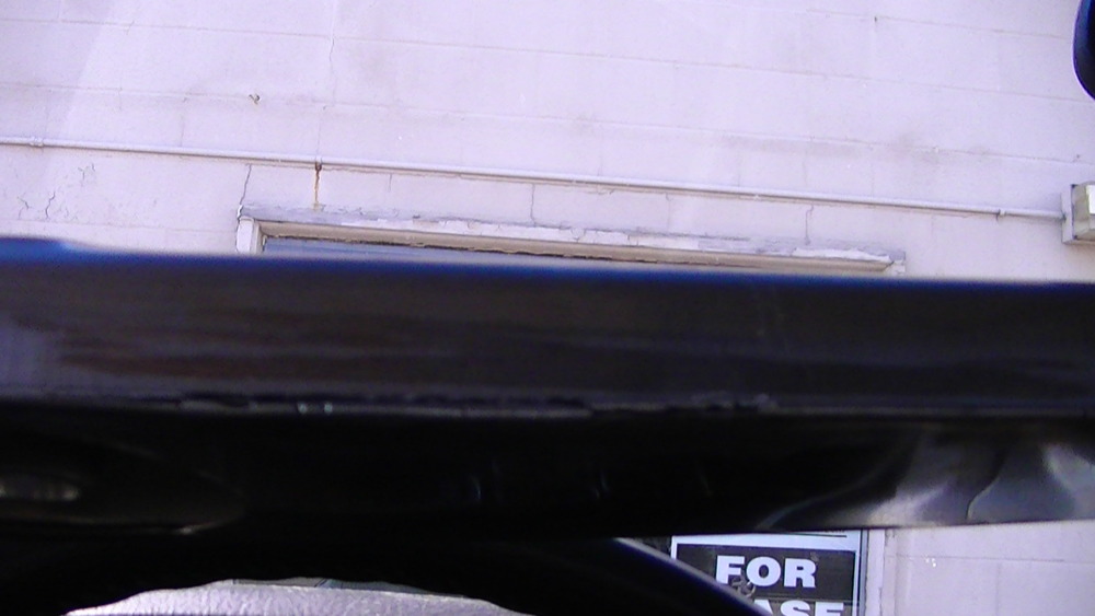

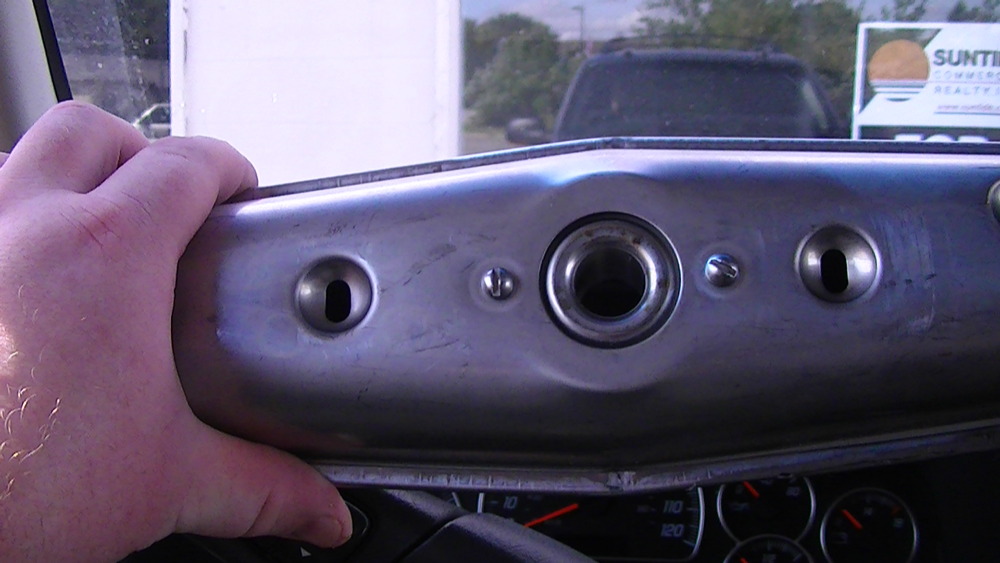

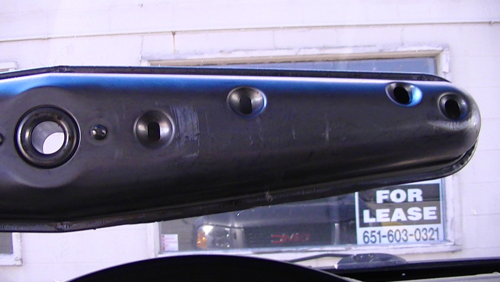

The Hobart AM-14 Dishwahser at my work was spitting out water at the side doors today. I pulled out the upper wash arm to find that the SS had split where it is crimped and took it to be welded. Mind you this is no small wash arm. I took the photos against the steering wheel of my car for size comparison.
