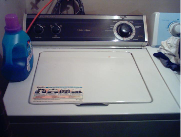

Apperently my washer (pic below) was neutral draining and while neutral draining it slipped into spin drain. Is this bad? HELP!!! Yes it works fine |
Post# 47714 , Reply# 1   10/24/2004 at 21:33 (7,115 days old) by coldspot66 (Plymouth, Mass)   |   | |
That really is not a problem. Some washers do that after a while. Does not affect the machine much. It may wear the clutch ring after awhile. You should be fine. Most people would not even know that it slips into spin during neutral drain. |
Post# 47781 , Reply# 3   10/25/2004 at 17:38 (7,114 days old) by fixerman ()   |   | |
Kenmore78, It sounds like you are describing what a belt drive washer would do. According to the pic it looks to me like a DD. |
Post# 47784 , Reply# 4   10/25/2004 at 18:11 (7,114 days old) by compwhiz ()   |   | |
It is a dd |
Post# 47838 , Reply# 5   10/26/2004 at 06:57 (7,113 days old) by kenmore1978 ()   |   | |
You're absolutely right, I realized that the machine was a DD after I'd posted. |
Post# 47926 , Reply# 6   10/27/2004 at 15:57 (7,112 days old) by Joe_in_philly (Philadelphia, PA, USA)   |   | |
That is exactly how the DD washers work. Normally, when there is nobody to open the lid and interrupt the cycle, as the dial turns to spin from drain, the motor is briefly shut off. When it is restarted, the tub spins. There is a slight click when the motor stops as the tub become engaged. You will notice, if you open the lid during the drain, the motor shuts off, and you will hear a slight click noise. When you close the lid, the machine will drain and spin. By interrupting the drain, you caused the machine to spin prematurely. Joe |
