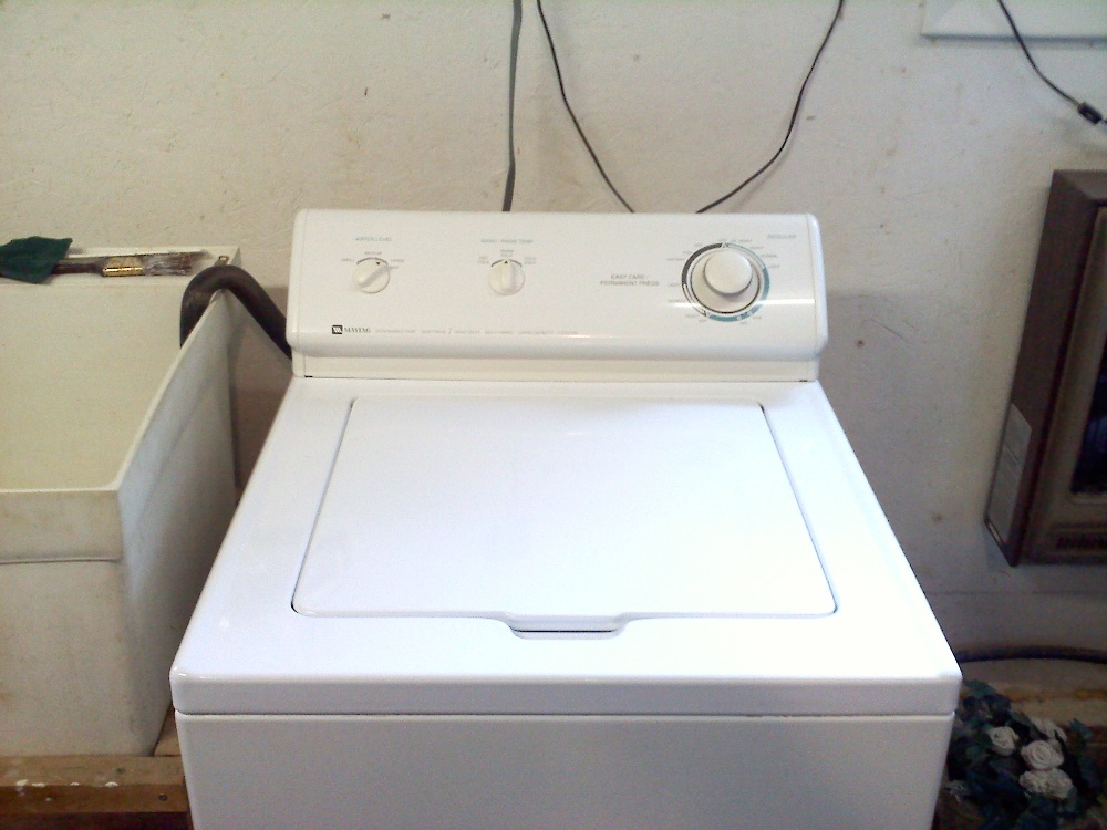

So, score one for me! Woman at work purchased a new set of front loaders and I happend to ask what she was going to do with her old set and what kind they were. She told me that they were Maytags about 10 or so years old, and that the dryer was already gone...and the washer was going to the landfill! I asked if anything was wrong with the washer and she said..."nope, not a thing." I grabbed it up today for free! After cleaning out the most digusting looking softner cap, I gave it a trial run, and it runs awesome! My wife seems to think its "old" and "small". I've already made a bet with her that it will outlast the 2 year old Front loader Duet we have. This Maytag was built in 1997, BOL. I've put it out in the garage....Here's some pics.

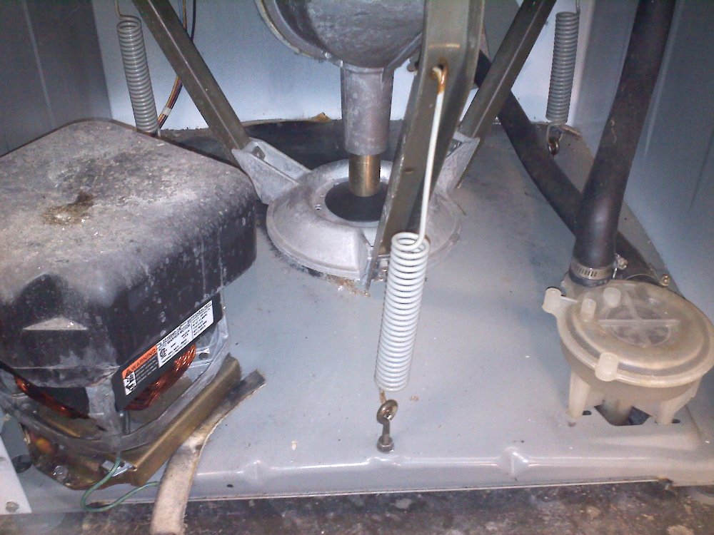

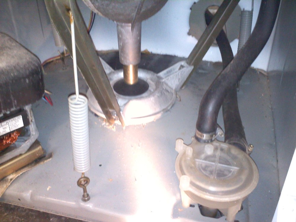

Post# 546814 , Reply# 15   10/1/2011 at 19:28 (4,589 days old) by aaronfitzy (Pennsylvania)   |   | |
Post# 546816 , Reply# 16   10/1/2011 at 19:31 (4,589 days old) by aaronfitzy (Pennsylvania)   |   | |
Post# 546821 , Reply# 17   10/1/2011 at 20:34 (4,589 days old) by kenmore700bill (Lodi NJ)   |   | |
Post# 546845 , Reply# 18   10/1/2011 at 22:37 (4,589 days old) by appnut (TX)   |   | |
Post# 546883 , Reply# 19   10/2/2011 at 08:31 (4,589 days old) by redcarpetdrew (Fairfield, CA)   |   | |
Those are the damper pads or at least one of them. This is normally a very bad thing to see BUT since I don't see any black dust (otherwise known as ground aluminum damper), you might have gotten off lucky but this needs attention NOW before you use it any longer!!! Time to put on new pads before that damper starts rubbing on the zinc coat base frame and causing a very nasty problem. Look carefully for the dust. If it's there, this gets more fun although it's not terminal. I'm looking at the pics with an iPod touch and may be missing it...

Post# 546887 , Reply# 20   10/2/2011 at 09:06 (4,589 days old) by aaronfitzy (Pennsylvania)   |   | |
Post# 546893 , Reply# 21   10/2/2011 at 09:53 (4,589 days old) by yogitunes (New Jersey)   |   | |
Post# 546902 , Reply# 22   10/2/2011 at 11:52 (4,589 days old) by goatfarmer (South Bend, home of Champions)   |   | |
Post# 547556 , Reply# 23   10/5/2011 at 04:49 (4,586 days old) by beekeyknee (Columbia, MO)   |   | |
I see black dust. You've got a problem. That machine needs to be disassembled and the damper pulled out. If the underneath side of that damper is scratched up it will need attention or replacement. The damper pads will need to be replaced with high temp. adhesive and lubed with poly-lube. This is a big chore. Hope you're mechanically inclined. Start doing your research. Good luck. It's not as free as you thought it was. Sorry.
Post# 547577 , Reply# 24   10/5/2011 at 07:41 (4,586 days old) by combo52 (50 Year Repair Tech Beltsville,Md)   |   | |
You can keep using the washer but if you would want to repair it as Andrew said do it now. We have customers that use MTs for years with bad dampers and as these washers are a dime a dozen, or even free you may not want brother fixing it when it gets too bad to use. You still will have lots of good parts left for the next MT Helical drive dependable care washer you find.
