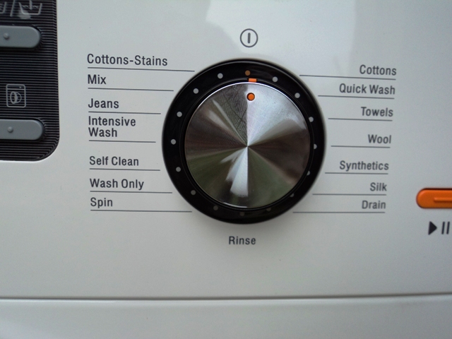

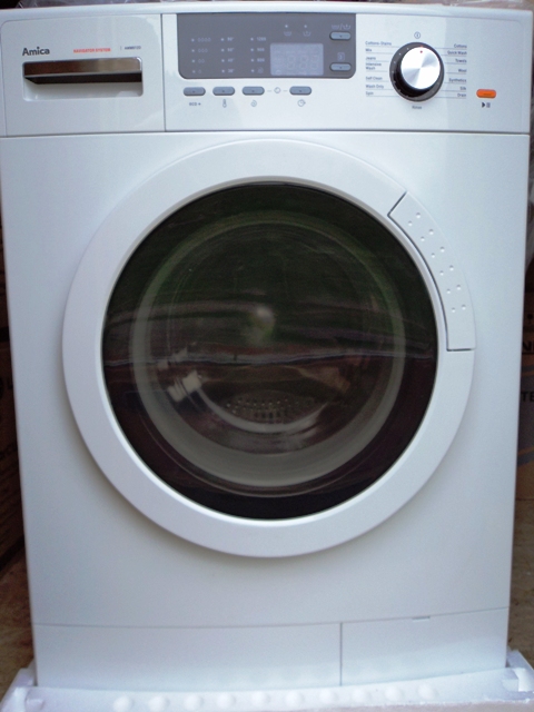

Well I finally took delivery today of the Amica AWM612D. I've not had time to bring it in yet to test it but i've got some observations so far.
Firstly it comes well boxed. Not in a shrink wrap polystyrene outer that falls apart like many machines but a proper box with strapping so you can carry it and even rebox it if you want. The build quality seems good for the price of the machine. It feels fairly sturdy and the controls are well laid out and don't feel like they will drop off in your hand. The door is solid and easy to open with that huge handle. I've looked at the instructions and there are some interesting features: 1.You can alter the water levels of the wash manually 2.You can open the door after the wash has started by pressing a button that instantly unlocks it if safe to do so 3.It has power failure memory. Very annoying having a machine that doesn't if the power cuts off 4.It has a self clean program at 90 degrees to perform a maintenance wash 5.Wash times seem pretty good at 1 hour 23 mins for cottons 60 and 57 minutes for synthetics 40. 6.Also there is a wash only program so you can do a wash and not have the rinse or spin. Quite unusual. So when I get time this week (if I do get time!)i'll try and get a wash done in it. Here's a couple of pics anyway. Steve |

A very nice machine Steve.
We have sold quite a few of these lately. Like you say a very solid construction unlike any other Amica washer we have sold. It just seems to stand out from the rest. 1200 spin & 6kg load & a nice retail price & with a 2 year guarantee. If i was ready for a new washer i would snap this one up right now! |

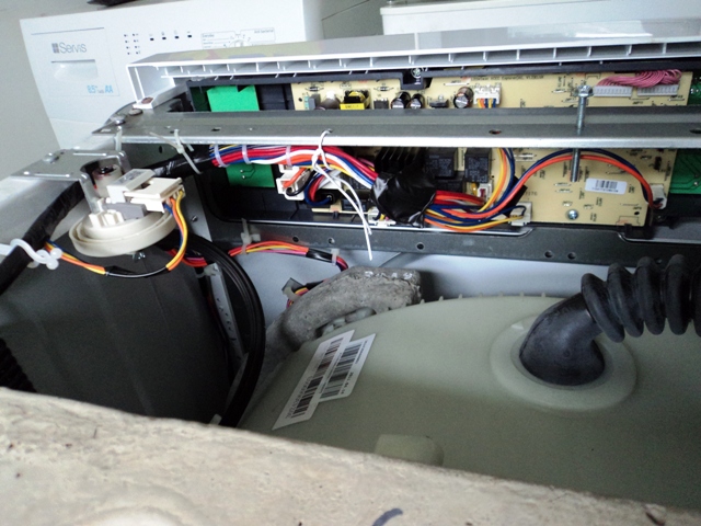

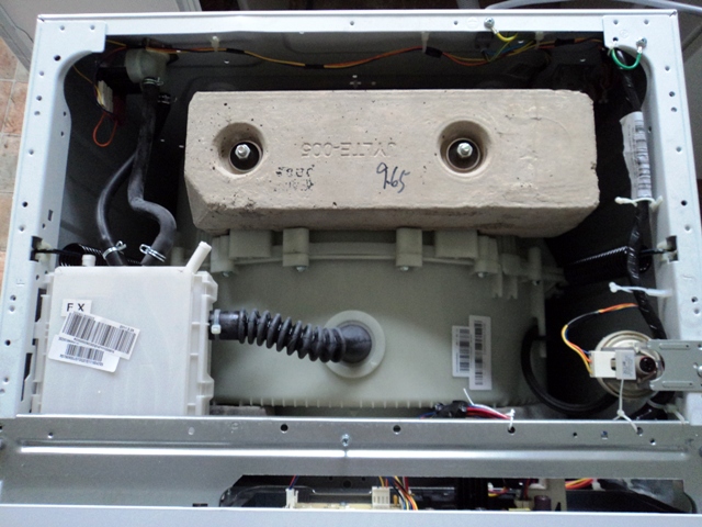

Post# 549232 , Reply# 10   10/14/2011 at 04:07 (4,570 days old) by zodawash (Lincolnshire,United Kingdom)   |   | |
Yes it's good to have a split tub rather than the sealed tubs we keep seeing which writes a machine off if you have a bearing failure or something stuck in it that you can't get at through the heater or sump holes. No, this machine is not replacing the Servis, it's purely a test machine only. I may have one in future but it would be an 8kg version as 6kg is too small for me anyway. I've got to wait a bit before the 8Kg comes out. I don't have the Beko anymore I sold it some time ago.
