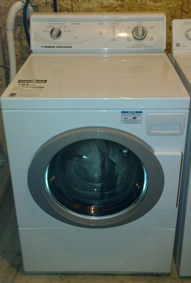

Post# 553761 , Reply# 1   11/3/2011 at 02:49 (4,550 days old) by qualin (Canada)   |   | |

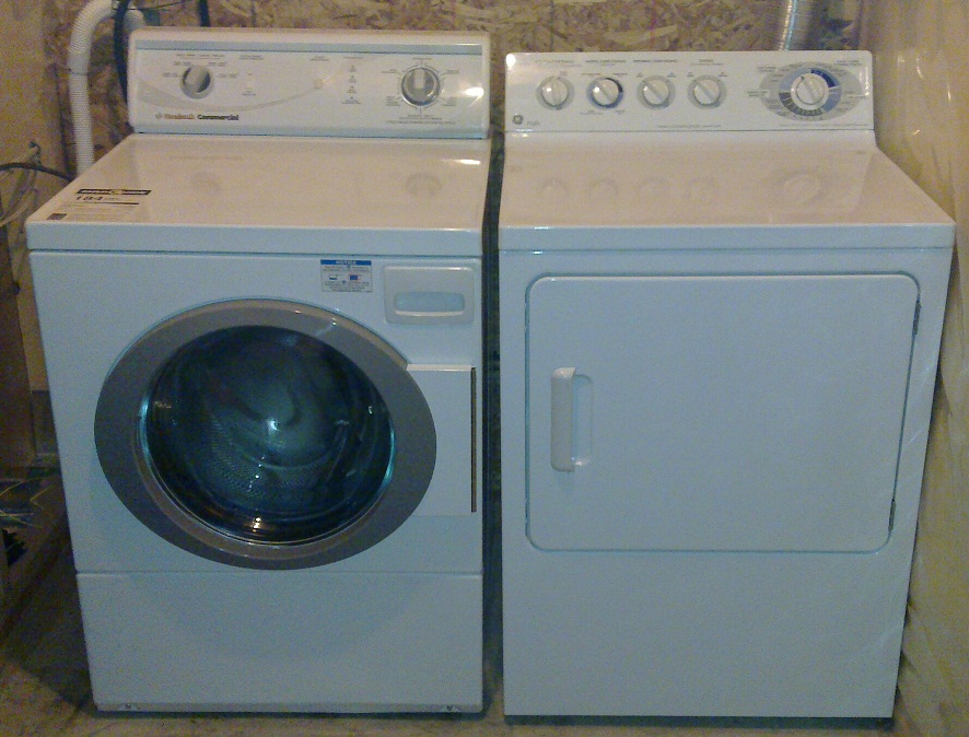

Here it is next to my GE Dryer, which will eventually be replaced with the matching Huebsch dryer, which I believe is the ZDE4BR. Notice how much wider the dryer is as opposed to the washer... |

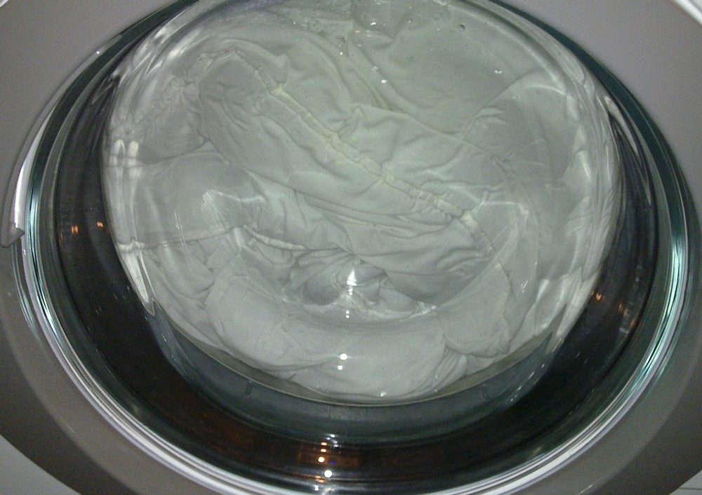

Post# 553763 , Reply# 3   11/3/2011 at 02:55 (4,550 days old) by qualin (Canada)   |   | |

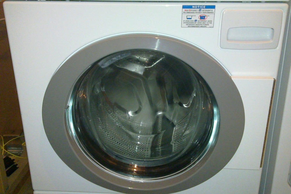

Here's a nice close up of the front. Don't worry, the condensation on the glass is from the washer being outside. The rim of the door is plastic, but the glass is nice and thick, no plastic there! |

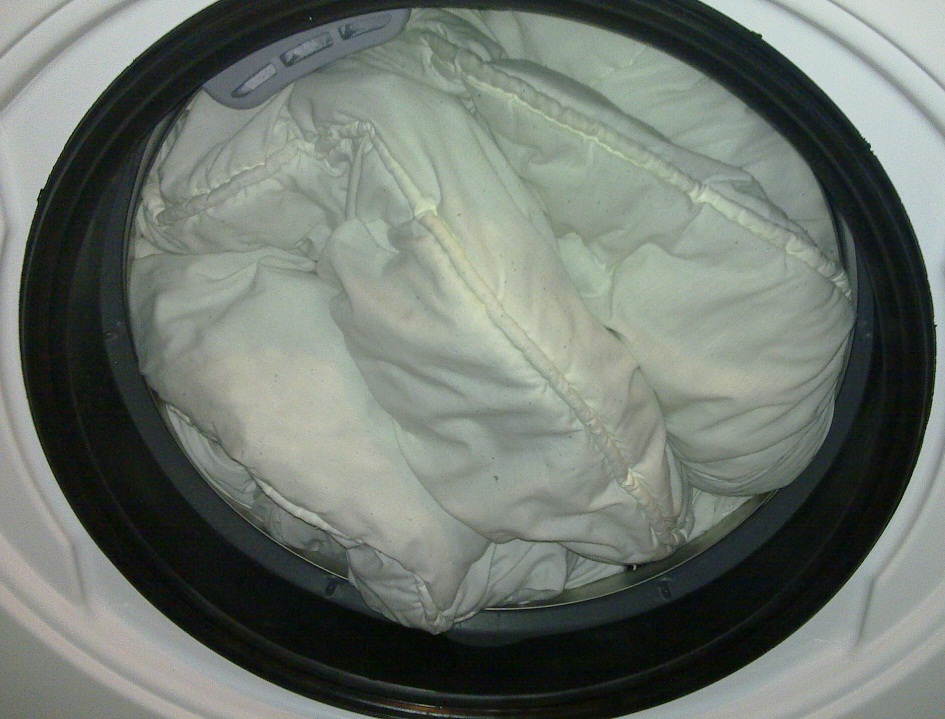

Post# 553766 , Reply# 6   11/3/2011 at 03:03 (4,550 days old) by qualin (Canada)   |   | |
Here's the same comforter with the door closed. I had to hold the door closed to get the machine to start, otherwise the door light would flash. They really do build these things tough. |

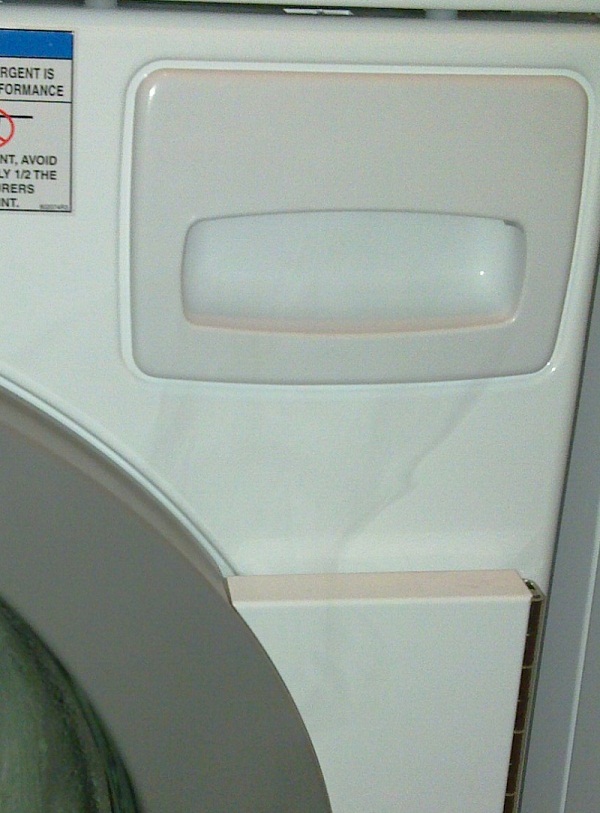

Post# 553767 , Reply# 7   11/3/2011 at 03:05 (4,550 days old) by qualin (Canada)   |   | |
Here's some water vapor coming out of the soap dispenser. I washed the comforter on the hot setting. My water heater keeps the hot water at about 80 C. I thought it was kind of neat to watch. |

What on earth?
Is the machine perfectly level? Check it with a spirit level......and, silly as this sounds, are all the transport bolts out?
As for the rubber feet stopping it moving, be prepared to replace them on a regular basis as if the washer continues to 'want to move', they'll wear out fairly quickly..... |

Post# 554118 , Reply# 17   11/4/2011 at 16:21 (4,549 days old) by Launderess (Quiet Please, There´s a Lady on Stage)   |   | |
A trick our Miele serviceman told us was to put all feet at their lowest point, then start the machine spinning. Then begin to raise each foot as required to the point where the machine stops moving about and is steady.
Reason for this was told that some flooring is not always totally even and despite using a level and obtaining side to side and front to back perfect readings the washer is still off. Tried the thing and it worked. This was after days of pulling one's hair out releveling again and again to get the Miele from shaking. As for detergent: If you have non-HE detergent you want to use up go ahead, but if buying new I'd stick to "HE" or at least detergents that do not create much froth and or are easily rinsed. The difference between using something like non HE "Tide" versus "Persil" is night and day. With the latter rinses are almost always clean by the second or third cycle. The former can sometimes still have problems after the fourth. However then again my Miele only spins after the third rinse in "normal" so maybe that has something to do with it. Oddly enough when using vintage detergents such as the box of "Gain" in my stash the wash water is clear and the rinses are as with Persil or any of the other European detergents in my stash. Am guessing that the older Gain formula has phosphates instead of being laden with Zeolites, washing soda/soda ash and other fillers. |
