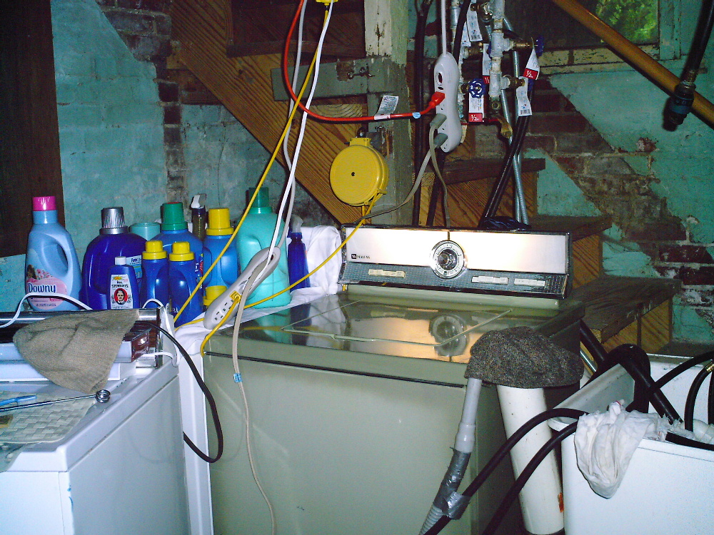

this is the setup I did when I set up my laundry studio
It is not seen in this pic but behind the 806s there is another pipe that the 806s and the 606s drain into Also not seen in the pic but the Calypso washer I have it is to the right of the laundry tub and I stretch the drain hose over to it as well |
Post# 559118 , Reply# 13   11/25/2011 at 12:07 (4,535 days old) by yogitunes (New Jersey)   |   | |
I would run 2inch pipe around the whole wall, and fall right into the laundrytub.....just add 12inch risers with "T"'s as needed, and allow each machine to have their own pipe.....
I think Combo52John has 8 or 10 machines in the warehouse hooked up like this along one wall, during the washin we had almost every machine running at the same time....plus they had a few portables running into the sink also.... I have 5 machines running into one drain tub, and sometimes 2 or 3 do all pump in at one time, as long as your drain line is clear, there should not be an issue in the pic is Johns warehouse, which is a great place to visit, thank you John, and on the left you can see the pipe running along the wall, with risers and several hoses in each one...running down to the laundy tub, and emptying into that! |
