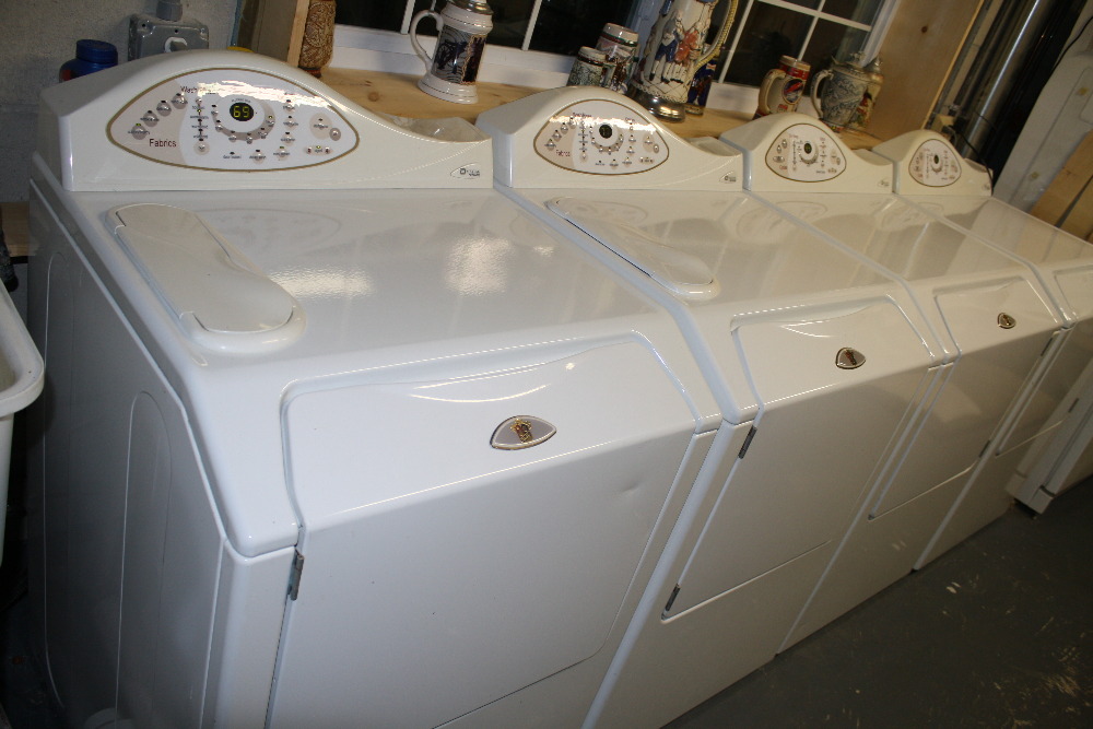

Post# 560259 , Reply# 9   11/29/2011 at 19:25 (4,530 days old) by fordtech ()   |   | |
I love my Neptunes, and have enough parts to keep them going another 15 years. By then I wont care what I have as Ill probably be too old to care. |
