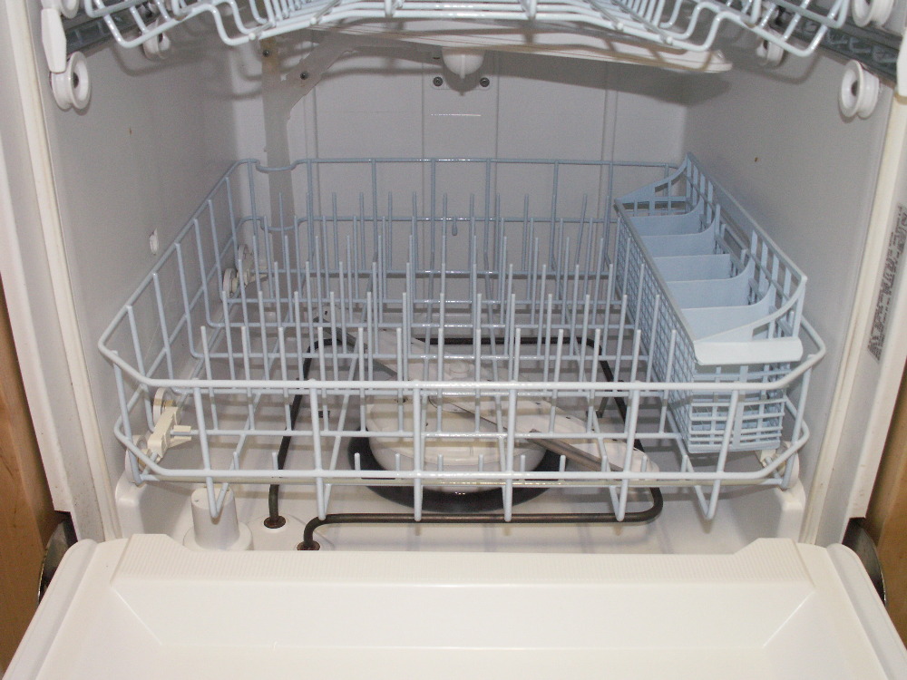

Post# 562278 , Reply# 2   12/9/2011 at 23:26 (4,514 days old) by roto204 (Tucson, AZ)   |   | |

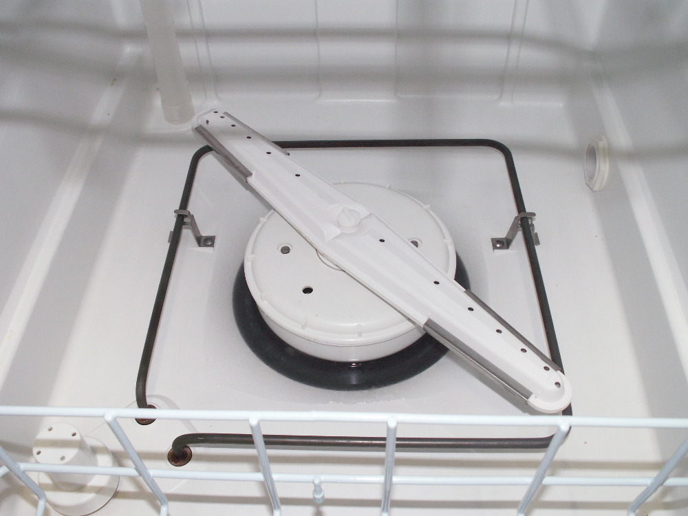

Let's check out what was going on below.
A departure from the tried-and-true stainless-steel wash arms led to plastic ones that needed help dodging the heat from the element, that now ran in a square around the bottom, rather than in a circle. Thus, metal plates were fitted to minimize melting. (I could tell this machine was not often used with the heated dry; many of these machines that were have partially melted arms.) A newer, flatter sump meant less water needed for a full fill, but led to other unanticipated side-effects like bits of food debris that would lay on the bottom, rather than sweeping naturally toward the pit of a deeper pump sump. You can see the large vent for the blower to the back-right. Addition of a tinier, more energy-efficient motor (so tiny and less-torquey, in fact, that the pitch of the sound varied as water surged to-and-fro) meant the need to ramp the wash pressure by decreasing the diameter of the wash-arm holes. So, the holes--which had been steadily shrinking since the seventies--now reached a new small diameter. Wash action was actually excellent in this during my testing, and all things being equal, I was quite satisfied (food trash in the bottom notwithstanding). But two issues arose from this configuration: 1.) WCI put a bull-honky "soil separator" (the large, white apparatus beneath the wash-arm and above the pump intake) in place, which supposedly centrifuged soil and flushed heavier particles down the drain. In reality, if it worked at all, only things with the density of gravel and neutron stars settled out before being forced up through the wash arm; the manual included explicit instructions to periodically twist the now thumb-operable wash-arm nuts off, and run the wash arms under the tap to dislodge chunks of food that invariably clogged the now tinier holes. When's the last time you were asked by the manufacturer to remove and clean the arms on a weekly basis? Of course, the documented bug becomes a feature. 2.) The macerator/non-filter configuration persisted, which destined debris for the wash arms like Barbra Streisand to musicals. Invariably, the corner jets suffered first, and coaxing a chunk of crud back out of the arm with only running water was tantamount to solving those little BB puzzles we had as kids. On the bright side, this may be the only D&M design that didn't sport the standard carmine patina of rust around the bottom. |

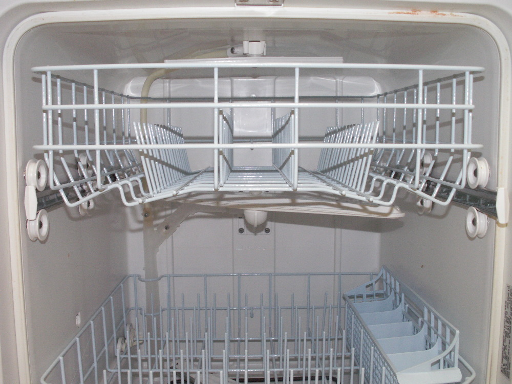

Post# 562279 , Reply# 3   12/9/2011 at 23:31 (4,514 days old) by roto204 (Tucson, AZ)   |   | |

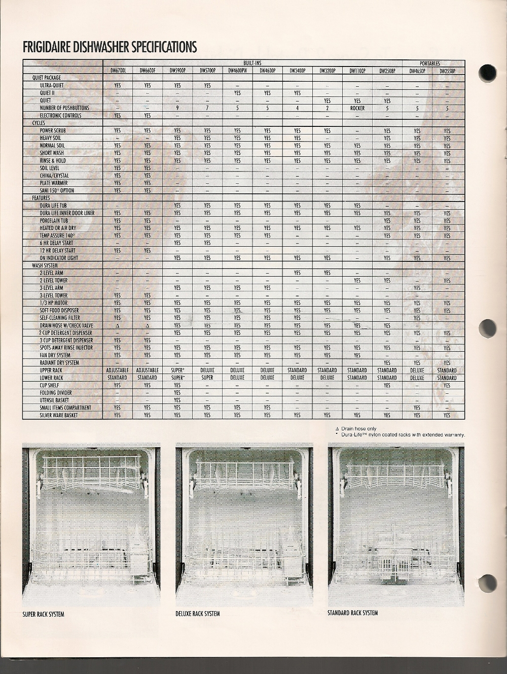

This top rack--part of the "Deluxe" and "Super" rack lineup now offered by Sears and WCI-Frigidaire--was arguably the only logical top rack ever offered. The Roto-Rack was fun, but some of the square rack designs either had bizarre loop-times, completely oddball removable sections--or best of all, both.
This rack was deep, had high sides to keep dancing plastics in place (always a good trick in a D&M, wherein your best bet for anchoring Gladware was a brick), and offered usable rows for glasses on both sides. Note the thumb-twist on the middle wash arm--only the top had a non-quick release arm, held in place with an otherwise quick-release Phillips screw. The nice, big wash arm did a good job of cleaning up top, and would have even dodged odd-sized items and cookie sheets in the bottom rack, if you would have been able to close the door in the first place. |
