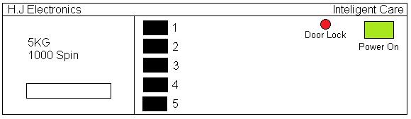

An LED indicator showing when the water heater is on or not would also be great. Are you assuming cold fill only or cold and hot fill? (What is the standard in UK ? Is it still cold fill only?) |
Post# 563547 , Reply# 7   12/16/2011 at 11:23 (4,485 days old) by HotpointFan (United Kingdom)   |   | |
"You first dial could be labelled "Cycle Type". Settings would be "Normal", which would be a 20 min wash and normal agitation and "Delicates" which would be an 8 min wash and short stroke agitation. You would also add the Rinse & Spin and Spin Only Cycles to this dial. "
This is always just about on every European machine, and the same for the temperature/spin etc. Hunter: Generally in the UK all new machines are cold fill only. Nice idea Henry! Will this be for the Zanussi? Jacob |

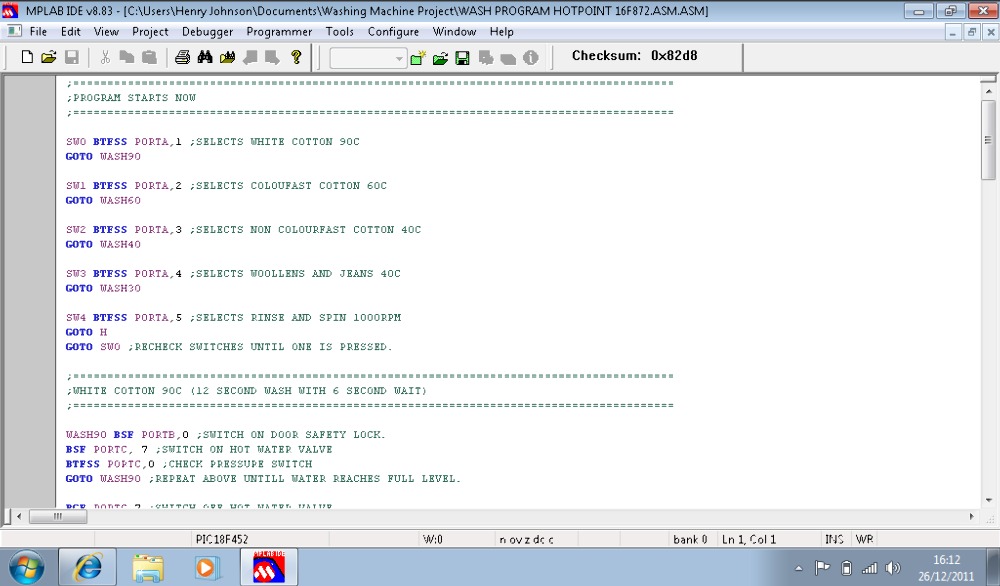

Post# 563808 , Reply# 12   12/17/2011 at 22:11 (4,484 days old) by supremewhirlpol ()   |   | |
In general I HATE C! I'd probably do the programming in C++ or Assembly. |

Post# 565267 , Reply# 16   12/26/2011 at 10:15 (4,475 days old) by henrypeter21 ()   |   | |
Photo of the software i am using (MPLAB IDE V8.5) to compile my programs and a small sample of the code... |
