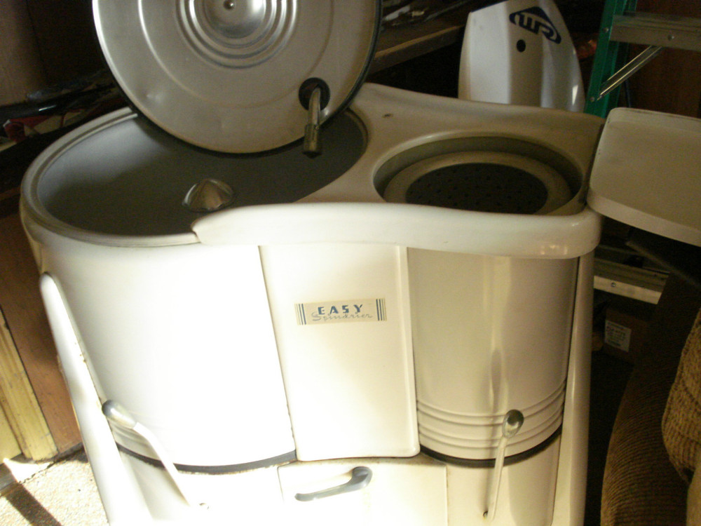

I just picked up this Easy Spindrier, and after going over it, I could use a new drain hose and belt. It is also leaking some oil from the drain plug, and I was wondering if anyone knew what type of oil I need to replace it with, as well as about how much. Any other info on it anyone may have would be cool too!
Post# 592736 , Reply# 1   4/28/2012 at 20:06 (4,373 days old) by stan (Napa CA)   |   | |
Post# 592767 , Reply# 2   4/28/2012 at 22:49 (4,373 days old) by arbilab (Ft Worth TX (Ridglea))   |   | |
At one time not that long ago we almost had Easy years nailed but those threads are archived and a major chore to search/recall. Beside years there were ~4 levels of features making it all the harder to just look and tell.
That machine looks very nice. The center panel--painted not porcelained--tended to rust but that one was cared for. I've never seen one without so much as motor stop/start buttons on the panel. Many have a timer but it only rang a bell, didn't control the machine. It doesn't have the chrome 'racing stripes' on the tubs which I think makes it later--just before they went to the central controls from the 'gearshift' levers, and BOL because no switch or timer. If I could poof a working antique washer into my life it would be a Spindrier or the more-compact 1973 Panasonic version of it. |

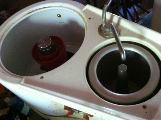

Hi! I think the oil leak sorted itself out. It seems that when I put it on it's back to move it, the oil came up and out the filler. Now that it has been standing upright and I've used it, there is no more oil leak. The drain hose screws up and down, blocking or unblocking the water flow. However, I'm a little hesitant to run it with it closed, so the pump will not run dry. It is good to shut off and put the lid on. I've run 5 loads through, and everything seems to be working better and better as it runs.

There was oil leaking out of a drain plug in mine when I transported it, so that's how I knew there could be a problem. There is a big drain plug on the right, rear side of the spinner. It looks pretty much exactly like an oil drain plug on an oil pan of a car. I just filled the oil up to where it started to come back out. After that, it ran quieter. I did figure out that the pump will always run, since it is directly hooked up to the belt/drive shaft of the motor. I have been leaving it on to recirculate the water, because I don't want it to run dry and possibly chew itself up. |

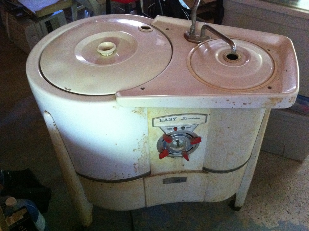

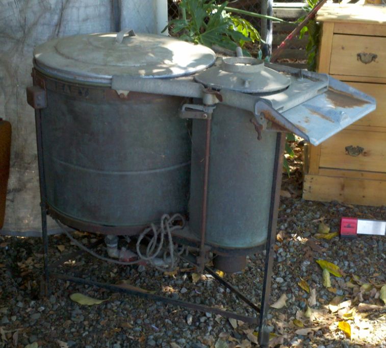

Post# 597221 , Reply# 23   5/17/2012 at 23:06 (4,354 days old) by arbilab (Ft Worth TX (Ridglea))   |   | |
Welcome Alex. I'm sure someone here would be interested in it as a washer rather than a planter. There are only so many of these to go around. 'Murray' would make it one of the last US versions. As I understand it, the design continued in Mexico years after it was discontinued here.
Can you post some photos of it? Photos always increase interest. |

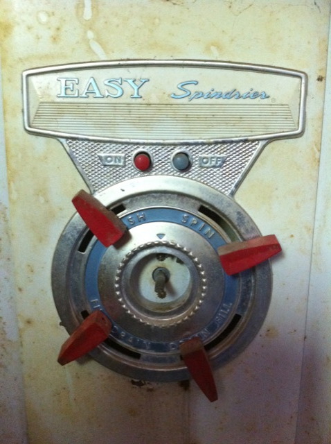

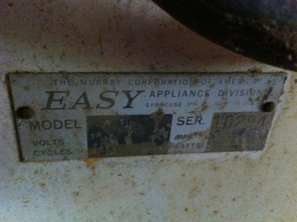

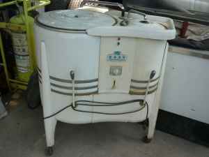

Post# 597990 , Reply# 25   5/21/2012 at 13:17 (4,350 days old) by BlastFromDaPast ()   |   | |
And another photo... |
Post# 597991 , Reply# 26   5/21/2012 at 13:21 (4,350 days old) by BlastFromDaPast ()   |   | |
And a shot of the selector dial... |
Post# 598000 , Reply# 27   5/21/2012 at 14:33 (4,350 days old) by arbilab (Ft Worth TX (Ridglea))   |   | |

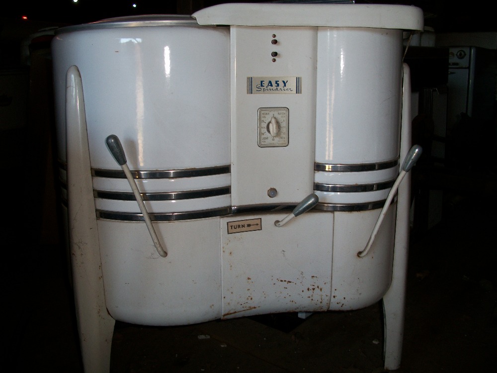

Grandma's had the gearshifts and the chrome racing stripes. One spigot, which connected to and controlled by the sink. Drain hose with a ball valve in the end if you wanted to fill the spinner.
Besides deciphering the years, there were 4 feature lines in all the later years. Grandma's had no timer. TOLs had 2 speeds. BOLs had no spigots at all. |
