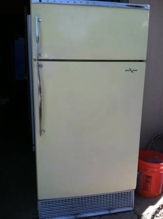

The fridge is the star of this ad on Craigslist.  I've never seen this model before.  It has my favorite SR logo.  If I had the room, I'd grab it.
Posting a picture here for the archives.

if it were on the east coast. :) It matches our stove perfectly!

Is that color a pale yellow? It's hard to tell from the photo.

This was a very good refrigerator that was built in the 1962-4 era, this was a time period that Whirlpool really started to hit their stride of building great refrigerators that continues to this day. But if you are considering putting a Frost Free ref into daily use that is this old you should first get a windmill to supply cheap power. LOL. And if you are a very good refrigerator technician you can change out the compressor, fan motors and defrost timer to make it considerably more energy efficient but you will still have a 50 year old ref. Unlike many of the cool 50 YO washers, dryers and DWs that are being found most refs this old have been running all 50 years of their existence and you will likely have interesting serious problems keeping it running properly.

Ooh, great looking frig - love the design and lines. Naturally, beauty....costs.
Post# 677816 , Reply# 5   5/7/2013 at 02:03 (3,997 days old) by washer111 ()
Very nice looking refrigerator - shame they didn't include extra pictures
Whilst I would change some parts of the refrigerator out, say condenser fans, and maybe defrost timers if it defrosts in excess of every 6-12 hours, changing the compressor out seems like asking for trouble. You may save energy, but the amount of money saved doing this ends up being defeated by the cost of doing it. I don't think replacing the defrost timer would save much, if any energy at all... Although that's just my personal opinion.
I think that whilst a number of older designs from the 70s and 80s (give or take a few years) could be efficient, or in-efficient. It seems to be dependant on the features and layout of the refrigerator, not to mention thickness of the cabinet and quality of insulation. Today, we're seeing better insulation, undersized refrigeration units and thermostats that can only be set "correctly" when tweaked "secretly" - which may explain the better efficiency, although it doesn't apply to all units, necessarily.

I think this fridge would be more efficient than its equivalent bottom freezer model.  Top freezer models typically were/are.  If it has the same defrost system as a BF, not only is there a heating element on the evaporator, but the freezer floor is also heated in the depressed areas that channel defrost water to the drain, which is located nearly in the center of the freezer floor.  The floor heaters often failed, and Sears provided a retrofit kit that consisted of a trough mounted below the evaporator with a flat tongue-like covered extension from the bottom middle of the trough that routed the water directly out to/over the floor drain opening.  The entire trough assembly was heated by flexible cording that was connected to the same terminals behind the liner trim that supplied power to the failed floor heater.

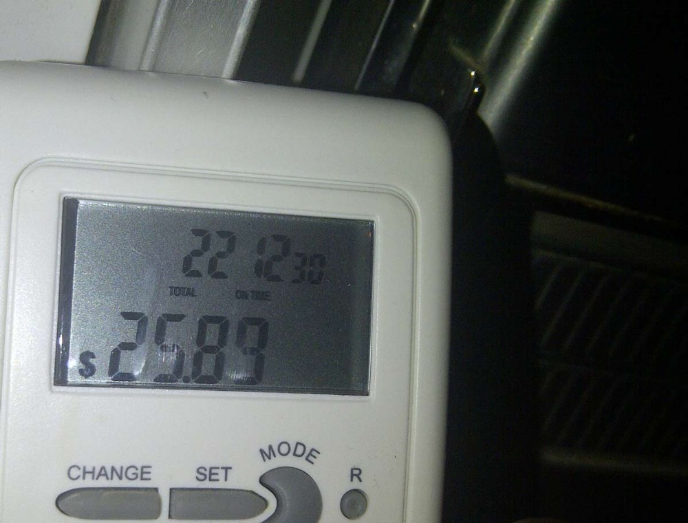

I have a Wattmeter installed on my 1963 Frigidaire 16 cu-ft bottom-freezer that still runs on it's original components (compressor, defrost timer...) since January and while it's not energy efficient compared to newer models, it's not that bad either. My current estimates for a year of operation is $102.53 at the rate of $0.075/KWh. So it should cost about $258.24 per year at the actual rates in NY state (the state with the most expensive rates), $170.88 per year in Maryland and $158.61 in the average US according to the chart in this link:

What would a nice, similar capacity model be using (based on EnergyGuide, or actually tested figures)?
I don't imagine  1/8 or 1/4 of the energy. Perhaps more along the lines of half? My calculations indicate approximately 1270 kWh per year, about 33% more than our Fisher and Paykel N388 (450L) Food Freezer, and about the same as a relative's Westinghouse "W I D E L U X E" (RJ545 or RJ454) from around 1992 which is quite small compared to your Frigidaire models.
It is using just over double our F&P C450 (Fresh Food) fridge's consumption, 545kWh a year (My values are government tested) from 1999 (Same as the freezer).
Combined, our F&P pair use almost 1500kWh a year - equivalent to AU$330 @ 22c/kWh - so your model isn't doing too bad, considering our freezer isn't exactly full (Lol). Both F&P models use a Matsushita Electric (Made in Singapore) compressor, the fridge uses a 300w heater and defrosts every 6 hours of operation. The freezer has a 900w heater and defrosts every 12 hours of operation (Timer cycles with thermostat). The freezer is set warmer than factory, since that is like -11.2ºF (-24ºC) - too cold. I've clocked it back to 0ºF (-18ºC). The fridge is just a tad colder than factory, which is perfect.
So really, some models from recent are worse than models from 40 years ago. VERY INTERESTING!

These were very solid performing refs in their day, but they not only use an excessive amount of power they are also the reason that No Frost refrigerators got a bad reputation for poor food preservation, running 70% of the time and for the way they heated up kitchens in warm climates. The freezer floor of the Sears TF ref was just a stamped piece of aluminum with  the evaporator coil directly under it and pressed into the evaporator coil was a 600-700 watt heater. This heater was turned on twice a day and heated this whole area to at least 50F and much warmer in some areas [ many customers reported saying it was hot to the touch if they caught it in a defrost cycle ] needless to say it didn't do the frozen food sitting directly on top any good.
The thing that does in these refs as time goes on is this evaporator sits in a galvanized steel pan and it gets rusted pin holes in it as time goes on [ Frigidaire has the same problem with both their TF and BF and upright freezers models from 1958-about 1970 ] this leads to a big mess when the defrost water keeps leaking into the insulation below for years, it is very difficult to fix. WP did not have this problem with their BF and upright freezer models.
As mentioned the bottom freezer version would be even a little worse in terms of energy use, mainly because of having a bigger freezer section and having the colder freezer section near the hot condenser, pre-cooler and compressor. And Phil R is correct that his Frigidaire is probably a good deal more economical to run that a WP built FF ref of this vintage, the FD has a static condenser and to FDs credit they almost always were more economical to operate that most other brands.
111 the single best thing to make an older ref like this more efficient would be to replace the compressor, the compressor in this older ref consumes at least 350 watts of power when running compared to just over 100 for the same capacity compressor today. From there you can reduce the condenser fan motors consumption from about 40 watts to 5-6 watts but using a state of the art new ECM fan motor, likewise the evaporator fan M can be changed from 25-30 watts to about 4-5 watts draw. The twice a day timer can easily be changed to once a day by changing the timer [ I did this hundreds of times over the years ]. If you wanted to be a little more clever you could do as my Brother did years ago and use a 7 day timer and have the refrigerator only about twice per week, he and his partner did this for over 10 years on their primary ref [ a 1966 WP TF model ] Other things that could be done would be switching off some of the anti-sweat heaters if you lived in a dry climate and in the case of a ref like the Sears CP in question that has only fiberglass insulation you could pull the liner out and replace much of the fiber-glass with foam slabs of insulation.
But as this Cool Old Sears ref stands it easily uses FOUR times the power of a new 16 cubic foot ref and would not keep frozen or fresh food nearly as well. And since WP went to their current ref designs 20 years ago [ all foam cabinets and doors ] these refs are holding up much better than the 1960s-1970s ever did, I have little dough that the current simple TF models will easily last in excess of 30 yeras if given reasonable care.
