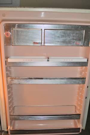

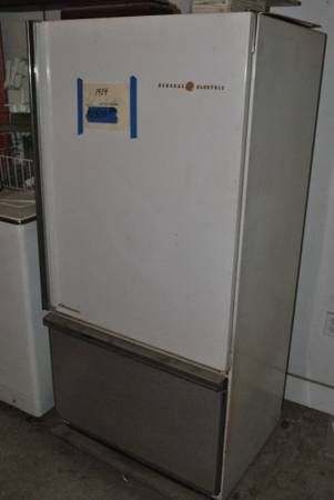

....It appears to be more complete than usual, I'll give it that - the egg trays (white plastic, on the door shelves) and meat pan (anodized aluminum, seen on the top shelf in the interior shot) are present. Can't tell if the glass trays are present in the butter and dairy compartments, nor if the ice trays (aluminum lever-style) are in the freezer.
This is a 1957 Combination, not a '54. So far as the pricing is concerned, good luck with that. A photo for the Archives is below: |

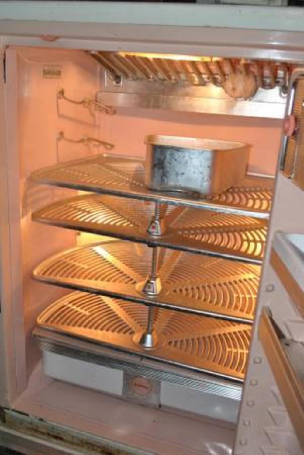

And there's a giant wad of ice on the serpentine coil towards the back, why? And the pan underneath it, why?
Who knows what the freezer looks like? The mullion down there looks pretty funky.
I've pretty much quit, but for those times when I'd prefer to escape from reality, I'd like to have on hand some of whatever this seller is smoking. |

Anyone who knows something about refrigeration knows that glob of ice on the food compartment evaporator means "works great" ain't necessarily so. I saw lots of those GE's with the same or similar uneven frost pattern. Most of them were the "newer" models with the condensers at the bottom as opposed to being on the back. They were usually clogged with kitchen grease (which I blame on the electric fry pan craze) and lint. The GE wall fridges were the same. That uneven frost pattern was an automatic trip to the scrap heap, regardless if the refrigerator looked as nice as the one in June Cleaver's kitchen.

Post# 698050 , Reply# 16   8/22/2013 at 05:33 (3,898 days old) by danemodsandy (The Bramford, Apt. 7-E)   |   | |
While it's up on the top shelf to catch drips from that ice ball, that pan is the meat pan, often missing from these fridges. It's supposed to go on the bottom shelf, and its bottom is contoured to fit the flange of the support post for the turnaround shelves.

Post# 698090 , Reply# 17   8/22/2013 at 10:10 (3,898 days old) by Tomturbomatic (Beltsville, MD)   |   | |
When the serpentine coil defrosts, the water is suposed to drip into the little gutter underneath the coil; obviously the ice ball won't. If only part of the coil is frosting up, it could have a Freon leak. |
