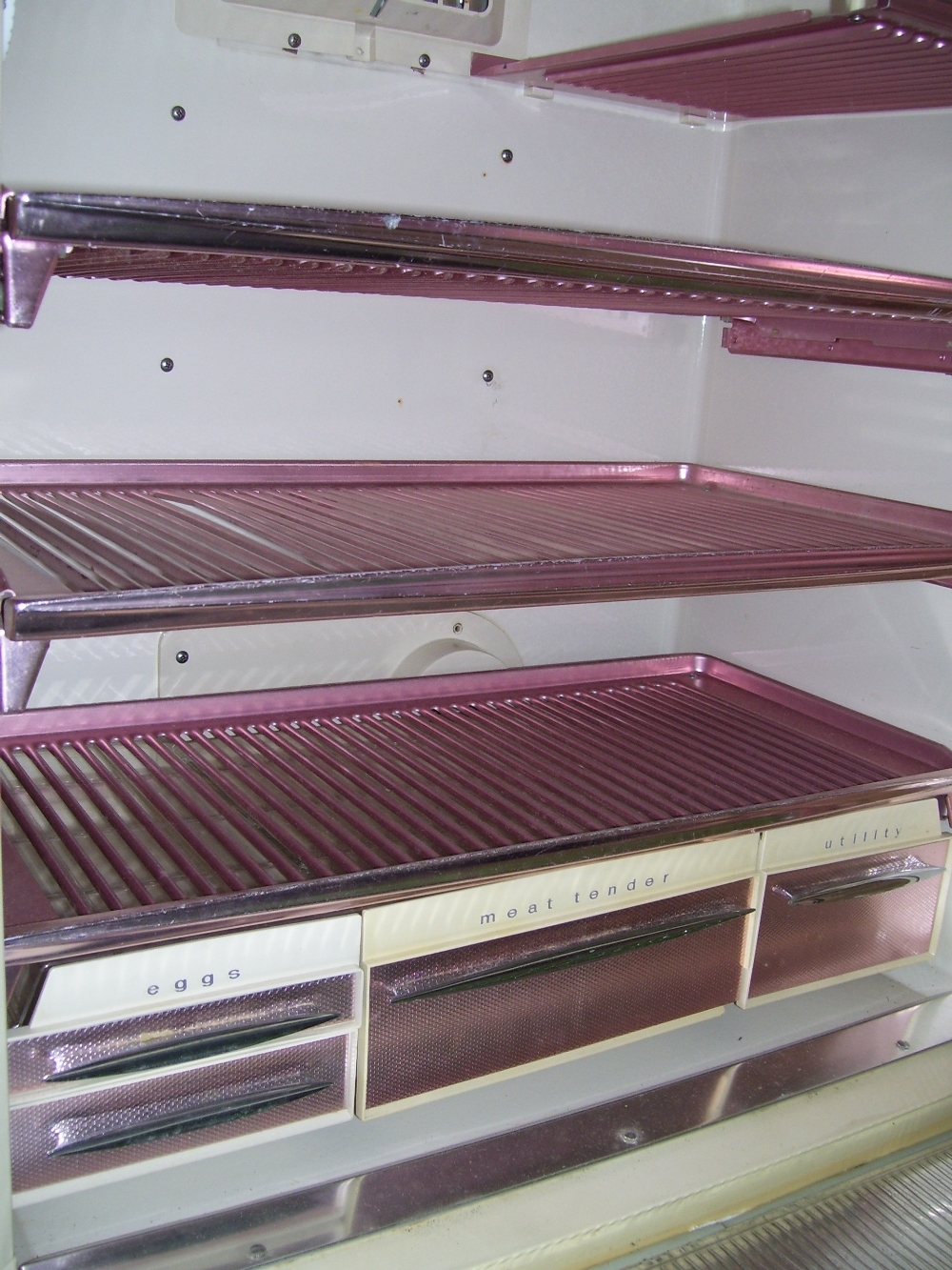

Post# 705799 , Reply# 4   9/27/2013 at 21:38 (3,862 days old) by moparguy (Virginia)
My Imperial Cold Pantry, in her magnificent porcelain finish!
Post# 705800 , Reply# 5   9/27/2013 at 21:39 (3,862 days old) by moparguy (Virginia)
And the beautiful pink interior!

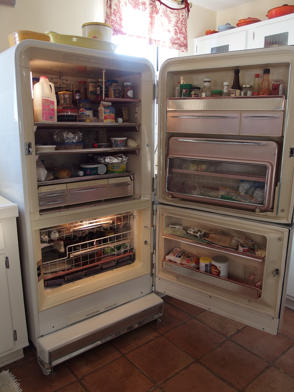

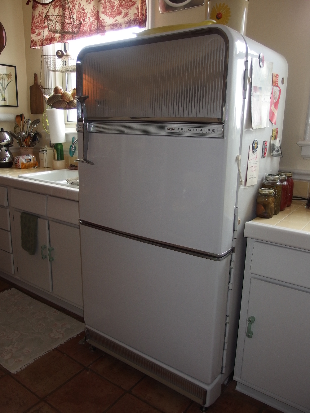

Post# 732410 , Reply# 10   2/2/2014 at 00:17 (3,734 days old) by beezus9 ()
I have a gorgeous CP-120-56. Sadly it just stopped cooling. Could be the starter, but I think it's the compressor, as it was making "struggling" sounds for several months before it conked. So I'm searching online for parts. Any help would be very much appreciated!
Photo is my fridge. YouTube link is my model in a vintage commercial!
CLICK HERE TO GO TO beezus9's LINK
Post# 732437 , Reply# 11   2/2/2014 at 08:13 (3,734 days old) by toploader55 (Massachusetts Sand Bar, Cape Cod)
Love that commercial
toploader55's profile picture
And that fridge...
Love the Produce Center in the door. To have appliances like that again.
That must have been filmed somewhere on the east coast. The Stangl "Thistle" pattern Cassarole was made in Fleminton, N.J.
My Mom had that pattern

Do you know if your fridge was already repaired/restored in the past?
I'm assuming it still has it's original sealed refrigerating system but it's good to know something about it before you have any service done to it.
If your rotary compressor is dead, it could be converted to a different compressor but that requires some time and modifications. I think you'd need to have a tech check it first to know exactly what caused the failure and to see if it stil holds it's charge of refrigerant. In any case, be prepared to face costly repairs. Be sure to find someone who knows what he's dealing with... Repairing old appliances can be a bit like sending your pet to the veterinarian. A $15 cat can cost $1500 in surgery if you're willing to spend that money on it and you know it's not going to survive forever after...
Post# 732563 , Reply# 14   2/2/2014 at 20:47 (3,734 days old) by whirlaway (Hampton Virginia)
Does anything Capacitor start?
Does your compressor have capacitor start,they usually start to get weak and then go dead.Very seldom do they just stop working,like you say it sounded like it was strugelling.My washer did that,replaced the starting cap on it and it took right off. Good luck!!!!!

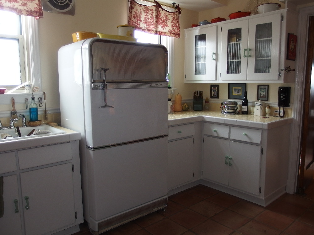

Post# 735410 , Reply# 17   2/15/2014 at 11:14 (3,721 days old) by trice4440 (saint louis, missouri)
Finally I have gotten around to some pictures. I bought it restored yet had to replace the "new" compressor after 2 years. I had a commercial refrigeration company do the work and they did an outstanding job. Very happy with my Cold Pantry!
And in response to defrosting, the new thermostat is a constant cut-in approximately 38 degrees, so the frost on the vertical Refrig-O-Plate melts off and runs into an electrically heated drain to the base. There is no set time, it defrosts when it is off.
Hope you like!

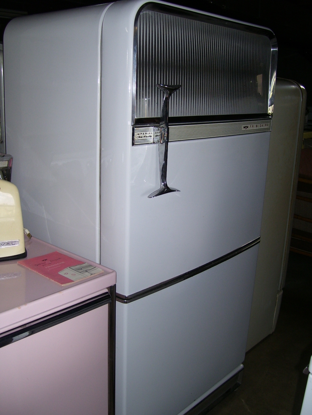

Post# 735413 , Reply# 18   2/15/2014 at 11:24 (3,721 days old) by trice4440 (saint louis, missouri)
another shot
Post# 735414 , Reply# 19   2/15/2014 at 11:27 (3,721 days old) by trice4440 (saint louis, missouri)
a rare piece
Post# 735415 , Reply# 20   2/15/2014 at 11:32 (3,721 days old) by trice4440 (saint louis, missouri)
inside
Post# 735418 , Reply# 21   2/15/2014 at 11:38 (3,721 days old) by trice4440 (saint louis, missouri)
an inside view

Post# 735423 , Reply# 24   2/15/2014 at 11:53 (3,721 days old) by PhilR (Quebec Canada)
philr's profile picture
Your kitchen is awesome!

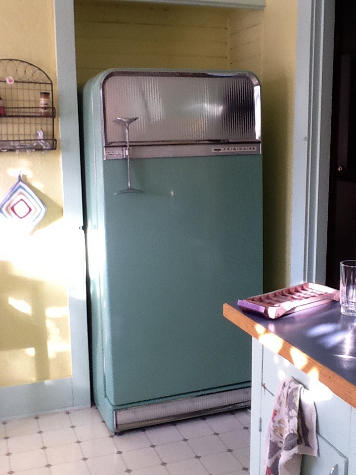

Post# 1085090 , Reply# 46   8/14/2020 at 19:15 (1,349 days old) by FLAT4NBRAIN (TIPP CITY)
Heres mine
