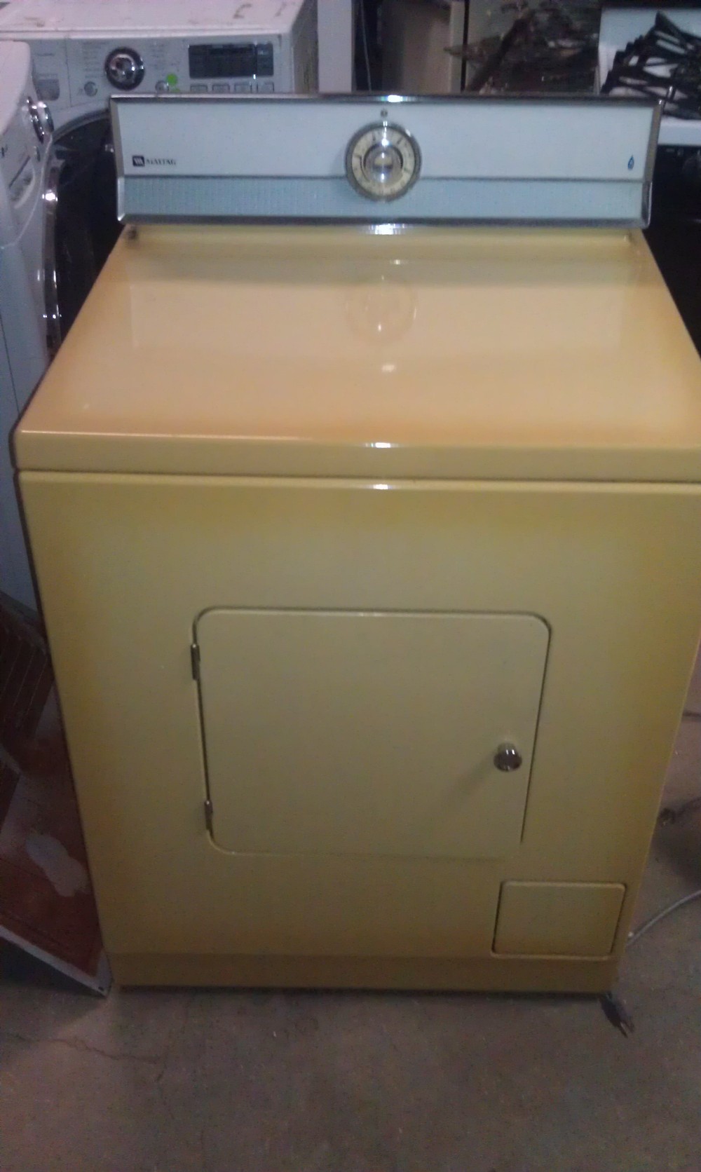

For sale: Maytag HOH Harvest Gold |

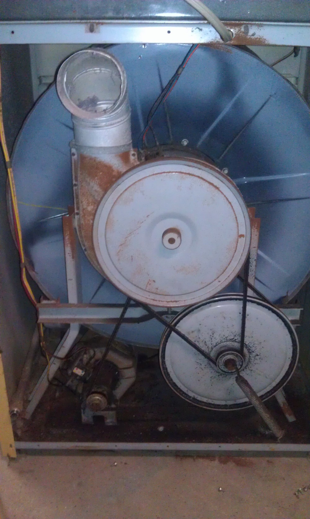

Post# 716970 , Reply# 10   11/21/2013 at 23:17 (3,780 days old) by combo52 (50 Year Repair Tech Beltsville,Md)   |   | |
There really was not much versatility on this dryer even though this was MTs first ever time-temperature auto dry dryer, it still offered NO temperature control, a VERY limited dryness range that could never dry any thing really heavy on the auto cycles, it also had a pathetic 7 minute cool-down on the Perma-Press cycle with no end of cycle bell.
Then consider the small capacity, inconvenient lint filter and a constant burning pilot light wasting gas and destroying the dryer from the inside out. Then consider the very poor safety design of having only one gas valve that if it should stick open the burner keep burning full force and would turn the dryer into an incinerator. These dryers also had the terrible design flaw that in they were run with a clogged vent or very full lint filter the machine would NEVER SHUT OFF on the auto dry cycles. When you compare this dryer to what WP, KM, GE and Frigidaire was building in the 70s I would rank this as one of the worst and most dangerous dryers made in this time period. |

Post# 717148 , Reply# 15   11/22/2013 at 20:33 (3,779 days old) by combo52 (50 Year Repair Tech Beltsville,Md)   |   | |
I listed the color as avocado K when it was clearly harvest gold so the model should have been HDG407.
Yes sorry for the slightly negative appraisal of this dryer, but remember that I worked for a Maytag Home appliance store in the 70s and we probably sold at least 50 of these dryers I am probably the only one here that has that much first hand experience with this dryer. Both of my bosses, Bill and Bob were really excited when MT finally offered a simpler auto dry dryer because the HOH Electronic Control dryers were so often a pain in the neck to repairmen to repair and to try to get our customers to accept. And Bill and Bob also liked the constant burning pilot dryers because they were easier to fix. Unfortunately we quickly had lots of problems with the DG-E 407 dryers not ever shutting off or unable to fully dry clothing on the auto cycles. I am not a MT hater and I have more than 10 pairs of MT laundry appliances in our collection, but I do like to share the good and bad points of the appliances I work with. I am just as quick to point out the faults of WP built appliances and many others. For example WP is currently selling a compact dryer built by Maronie in Italy that makes the MT HOH dryer look like one of the best dryers ever built and if someone came on the site and had found one of these terrible dryers I would share my experiences just as quickly. John L. |

Post# 719668 , Reply# 19   12/6/2013 at 20:35 (3,765 days old) by DaveAMKrayoGuy (Oak Park, MI)   |   | |
Were the insulating properties & other workings really that close to the drum area or in its vicinity, and did the smell in there between loads, really resemble Pampers actually HOLDING 40-Actaul Pounds of baby crap?! (Well, I worked in a hospital laundry so the big dryers there, along w/ the gas smell, would easily have that type of odor, and very hard to ever shake off!)
And ASBESTOS? Any likelihood of mesothelioma cases (the latest in lawyers' TV ads!) from this having to be settled in court?! Most likely the all-porcelain drum & cabinet (or at least top) were what made these machines recommendable (though Charles Klamkin in his book HOW TO BUY MAJOR HOME APPLIAINCES, recommending Maytag as "Best Regardless Of Price" and listed a Norge Electric & Gas model (most likely a Lg. Cap.) probably bought his wife the Norge! -- Dave |
