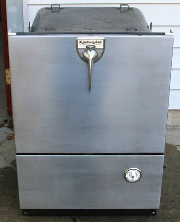

Post# 718100   11/27/2013 at 14:24 (3,773 days old) by Yogitunes (New Jersey)   |   | |
cool in stainless, and that bottom knob is unique as well as the handle with the start button....

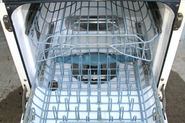

The KD-14 was the last model to have the cast-iron spray arm. There were 3 models, the custom (which is what is pictured above), the imperial (which I have in shaded coffee brown), and the very first Superba Vari-Cycle. The imperial and superba models have a two-position upper rack. Those models also have a "control panel" as opposed to the solid slab door that is on this custom. Martin, you are correct. The little stainless steel strainer is the detergent cup. That machine should be a water purge, then a 7 minute wash, followed by two rinses (each about a minute and a half). Each portion (purge, wash, rinse, and rinse) takes 2 1/3 gallons, approximately. |

If it works the same as the KD-2P, then the pre-rinse only fills the bottom of the tub - it doesn't spray water up into the racks. It's just to clear out any old dirty water in the sump, and I guess, pre-heat the pump and bottom of cabinet. It's perhaps also because there's no automatic detergent dispensing feature. A full spray pre-rinse would waste the detergent resting in the little strainer.

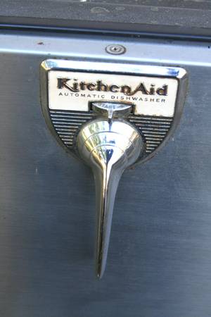

in the mean time I will add a cord, and plumbing to the valve....this stuff I already have......and we can set it on top of the portable and let it drain right into the sink... but that is one heavy little mug..... is that 'start' button a linkage or wired to the control knob to automatically start the cycle, or do you have to bend down and click it 'on'?..... and should there have been an insulation blanket of some sort wrapped around it?....although I am sure one can be added.... |
Post# 719456 , Reply# 22   12/5/2013 at 15:38 (3,765 days old) by william637 (Damp pants? Not a chance. )   |   | |
I am assuming the KDC has the same sort of two-part starting system as the others.
Turning the handle will throw a lever which in turn releases the timer knob "stop" positioner at off and advances it about 2-3 degrees. Basically, if you advance the timer manually, you can not advance it past "off" unless you unlatch and re-latch the door. The "start" button should complete the electrical circuit so everything will fire up. Once again, this is just a guess based on the other models. None of these units came with insulation. I wondered about that too at first, but the wash cycle is so short, there just isn't that much heat lost due to conduction with air around the unit - especially when it is embedded in a cabinet. And you are right - those are some heavy units. I took the drain pump on the stainless steel KD-12 apart the other night. The motor shaft turns freely, and there are no obstructions in the volute. I guess this means that the contacts are bad in the timer, or the motor itself is bad. If anybody else has some better trouble shooting ideas I am all ears. |
