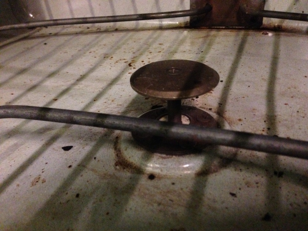

Here is the microwave sprinkler head in my 72 Hotpoint combo range. I love baking and roasting with microwaves, not difficult to adapt most recipes once you get a feel for the speed increase. I would estimate the output at equivalent to 450-500 watt range. Not fast for sure, but very adequate with the superb temperature control system GE used.
The oven needs a self-clean cycle but I needed to do the clock repair. That's done, but the cleaning still isn't. |

Greg, thanks for the photo of the antenna. I remembered many years ago John showed me one of these ranges but my memory was foggy.
I have to assume that they used a magnatron as the RF generator, but its odd to couple a magnetron's output into the oven cavity with a feedline/antenna system. At this low frequency though the waveguide would be very large though, a rectangular guide would be about 5" x 10" for example. Its also possible that they used some other form of power tube that could directly feed into the feedline/antenna. Today we could easily do 500 watts of RF at this frequency with 2 LDMOS transistors! It is possibly, although unlikely that these ovens could interfere with 900Mhz cordless phones (and intercoms etc). In ITU Region 2 (North and South America) the 900Mhz ISM (Industrial, Scientifie and Medical) band ranges from 902-928 Mhz. It appears that industrial heating was usually placed at 915Mhz. Cordless phones use 2 frequencies one going each direction to and from the base (duplex). These were always placed high and low in the band so they were ~12 Mhz on either side of the the typical heating frequency, probably far enough that interference would never occur. If anyone has a schematic or other service docs for the RF portion of one of these ovens I'd love to see it. I'm still curious why they picked the low frequency. One reason may have been that the shielding of the cavity is relaxed because of the much longer wavelength. There are likely cooking advantages too as the lower frequency will penetrate deeper into food, but I'm not sure how much difference that makes. |
