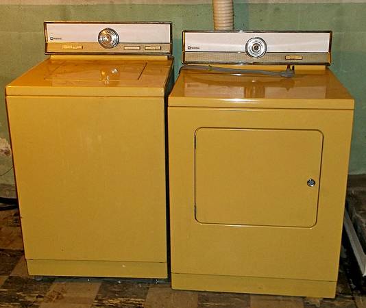

The price came down! Closer to what they're worth. CLICK HERE TO GO TO goatfarmer's LINK on Southbend Craigslist |

I blew the photo up, and it looks like that washer is an A208. That means:
- One speed. - Fabric-Matic delicate cycle (the washer agitates for a minute, stops for a while, agitates another minute, and so on, instead of using a low speed for delicates). - Three fill levels, Small, Medium and Large - Four wash/rinse temperature combinations: Hot/Warm, Hot/Cold, Warm/Cold and Cold/Cold. - Bleach dispenser - Softener dispenser - Non-lighted control panel My first Maytag was one of these, and it was a great machine. I presently have a TOL A806, and believe it or not, the A208 did everything the A806 does, though it does some things a little differently, like the delicate cycle. You would not be sorry you owned one of these. The problem, of course, is that South Bend, IN, is a long, long way from you. |

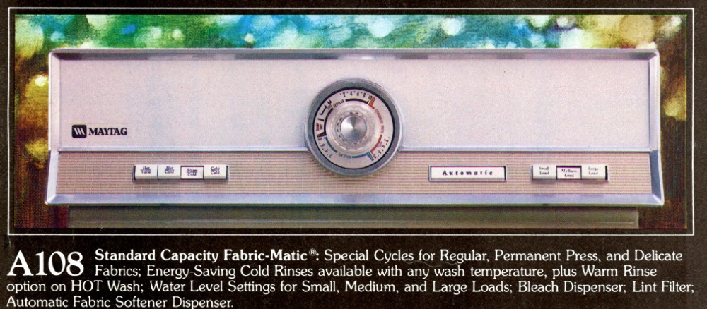

Sandy, the washer is an A108. The A208 was a two speed machine. This is a one speed-machine which was known "in the trade" as Fabric-matic. The lack of shading on the cabinets means these are from between mid-1977 to June 1980. Here is the console of the A108.
The dryer, surprisingly, looks like it might be a DE608. Somewhat unusual to pair a low-end washer with an electronic control dryer, but the presence of 4 buttons on the console points towards the 608 as opposed to a lower-end model. (During this time period only the the 608 and 808 had 4 buttons, the 308, 408 & 409 had two buttons and the 108 & 309 had no buttons

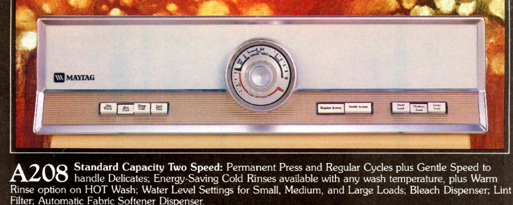

i have an A208 but it has 2 speeds on it (gentle & normal) agitation. could this mean that since it is a single speed, it is another model number? because mine is definitely an A208 and aside from the 2 speed, everything else you described, is exactly the same as mine. could it be an A108 (is that a model number?) i feel like a baby, just learning & learning, little by little. hm hm hm.... and i do LOVE my maytag A208. the only "con" i would have about it, is the tub size. i would rather have the extra large tub so when i need to wash blankets & covers. other than that, i love the verstality you have with the different choices!!! what would be the equivalent to my A208 but with the extra large tub size? rp2813: i have seen that "automatic" button on some pictures of the maytag washers and have always wondered what that meant or why that was? so is that just like a decoration button/plate or can the "automatic" button be pushed in? but just doesn't do anything to or for the machine? curious minds want to know. thanks guys. i look forward to reading your replies... |

thank you soooo much for posting the pictures of the control panels/consoles, of the A108 & A208.
GOSH! all of these model numbers is so confusing to me and i get confused trying to figure out what is what. at least, now i know that A108 is one speed, which is called "fabric-matic". i personally like having the "gentle" agitation speed button. thank you for the insight & the GREAT pictures of the control panels/consoles kenmore71. |

@HD: The "Automatic" insert is mounted permanently in the pushed in position. It's just there taking up space that would otherwise be occupied by real working buttons on two speed models.

rp2813:
thank you for answering my question & letting me know that the "automatic" button was permanently mounted in the pushed in position. here's a dumb question but now i'm wondering, did that automatic "button" light up?? that would have been really cool if the button lit up when the washer was running/turned on. but i'm guessing that the automatic "button" was probably made of solid plastic that wouldn't have been able to illuminate with a light behind it? |

HD, sorry but there is no bling in 208-ville. That blank stays dark just like the operable buttons. |

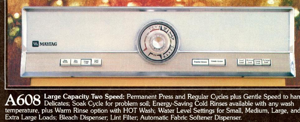

The A606 & A608 would be the same as the A206/A207/A208 WITH the addition of a brief "soak" cycle.
There were only two significant difference between the "06" & "08" series washers. They were: 1. All "08" machines got a non-timed bleach dispenser. 2. The 108, 208, 408 & 608 got an extra water temperature button which was "Hot/Cold". On the "06" machines a hot wash always got a warm rinse.

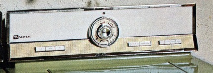

Here's the panel of an A606 |

thank you for them great pictures kenmore71!!!
the A608 would be the one that is exactly just like my A208, with the exact same features + the extra large load size. but i also do like the A606 because it has that little light above the center dial. i think i would like to see that little light lit up. but then again, it's not like i would be sitting in front of my washer while it was washing, just to see that little light on. so, maybe that little light wouldn't be such an important decision maker for me?? LOL..... thank you for answering my question, as to which model number would be the same as the A208 (but with the extra large load size). i am going to bookmark this message thread so that i will have that information for future reference. thank you so much!!! i have another question for you: now from what i'm understanding, do all the A806's have the lighted control panel?? that's what it seems like to me, but i could be wrong. but it seems like all the pictures i see of A806's, they all seem to have the lighted control panels. is this correct?? and are A806's the only model to offer the "suds saver" option? me personally, that isn't a feature that would catch my eye or attention. i don't think i would use that option, if i had it myself. i think i would be very happy with an A608! ;o) |

i am thinking maybe that the A608 is going to be the next machine for me. it is exactly what i am looking for & found in my GA208. with the A606 running close behind it. thanks to kenmore71 for clarifying the model numbers for me :o) thanks again goatfarmer for letting me know that all A806's have the lit up control panel. |
