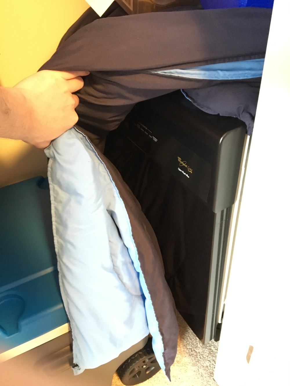

Post# 868234 , Reply# 15   2/21/2016 at 19:21 (2,985 days old) by murando531 (Augusta, Georgia - US)   |   | |
2
Post# 868239 , Reply# 16   2/21/2016 at 19:58 (2,985 days old) by Murando531 (Augusta, Georgia - US)   |   | |
2
Success. Having a busy past couple of days left not very dirty dishes, but there were plates with marinara and ranch dip from pizza with friends and bowls from cereal and oatmeal that all sat for a couple of days, and mostly just glasses and cups because we drink water like crazy around here. But anyway, since we're out right now and the video only just published, here's the link to a new, fully loaded with dishes, dishwasher video. :)
This one is continuous, from the point of hitting Start until the cam sent a notification to my phone that it reached 15% battery (Wifi streaming to the phone drains it very quickly but I had to keep an eye on it to make sure it didn't fall). I took it out after a good bit into the main wash, because it had already started heating the water (yes, the main wash is heated without selecting any options, and gets hot enough to billow steam out the door when opened midway through, so I'm not sure where people get the idea that Whirlpool uses lukewarm wash water. I mean seriously...). This gives a good view of the pre washes as well, and certainly debunks the theory that these new machines "spit" on the dishes, and that the pumps constantly start and stop. This post was last edited 02/21/2016 at 21:05 |

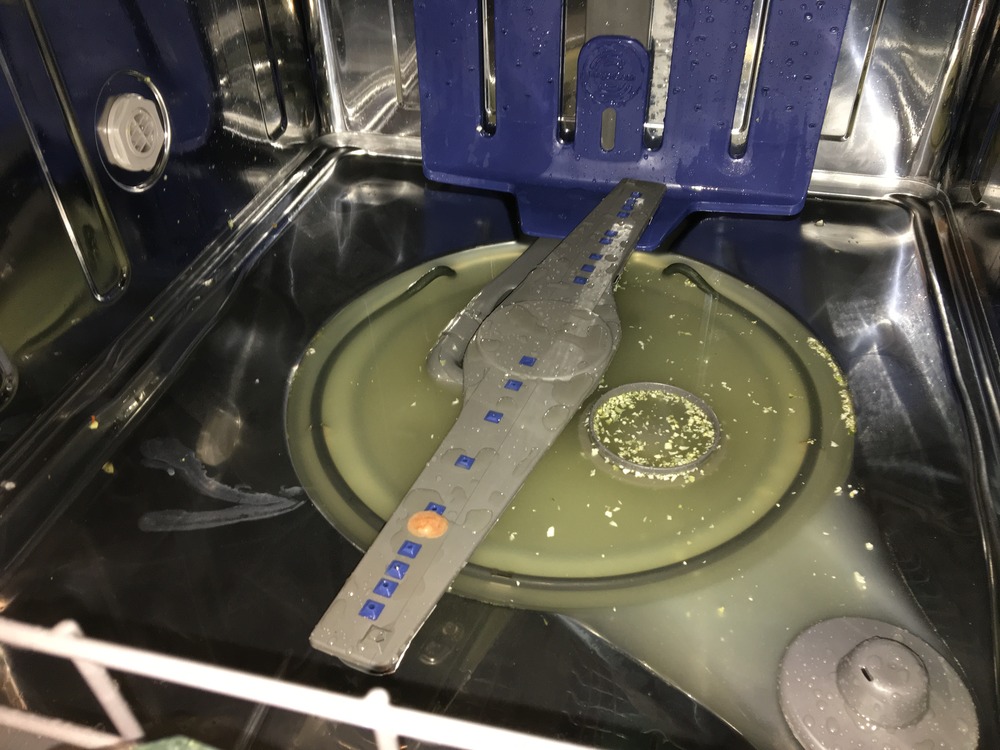

Post# 868479 , Reply# 27   2/22/2016 at 23:10 (2,984 days old) by murando531 (Augusta, Georgia - US)   |   | |
3
Alright, big test time. I did as henene4 said, and sprinkled sugar and cheese, and smeared pasta sauce in a glass baking pan and baked at 425 until it was nicely scorched. No Pam here. Along with that, I whipped up a packet of the nasty pumpkin spice instant oatmeal that no one has touched since Autumn, and microwaved it until well done and allowed it to sit and dry. Along with that, I'm throwing in the casserole dish from potatoes au gratin with a little scorching around the edges, a mixing bowl with bits of garlic and broccoli and spices still stuck, and all the large utensils and items I normally would have washed by hand because they take up large amounts of space.
Just for sport, I took the filter cup and plate out, and despite having nothing to clean off, I scrubbed them with hot water and soap to make sure they're spotless before running a load of nasties like this. I think for this run, I'll use the Heavy cycle, for the first time since owning this machine..lol, and also because it's only fair for this much soil. Perhaps if I try it again I'll angle it towards the TargetClean jets and see how using that option improves at all. I DO NOT expect this baking dish to come out spotless or even close, and even if it's still filthy, it doesn't change the fact that this machine is an exceptional dishwasher and cleans beautifully with reasonable soils. I honestly wouldn't expect it to come clean even in the PowerClean at max settings, simply because the cycle time isn't long enough for the detergent to perform properly. If it does do well, however...I may just take out some insane insurance on the thing because I'll want to keep the thing as long as I live, not that I don't already feel that way now...haha. |

Post# 868620 , Reply# 35   2/23/2016 at 16:36 (2,983 days old) by murando531 (Augusta, Georgia - US)   |   | |
3
Despite the chunk of oatmeal, there is amazingly nothing really in the filter cup besides speckles here and there. The water has a bit of a cloudy look but the camera makes it look much murkier than it actually is. It's almost positively just rinse aid residue. Even the PowerClean and Voyager had a whitish tinge to their residual water sometimes. I was at least expecting pieces of burnt cheese or something to be stuck, but alas, none at all. The drain port and pump impeller are evidently very well set up for handling heavy quantities of soil caught in the filter cup.

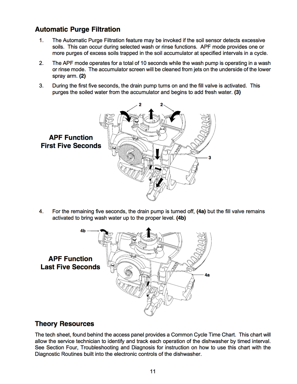

Post# 869891 , Reply# 50   3/1/2016 at 01:14 (2,977 days old) by Murando531 (Augusta, Georgia - US)   |   | |
I'm glad you mentioned the low-energy after wash rinse. Mine behaved totally different than it usually does the other night; it was a load of not horribly dirty dishes since most was just veggie juice residue and such, but a few plates had spaghetti sauce plastered on. Used Normal as usual with no options, but instead of the usual 2-3 prewashes with purges between, it opened the detergent cup a few minutes in, no drains at all. What struck me odd about it was that I've had less-soiled loads than that - that ended up getting prewashes, which I thought was unnecessary. I was pleased really, because I always loved that the PowerCleans jump straight into the wash on Normal, so the detergent gets a full workout. I'm not sure why it decided only now to do a low water cycle.
Anyway, the first rinse was like you described, it wasn't a purge, because it filled with more water than the normal 5 seconds or so, but it also wasn't a full water charge. The pump would kick on for 20-30 seconds, and had a few seconds of good spray before hearing the pump start cavitating, but it seemed like it was on purpose. It would run for that little period and then sit for 30 seconds, and repeat. It's the first time I've ever noticed it do that. Almost like it was intended as a filter purge that also had a little wash action thrown in. After that, it filled and finished out normally with the long final rinse. The cycle was a PowerClean Normal cycle exactly; Main Wash - Purge - Final Rinse. I can't imagine it used any more than 3 gallons, if that, but as always everything came out squeaky clean with not a speck in the filter. I'm wondering if that super baked on heavy mega test load forced the sensor to recalibrate, and after that carnage, it decided this load was a walk in the park, haha. |

Oh okay!!! I gotcha. Yes, the Maytag you and I have right now IS a true Point Voyager design, the very last year they made in Maytag and KitchenAid machines. The new design, the current ones that launched in the middle of 2014, are the "modified" resource saver machines, which have the new sump assembly design. The "better energy management" part was that in your machine, what allowed them to continue using the Voyager design but meet the tightening efficiency regulations for a smidge longer was that they programmed it to be much more water conscious. That's why these versions of the Voyager were much more aggressive with Automatic Purge Filtrations**, doing its best to avoid having to drain the prewash water and instead progress directly into the main wash. That's why with extra heavily soiled loads, mine would do three APF's before finally deciding the water was too dirty, and draining completely to refill for the main wash. Otherwise with moderately dirty loads, it would do one, maybe two, APF's and then drop the detergent, essentially saving water by only draining away the soil caught in the filter. In older designs, like my granddad's KM Elite Voyager, only one APF will be done, if at all, before it just dumps the prewash water completely.
**I was going to try explaining it, but luckily I had saved the PDF from the technical education manual I found and can no longer pull up online. |
Post# 870870 , Reply# 77   3/6/2016 at 16:03 (2,971 days old) by mark_wpduet (Lexington KY)   |   | |
to mine while it's running usually. I usually choose autoclean with hi temp/ tough scrub.....but I stopped choosing the modifiers and just started using autoclean alone since you guys said that autoclean will enable those options if it thinks it needs to...I timed it and it took 98 minutes to complete (no heat dry) using just autoclean with no options on a moderately soiled packed load. I do not consider that excessive as far as time to wash a load of dishes.
But this leads me to another question and I think I may already know the answer. With the jetclean steam cycle on my dishwasher, I think it uses 12.8 gallons of water...I was told on the new models the powerblast cycle is the same as my jetclean steam cycle. I'm wondering if a user chooses that cycle on the new models, if it uses that massive amount of water that mine does (for today's standards). I'm thinking it doesn't since these were redesigned to be more efficient. |
Post# 870895 , Reply# 79   3/6/2016 at 20:08 (2,971 days old) by appnut (TX)   |   | |
Why can't the accumulator screen be something a user can clean once a month or so?
Jerrod, it's called a manual clean filter. NO THANK YOU!! I hate them. it's a European design. I am thankful my old Kenmore Elite lasted long enough until a self-cleaning filter technology came out. I dread having to get down on the floor and pull out a stupid cartridge. clean it and put it back in place, hopefully properly. My current new dishwasher only stops once during the prewash to check to see if it needs to drain prewash water or not. And only once has it not drained prewash water in the almost 5 months I've had it. It doesn't purge and clean the filter like what is described above. I don't know how it does it, but it does. So far, I'm very pleased with cleaning and food soil disposing. |

Grody prewash water!!!! I've only opened it once or twice during an actual full load of dishes, so I was curious to see just how murky the water would be after a few minutes from the cycle start with a full and heavily soiled load. Nasty. That floating stuff is "cauliflower couscous" left in the processor container and on some of the plates. It still amazes me how little water it uses per fill, compared to the Voyager, since they use the same tub design. The Voyager water level would be up to the edge of the door.
