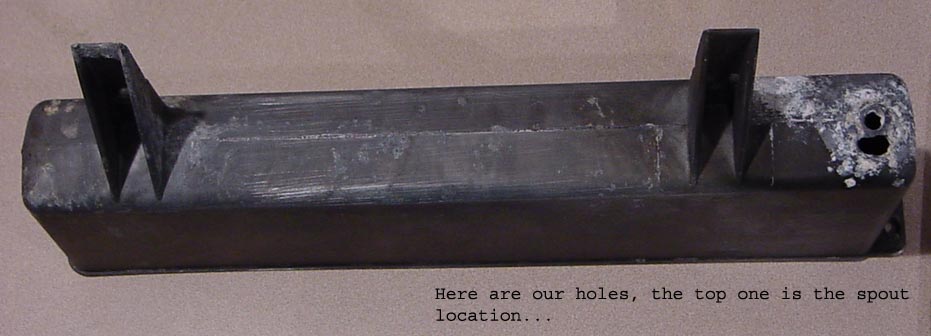

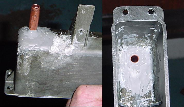

I did a little more putzing tonight and removed the fabric softener dispenser well for cleaning. During my work earlier, I discovered the hose from the softener well to the sump (that's #1 Brent) was broken off the well. Thinking it was a plastic well (a long narrow box directly under the door opening) I pulled it out and found a cast pot-metal box, completely full of dried softener. I cleaned it completely and retrieved the rubber stopper from the bottom of the box. For those of you familiar with the dispensers on higher-end Kenmore or Whirlpool, this a very similar design with a solenoid and plunger, the stopper or plunger is pulled up by the solenoid in the final rinse, releasing the contents of the container into the outer tub. Unfortunately, the spout of the well is completely dissolved away leaving nothing to attach a new hose to and there is also a hole eaten through the metal very near the original spout location. I'll have to give the problem some more pondering and see if I can come up with a solution to make this work again, filling the "extra" hole is no big deal, JB Weld to the rescue, but I'm wondering how to get a new spout attached. I wouldn't want the judges to take off points for lacking dispensers! I haven't yet looked at the bleach dispenser (hose to sump #2) but it appears to be OK so far. (box/well is pictured with the bottom side facing up) Brent - see if you can guess what the other two hoses in the sump are are for... ;-) |

Hi Brent- This piece is metal, I'm sure it could be re-created but I wonder what the cost would be... There is no flush with clean water, that probably would have saved the dispenser from it's current condition but it's simply a holding tank for the softener until it's released in the final rinse cycle. The whole tank was nearly full to the top with dried, caked on softener. It was pretty gross looking, but I think she only used Downy so it did have a nice vintage smell! Pretty close on the hoses to & from the sump - bleach, softener, drain to pump hose and the air dome (water level control) hose are all attached to the bottom of the drum. WP/KM was the only one with a recirculating spray system. I'm surprised it's not completely rusted away but it doesn't look like this machine was used as a washer for all that long. I was told that the user/owner of this combo had another washer in the basement (probably a wringer) so that explains the low washer-use and more use as a dryer. |

Greg, why not try this? www.muggyweld.com/potmetal.html... I've had good luck brazing regular metals in the past with a store-bought propane/oxy torch, never tried pot metal before though. Cory |

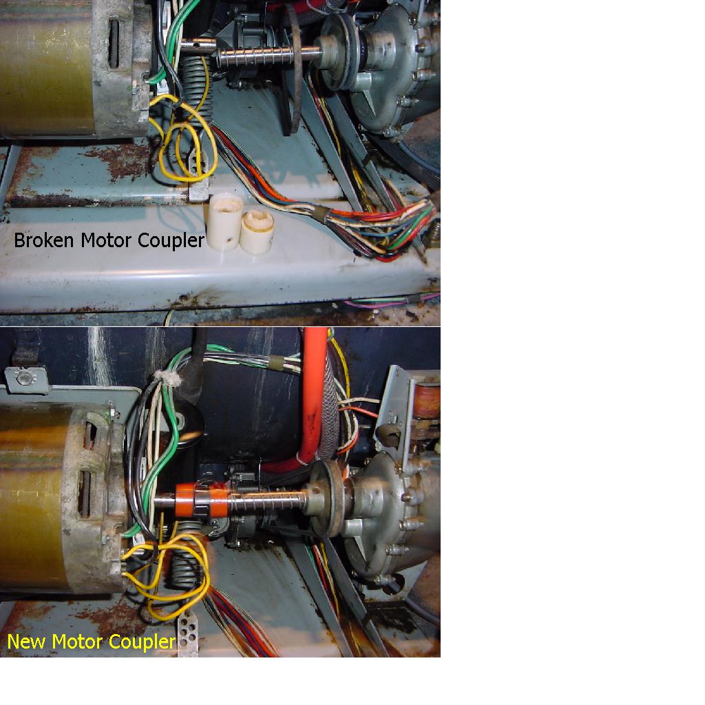

I've been plugging away at the combo as time allowed all week and we're very, very close to being ready to celebrate! I ran it through a couple of water tests this week and it passed with flying colors, however, when I filled the drum 1/2 full of clean rags (approx. 8lb load) we had tragic results... About halfway through the cycle, the drum stopped turning, the pump stopped pumping and I could only hear the motor spinning quietly along. Fearing the worst, of course, I started to inspect the tranny, drum belt, etc. trying to locate the problem. The problem was a coupling, similar to the principle applied in a DD Whirlpool/Kenmore washer. The motor is connected to the transmission shaft via a coupler made of a soft plastic sleeve in between a harder, plastic sheath that is split at the point where the two shafts meet. The purpose of this is to isolate the motor from the mechanical workings of the machine protecting the motor from a jammed drum or faulty transmission that would cause the motor to stall and overload. With just water in the machine, there wasn't enough load on this coupler to cause a problem, but when I added the load of rags, the inner soft plastic started to crumble and eventually broke in two. I believe this was caused by simple age degeneration. I went to my local supplier to see if I could replace the coupler, which interestingly enough was much different on my machine than was pictured in the service manual - probably a replacement during it's years in service. They didn't have an exact match for the part, but we came up with a solution that seems to work just fine. Here are a couple of pics so you can see the old broken coupler and the new one installed on the shaft(s). After this latest repair, I ran it through it's first full cycle without a hitch - and what a show it was!! I'll follow up with few more pics so you can see (a little through the tiny window) it running through it's paces. I'm still waiting on the blower-fan belt I ordered, it should be here on Monday or Tuesday. Hopefully that will fit and we'll be washing and drying - for now, I'm happy with the washing - we're almost there! |

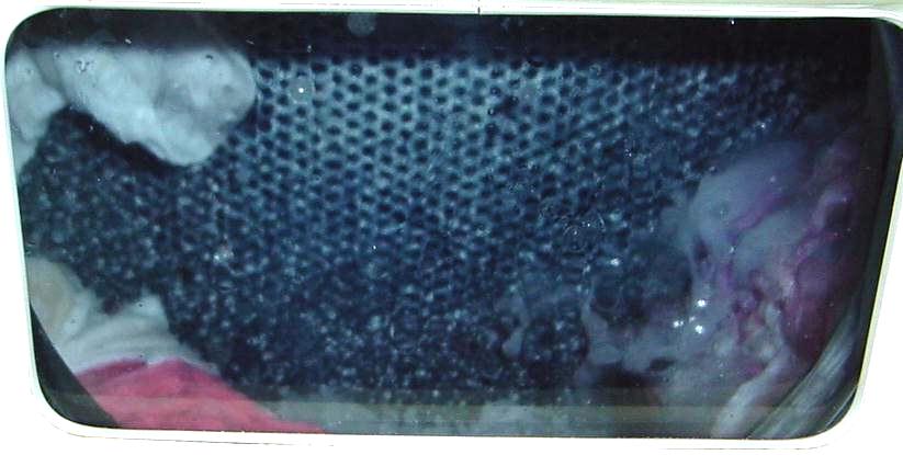

Not much of a show through the window unless you peer around the edges of the drum. The clothes tend to ride the drum at 52 rpm, counter-clockwise until they reach about 11 or 12 o'clock when they crash to the bottom of the tub at about the 7 o'clock position where they are swooped up by the drum, through the pool of water sloshing around at the bottom of the drum and start the process all over again. It's very fun to watch and even more fun to hear all the water and clothes crashing together inside the drum.

The combo is going very well actually, the last couple of weeks have been very busy and I've not had time to complete all the details. I did find a belt for the blower assembly, I ordered a 2L-320 (1/4" wide by 32" long) but it was too short and would have run much too tightly. I tried stretching it which did help but finally found a 2L-325 (32 1/2" long) belt that actually was intended for a Frigidaire Skinny-Mini which seems to work perfectly. I'm still not happy with the way the new motor-to-tranny coupler works, there's a little more vibration that I'd like, but I have an idea I'm going to try tomorrow so hopefully that will be the last hurdle to hassle-free laundry days! I will take some pictures of the suspension system tomorrow so you can see how it dampens off-balance loads and protects the machine from tearing itself apart. |

I am still working on the Maytag - the coupler I tried today worked perfectly for half a cycle so we're back to the hardware store to try again with some stronger materials and a little different application so I'll update again tomorrow. Each step is a learning process but we're very, very close now. While it was running ;-) it was most quiet I've ever heard it! Keep your fingers crossed... |
