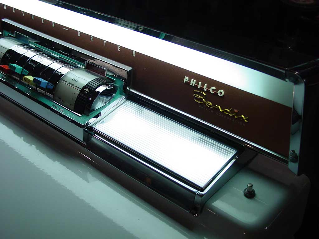

Hi All: Just annoucing another Bendix Duomatic goes back to work! Thanks go to GregM for helping me lug 405 pound BerthaBendix back from Syracuse in October. Thanks go to John Eichinger for his help,advice,copies of Doctrine and several crucial parts without which Bertha would not be running right now! Thanks to MODERN! And Larry for sage advice! Very sage advice! It runs sooo much better than what I expected and sooo much better than my GE Combo. Bendix really got it right the first time! And they were the first from what the patents say. And YES JOHN LEFEVER it runs sooo much better than a Whirlpool Combo--especially my WP Combo!! Wait till you see the floppy wash, the gleaming chrome!!! It was a struggle everynite but I gave up house maintenance and snowblower maintenance and mailing Christmas cards to find myself in the basement after dinner and all weekend long. Below is a listing of what it takes to bring a "first floor machine" back to working order. Just think what it takes to bring a Farm Machine back to working order! Congratulations John Eichinger! She was tired! - A new Power Cord - A new tub pulley the old one was split in two -Thanks John E. -A new top panel as the old one blew off in the truck between here and Syracuse-Thanks to John E. -A 220V short to the cabinet, heater elements had to be removed and run hot at 110V to dry them out-Thanks to Larry! -Clean out a huge mouse nest and skeletons and did I mention the droppings througout the machine -Find 3 110V shorts due to mice chewing on odd parts of the wiring harness -After first water test found pump valve stuck closed had to be freed up carefully as the seal is 50 year old rubber -Repair leak around coin trap by descaling and installing a "new" coin trap - thanks to Larry! -Water valve had inoperative sections and after 3 days of not being there I found a very wet basement due to a very very slow leak. Calcium deposits all inside valve body were too blame -Rub down inside and outside of all boots with Glycerin to bring rubber back to healthy flexibility!!! -Spray outside of all boots with silicone- nicw tip from John E. -New drain hose which on a Bendix is an oddball size -Found dryer timer frozen , installed a Maytag dryer timer only to find out that it ran backwards! After much cleaning, working by hand and lubing I was able to get the original motor up and running again. Thank gawd for Lubit-8! -First wash the Cabinet filled up with water! Found that when moving the machine the tub had bumped the air gap on the fill line and so the line was spraying down the whole back of the cabinet! -First dry cycle the blower motor whipped its rubber cooling fan off and flung it across the basement in a fit! I replaced it with a solid aluminum fan blade from Grainger the is BOLTED to the motor shaft now. -Polish all chrome and enamel with Simichrome to get some bizarre crud off all the top surfaces. - The hardest thing to clean off was the "30 year old" Whisk which had been spilt and seeped down in between the top and cabinet. That stuff is like Super Glue! CLICK HERE TO GO TO Jetcone's LINK |

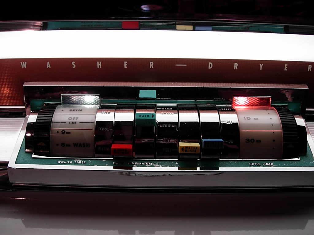

Jon, Congrats are way big time in order. I know pretty much the thumb-wheel controling/setting of the two timers and being typical bendix sequences. But, please tell me what the red, green, yellow and blue aircraft slide controls are for and what each of those settings are for each color. I believe John LF had one of these at the 2002 convention, but it hadn't been restored and I couldn't read all the markings anywhere ont he panel. Thanks. Bob

Jon, You have really been working hard! It really paid off! Did you by chance take before and after photo's? It is beautiful! I bet you are having fun washing! Brent |
Post# 52087 , Reply# 9   12/31/2004 at 08:45 (7,049 days old) by Jetcone (Schenectady-Home of Calrods,Monitor Tops,Toroid Transformers)   |   | |
Bob Appnut I have put the picx on our club website so they will show larger and I will get you the button layout as well! Cheers Jetcone CLICK HERE TO GO TO Jetcone's LINK |
Post# 52088 , Reply# 10   12/31/2004 at 08:51 (7,049 days old) by Jetcone (Schenectady-Home of Calrods,Monitor Tops,Toroid Transformers)   |   | |
Yes the smell of Fresh Tranny Fluid now fills the basement- I think I heard Bertha Burp!! It is alot of fun to share and Robert & Terry are right; after all the hard work it is very enjoyable to sit back with a Vita Mix and let her tumble! Today's smoothie - Mango Chunks, Strawberries, Vanilla Yoghurt and Black Raspberry Juice YUMMM!!!! |
Post# 52089 , Reply# 11   12/31/2004 at 09:04 (7,049 days old) by Jetcone (Schenectady-Home of Calrods,Monitor Tops,Toroid Transformers)   |   | |
Hey Bob here is the control layout. The water valve has 4 solenoids on it! So there is a choice of many temperatures on the CE-788 model. Far left Red button is the soak cycle temperature switch. Choices are from the top: Cold-Cool-Warm Next button is Turquoise and is the Wash Temperature switch. Choices are from top: Warm-Medium-Hot On Hot the Magic Heater is engaged to keep the wash water hot all through the wash cycle. Next button is Yellow and is the water level selector. Choices from top are: Small-Medium-Full. A FULL load is "2/3 of the cylinder"! Next and farthest right button is Royal Blue and is the machine control switch. Choices are from the top: Reset (to reset an overloaded motor-yes that has happend already!) - On - Off. So you set all your cycle parameters and load the clothes and liquid Gain and close the door then you reach up and push the Royal Blue button up to ON and walk away! (NOT!) This machine was origianlly installed on 2/20/58! By Syracuse Automatic Service at 817 Butternut Phone:GR4-6061. jet |
