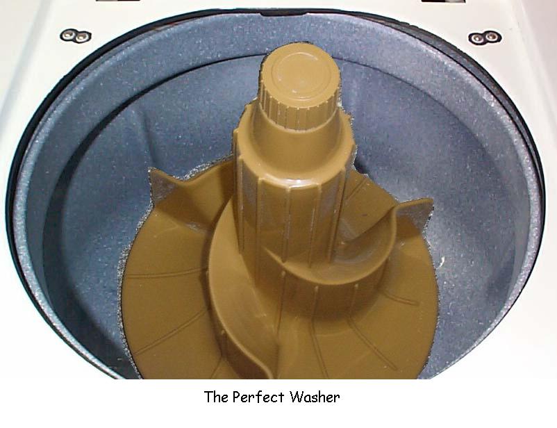

Here is a link to another archived thread full of Kenmore agitator pictures. This one has most, if not all of the agitator types that have been featured in Kenmores over the years. Quite fun to look at. Have a good one, James CLICK HERE TO GO TO 70series's LINK |

Post# 288566 , Reply# 5   7/4/2008 at 04:33 (5,774 days old) by kenmoreguy64 (Charlotte, NC)   |   | |
I'm trying to think when the last Lady K was made that had a Roto-Swirl. I'm wondering if it was 1964? I know the 65s and 66s had the Roto-Flex, and I know by 1970 or so they'd gone to the Vari-Flex. I don't think I've seen a '67 to '69 Lady, so I don't know about those models. I do know that the last Standard Capacity Lady was the '72 model with Vari-Flex and that there wasn't specifically a '73 model, as the '72 continued until '74 when the large capacity model debuted with the Penta-Swirl. There wasn't a specific '75 model either (they just kept selling the '74) and the '76 was the new black panel model with the Dual Action just as James said. So, thinking about it, there may not have been a Roto-Swirl Lady since the mid-60s and there was only one Penta-Swirl Lady. Both surprise me a bit. James' facts are right on...the Penta-Swirl continued in MOL 60 and 70-series machines until the end of the 1980 models. When the tubs and baskets were redesigned in 1981, the line was simplified to Penta Vanes and Dual Actions in the large machines. The last Roto-Swirls for home use were the 1980 models too, as these were the last home-use 29-inch standard tub models for Kenmore in belt drive form, though there were some 24-inch for a couple years longer. They went direct drive after that. Kenmore retained the standard tub and Roto-Swirl into the later 80s for coin-op machines, and Whirlpool had standard belt-drives across the board until the end of the line, though they weren't common sellers. Interesting question Jeff, thanks! |

Post# 288947 , Reply# 11   7/6/2008 at 09:31 (5,771 days old) by kenmoreguy64 (Charlotte, NC)   |   | |
