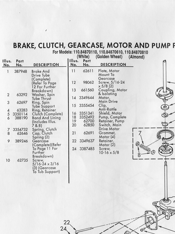

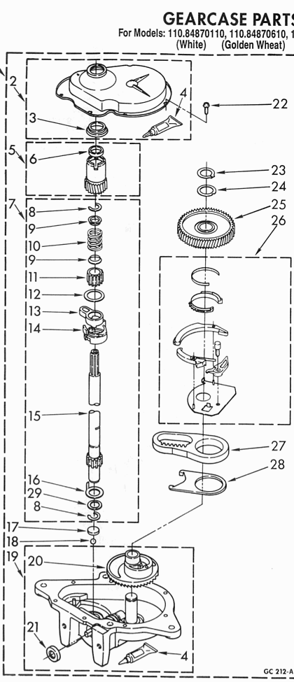

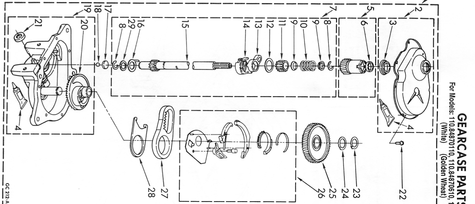

sorry I have been working for like 2 hours loading software and figuring out how to use a scanner. I have moved boldly into the 21st century. oh yah |
Post# 46100 , Reply# 8   12/31/2069 at 18:00 (19,838 days old) by fixerman ()   |   | |
Sorry, I must have posted while you were uploading your images. Your Images do show the parts you need. |
Post# 46101 , Reply# 9   12/31/2069 at 18:00 (19,838 days old) by fixerman ()   |   | |
It would be no. 26 on your diagram. Maybe someone else can confirm this too. |
Post# 46102 , Reply# 10   12/31/2069 at 18:00 (19,838 days old) by fixerman ()   |   | |
You might also replace the seals while you are at it. They frequenty leak oil. They would be no's 3, 6, and 21 on your image. |
