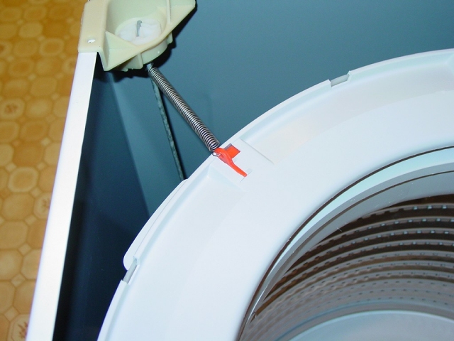

I just took my F&P 5kg TL washer out of storage and hooked it up and did a load in it. Works perfectly except that during agitation in wash and rinse cycle it bangs rhythmically. Looks like the outer tub is moving back and forth too much. All the suspension rods are in place and I can't see why it would be doing this. Anyone have any ideas I would be really greatful

Thanks DADoES,
Suggestion really appreciated, however just worked out what the problem was, I very stupidly had not removed the transit restraint under the tub. I have no recollection of putting it back when I put the machine in to storage over 4 years ago. Since removing it, it works like a dream, so whisper quiet. |

I'm sorry,but going by this pic & others I've seen of F&P's,they are VERY cheaply made for what you pay.IMO. Can't bring myself to spend the money on one,even though the agitator style KM branded intrigued me for awhile. |

I have 2 F&P TL washers. Compared to the more robust models from the US they do appear to be cheaply made. They are not very heavy at all and the suspension looks frail. Having said that both machines work very well and handle big full loads really well. Compared to my Maytag Atlantis they are years ahead as far as technology goes, I am very impressed with them and would always recommend F&P washers
