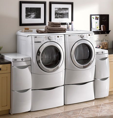

hello to all aw washer members,
i would like to know what is the diffrence between the maytag performance series and the maximan series Please because i am thinking for my next daily drivers to go with the maytag front load series in the 9000 series or the maxima serie thank you very much for all of the info |

The difference between the two top of the line models in each series is negligible. Both pretty much have the same features, but the Maxima is about an inch or 1.5 inches shallower than the performance series, the maxima is made at Whirlpools factory in Ohio where as the Performance series was produced in germany; the maxima has a 5.0 cu. ft. tub vs. 4.5 cu ft. for the performance series and the maxima new direct drive technology. the Maxima also has a tub light asw ell as the latest styling comparable to other brands on the market as we as the same with the control layout and displays. I imagine the performance series will be phased out soon.
