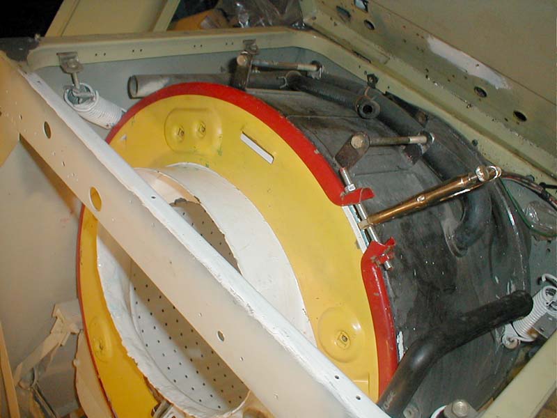

Well first question is, is this a model with a removable tub front plate or is it a sealed 50/50 split tub, if it’s a 50/50 you can not replace the bearings as it is impossible to part the halves.
Photo of a WM63 with the tub front plate removed. Also a Link to a web site that may be of use and will make clear how the front of the tub can be removed if it has one. Lee CLICK HERE TO GO TO hotpoint95622's LINK |

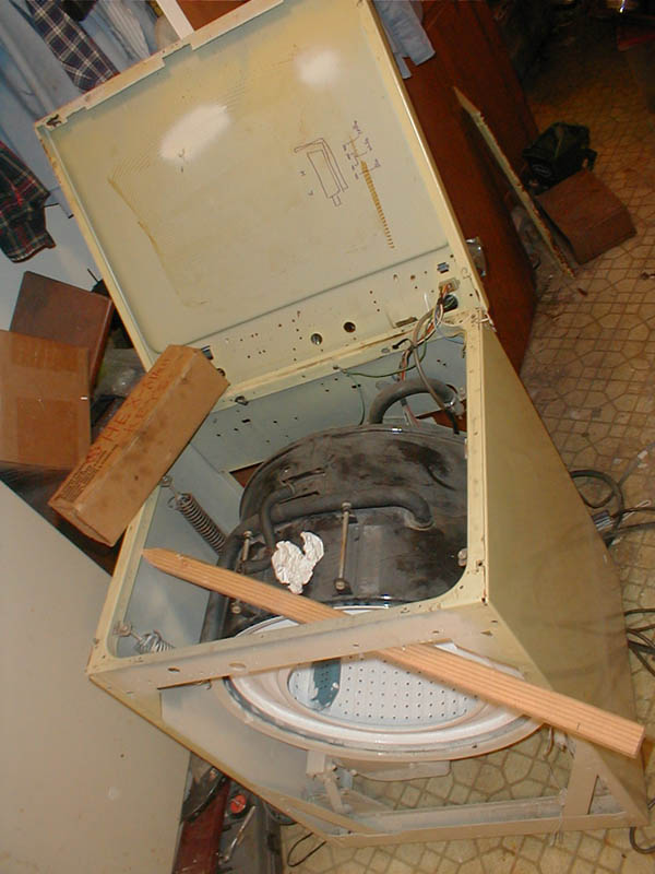

Post# 489860 , Reply# 4   1/18/2011 at 13:35 (4,845 days old) by 3beltwesty ()   |   | |
The proper way is to have the washer vertical. I just do it via pushing down some; so the basket clears the washers frame CLICK HERE TO GO TO 3beltwesty's LINK |

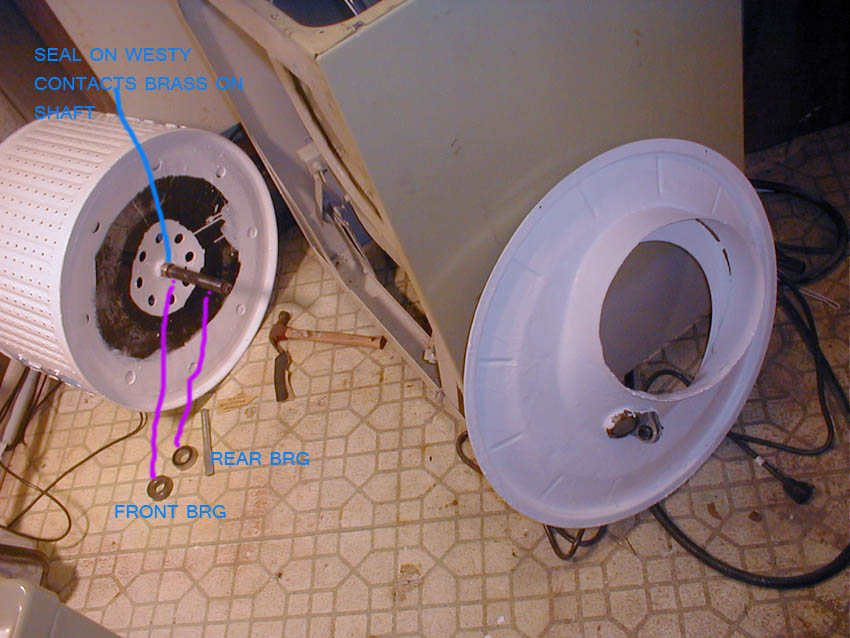

Post# 489905 , Reply# 8   1/18/2011 at 17:33 (4,845 days old) by 3beltwesty ()   |   | |
Spider shaft bearings and seal kit CLICK HERE TO GO TO 3beltwesty's LINK |

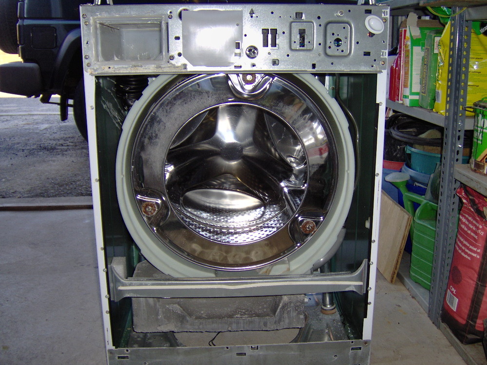

Post# 490295 , Reply# 12   1/20/2011 at 03:20 (4,843 days old) by azimuth ()   |   | |

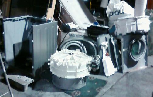

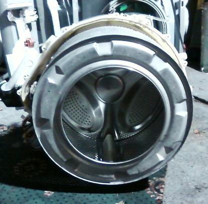

Few balls missing & a lot of corrosion... You can see the shaft has been sunk by about 1/4" |
Post# 490297 , Reply# 13   1/20/2011 at 03:23 (4,843 days old) by azimuth ()   |   | |
Hotpont WT761 - front view of reartub & basket, removed form machine. |
Post# 490372 , Reply# 14   1/20/2011 at 13:23 (4,843 days old) by hotpoint95622 (Powys)   |   | |

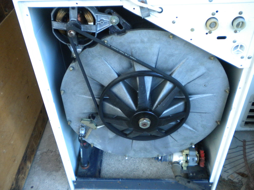

Massive job, me thinks that’s a bit of an underestimate, wow.
So much for new modern design, the very old Hotpoint’s like my Liberator 1851/03 from 1975 are easy, just remove twelve bolts from the back plate, pull from the tub and bobs your uncle, like wise with the later 18 series from late 70’s to early 80’s then to the 95 series from early 80’s to the 90’s with plastic tubs which have the front plate, just remove twelve spring clips, more tricky but still a lot easer than your WT761. It's all to make you buy a new machine!! Photo of the 1851/03 |
