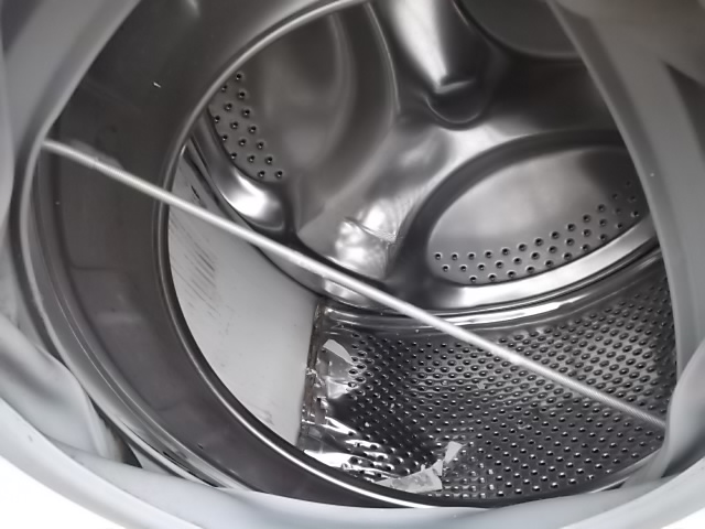

While Candy say it’s caused by a manufacturing fault, I wonder if the welded drum seam is weakening with age? CLICK HERE TO GO TO solsburian's LINK |

The first might be Candy, might not... 3rd and 4th are 100% Hoover black, but 2ND PICTURE is INDESIT DRUM! This is the picture that "UK whitegoods" tell is CANDY drum... |

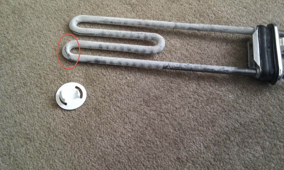

Post# 502633 , Reply# 133   3/9/2011 at 04:56 (4,796 days old) by solsburian (SE Northumberland)   |   | |
I've filmed another video of the rattles during the spin, its picked them up much better this time! CLICK HERE TO GO TO solsburian's LINK |
Post# 502667 , Reply# 134   3/9/2011 at 07:55 (4,796 days old) by solsburian (SE Northumberland)   |   | |
I've taken a photo of the heater element and the damaged transit bolt hole cover. I've marked out where the drum was rubbing against the element. |
